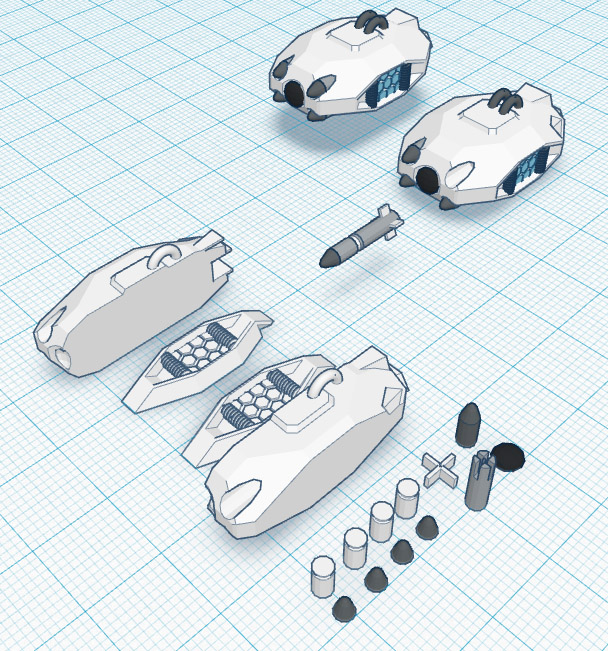

Here's the model design I came up with. Just good old TinkerCad which is where I typically draft my stuff before moving it into Blender.
Here is how I split up the model. I didn't do a good job with rear exhaust and had to use my ABS putty to fix it and sand it down. You can't tell though!

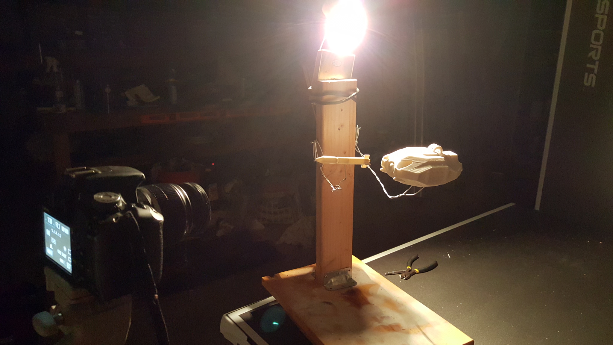

Two pieces of wood and two hapless coat hangers later, a ladder, and a light, and I'm ready to test out the mechanics of the scene I have in my head (missile coming slightly at you, angled tilt, planet horizon in the background).

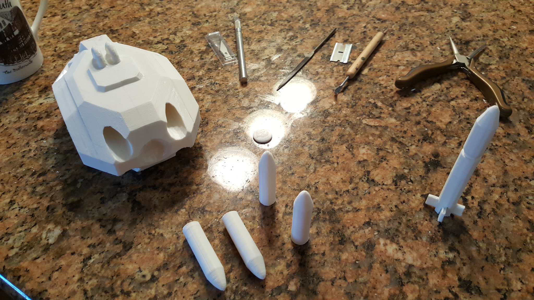

Here it is printed and ready to paint. Sanding took forever, and each half took 18hrs to print at 0.12mm, plus the missles. I then literally poured Acetone on it several times before priming it. It was nice and smooth.

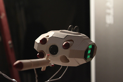

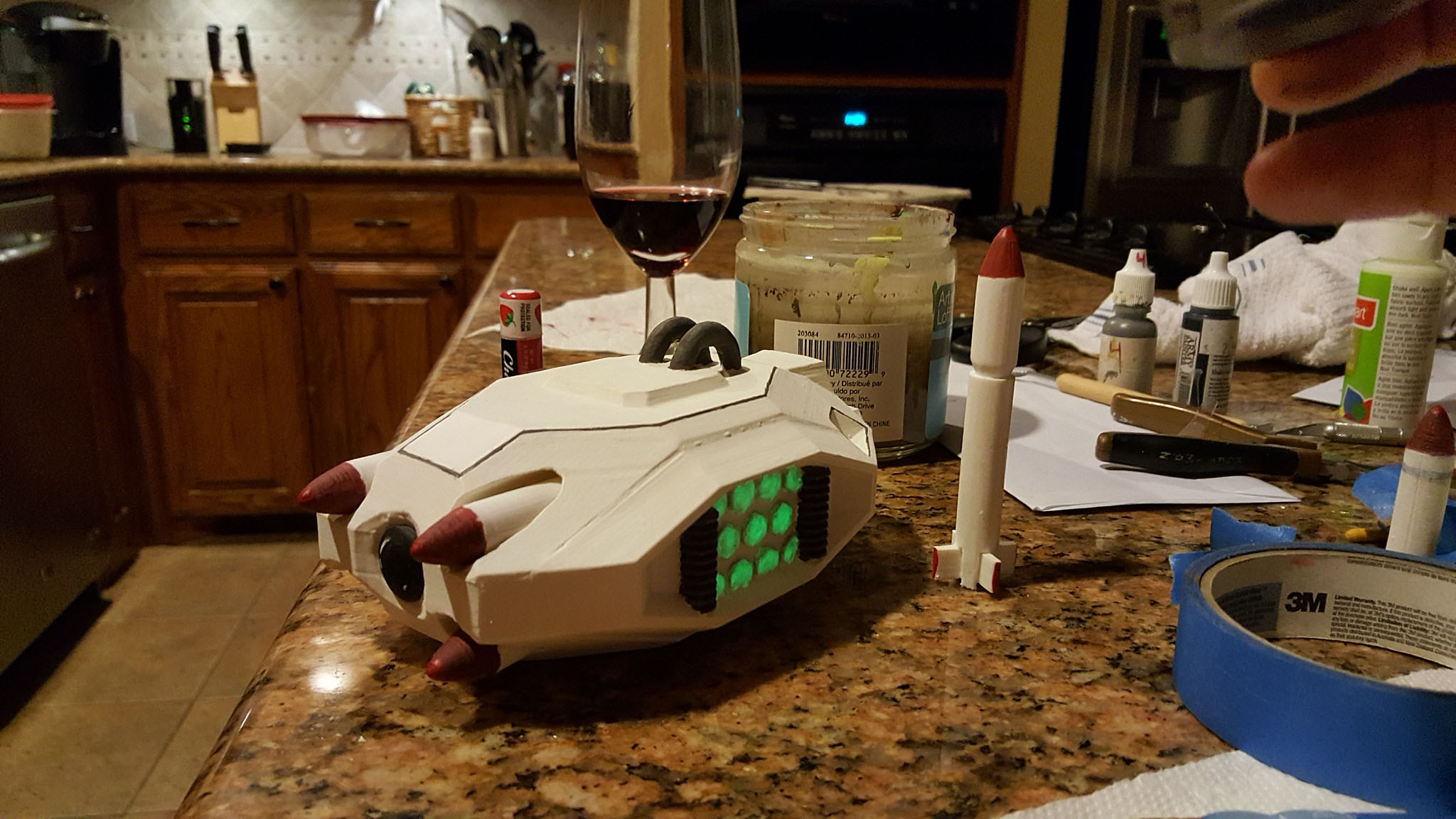

Painted and ready to go! The glow you see from the side is not LED's. It's several coats of $1.99 glow in the dark paint. I light it up really bright and snap the picture. Poor mans special effects! The thing is, I needed the correct inner lighting because that side was going to be shadow. You can't really do that with post editing so I wanted it illuminating the inner walls.
Model is setup in the "studio", (a.k.a sitting on my ping pong table in the garage)
Here is the large post-editing result. Keep in mind the end result is a 61x61 icon with a frame for our game, so I am seeing in my head how it should look when small, not necessarily when it's large.

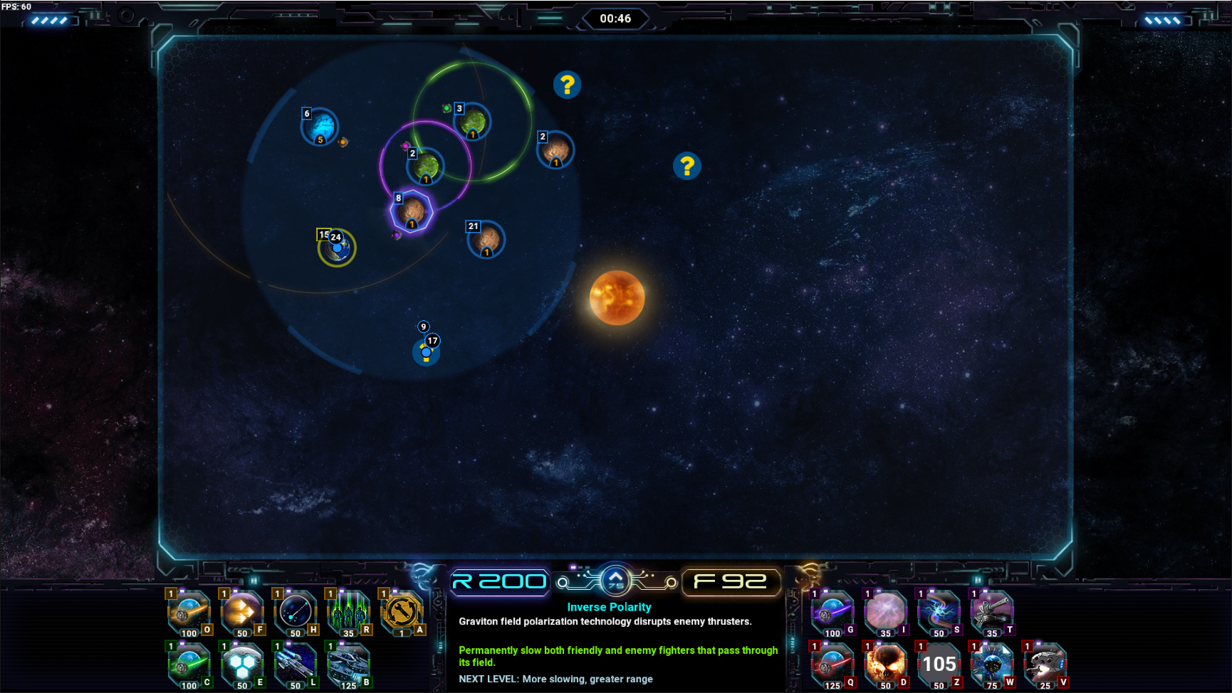

Here is a screen shot of our game Dominari. The new Stryker icon is at the bottom right!
