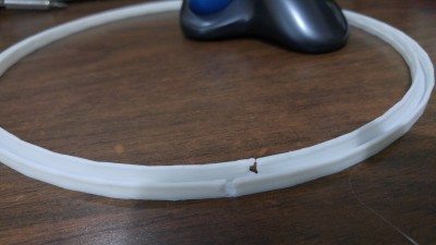

I have a RostockMAx V1, with updated V2 arms.  I am now using MatterControl to control the printer and as the slicer.  For the most part I like it better then Slicer.
It has been printing nearly flawlessly (it is 2 1/2 yrs old).  But, just recently I have had quality issues that I haven't been able to figure out what the cause is.   I have attached a photo.  [See Below]  The part is a simple channel ring.   The wall thickness is about 1.5mm   I am showing this just as example, it has similar fails on other parts also.  I have printed many of these in the past, same file, same settings, no problem.   But, recently there is this GAP.
The walls are cylinder -    so the printer prints rings to form the walls.  Where it starts and stops it is not 'connecting' and leaves a gap.
I have tried replacing the nozzle, that didn't work.  It doesn't seem to be the arms,   I don't see any abnormal play when the head moves.  I have tried slowing the print, that didn't help (but it has always printed at the same speed, no issue before).  I played with head temps,    nothing seems to change.
Like I said, I have printed many of these without issue before,  I don't see anything I've changed.  I am now using MatterControl and I don't see a setting that was there in Slicer.  In Slicer there was an option to Start Perimeters at Random locations, rather than at the same location each layer.   If there is a similar command in MatterControl I haven't found it.   BUT,  that would only be a band-aid fix, because it wouldn't be addressing what is causing this, since it never had this problem before.

I would look at your retraction settings.
						Re: Perimeter-Gap
Just for grins, print one sliced in Slic3r and see how it comes out.
Re: Perimeter-Gap
The retraction is 2.5mm, same as it always has been.
