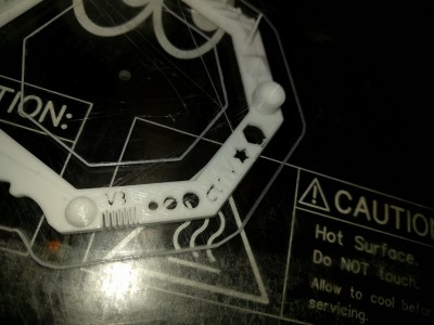

About to throw this thing out the window.
Post by Slaintemaith »
Been through updating our hotend, https://www.matterhackers.com/articles/ ... -to-oozing that website, a new version of MatterControl, AstroPrint, MULTIPLE support-chats, and several headaches. We STILL get prints that look like fig. 1 on the above link.
The article seems to suggest the Rostock Max v2 should be better than this. So I'm trying again from scratch. Sadly MatterControl settings don't look like they used to. Or at least aren't where they used to be.
Edit:
Attached is an image of what's going wrong.
WHERE THE HELL ARE THE ATTACHMENTS GOING?!??!?
Oh goody. Yet another frustration with this stupid thing.
Let's try this:
https://www.dropbox.com/s/gksjqnnxt2tz0 ... 5.jpg?dl=0
Thanks for your time.

Your issue may very well be in the geometry of the model and the way your slicer tries to handle slicing the model.
If you could post the STL/OBJ file, I could take a look at it.
My guess is that there might be free-floating objects within your STL, that as your slicer slices it, it requests that the printer attempt to put plastic in MID-AIR. This would cause little plastic loops which could cause the kind of weird blobs you're seeing, and would appear as stringing/retraction issues.
Another possibility is that you have scaled the model so small, that the slicer is unable to generate paths for parts of the model, and so creates blank gaps which then cause the plastic to be printed in midair when the file is thick enough for slicer to register it.
Try slicing your model in a different slicer, or send your model to me and I can try to generate a Gcode file for you.

mhackney:
It's supposed to be a test of the printer's capabilities. From the splooge everywhere on it, it seems ours sucks.
The places where it's making a mess don't appear to be places where it -should- be making messes. It handles the bridging and overhang better than I'd expect. It's the zitty splooge and stringing that's annoying me to no end, since no amount of playing with retraction/move speed/heat settings do anything appreciable.
A different slicer is the best idea I've heard so far, since MatterControl seems to suck. My experience with 3D printing has been limited to trying to get this stupid machine we built to work properly.

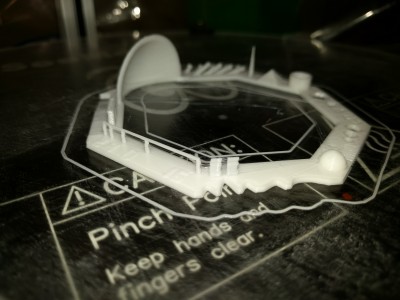

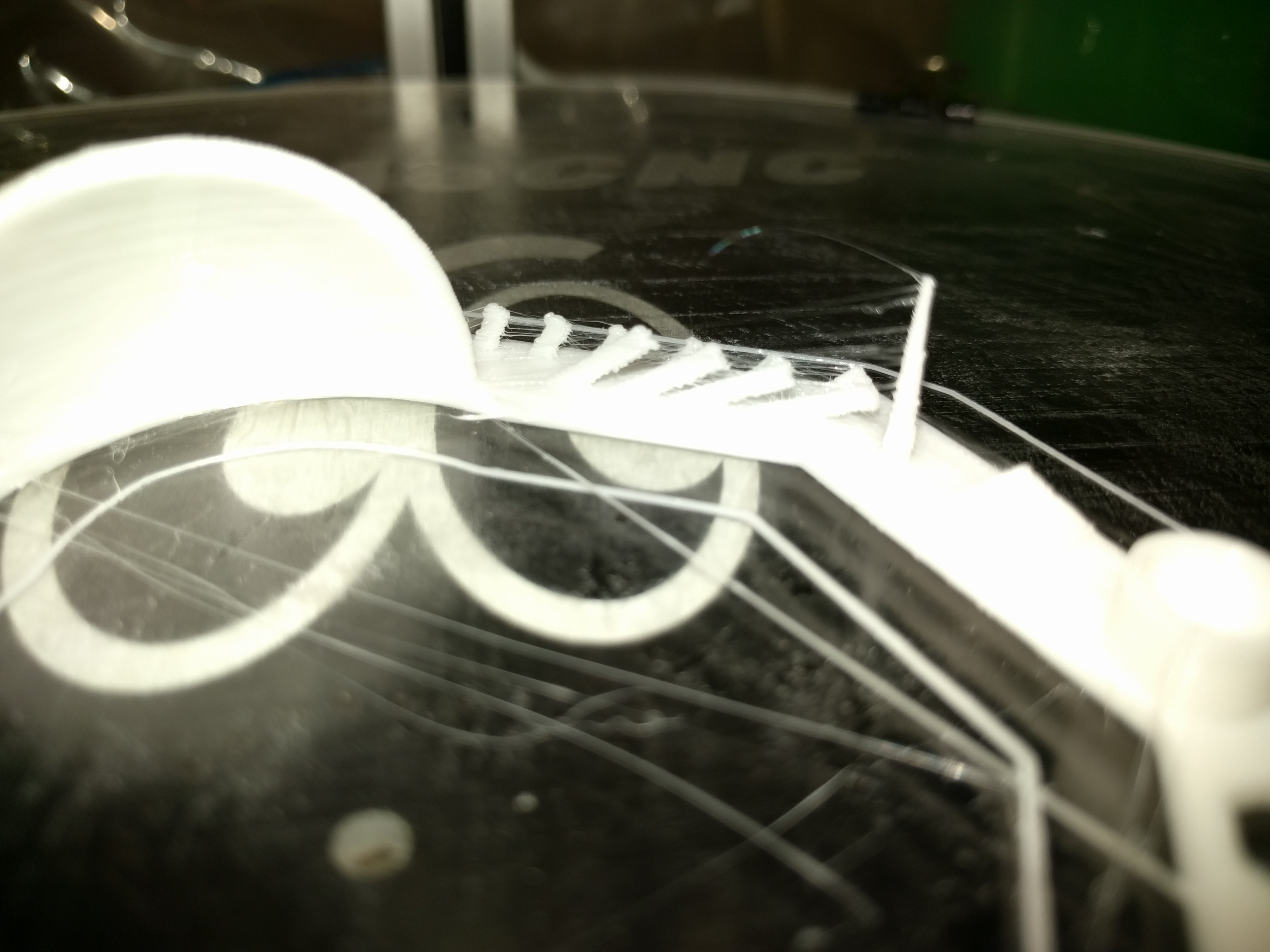

So, I'm going to go over the features I can see in that picture one at a time, and compare them against the STL.
Your bridging and overhangs are honestly great. It would be difficult to improve them, and the faceting in the STL comes through on the final model in the case of that rounded overhang. Very impressive. It means that at least for that, the temperature and cooling settings are well matched.
Next, the edge finish. Very glossy and consistent, perhaps a little too flat, suggesting temperatures may be too hot, or print speed is left too low, or that the low end fan speed is too low.
Top surface: It's hard to tell if the artifacts are voids or bumps from this angle. I would check your extruder steps calibration. It may be off, but it's pretty close if it is. Alternatively, considering the side finish, it may be that the track width setting in the slicer is too low/high. (low if bumps, high if voids).
The straight up pillars that print exhibit minimal artifacting, which is good. There is some wavering, and the lack of anything beyond the two widest indicate that the slicer is throwing those features away, possibly due to the track width setting, or because of something else.
The wall with a hole in it seems to indicate that things are printing pretty well, given the chance, and fairly consistently (within this print), if given about the same feature.
The diagonals that appeared in the bridging test, as well as the webbing on the leaning pillars suggest that the setting for minimum distance before retracting is too low, or that travel speed is too low. The pointed cone seems to agree with this.

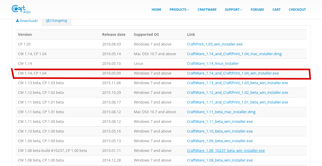

My particular suggestion, though many here do not have the same feelings, is for Craftware. It is much like a free version of S3D in my opinion (though I have never used S3D, so I do not know for certain. It does however allow for customizable supports).
I can post my slicer configuration for a .35, or .5mm nozzle configuration using SeeMeCNC's stock hotend if you wanted to give Craftware a shot, or you can try printing the attached Gcode generated from Craftware. It assumes you are using a .5mm nozzle stock configuration (Which I do not think you have specified as of yet, which nozzle/hotend configuration you are using.)

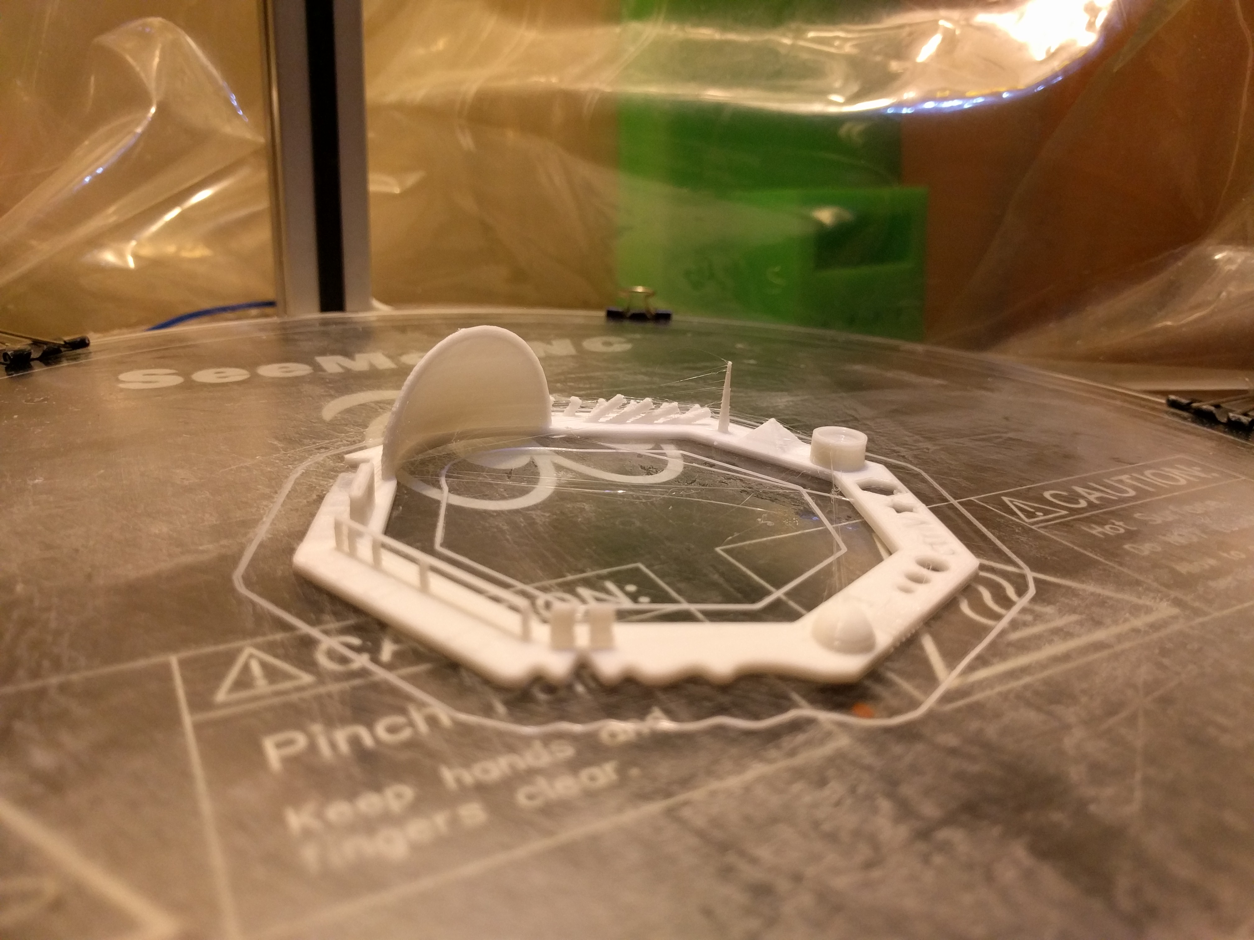

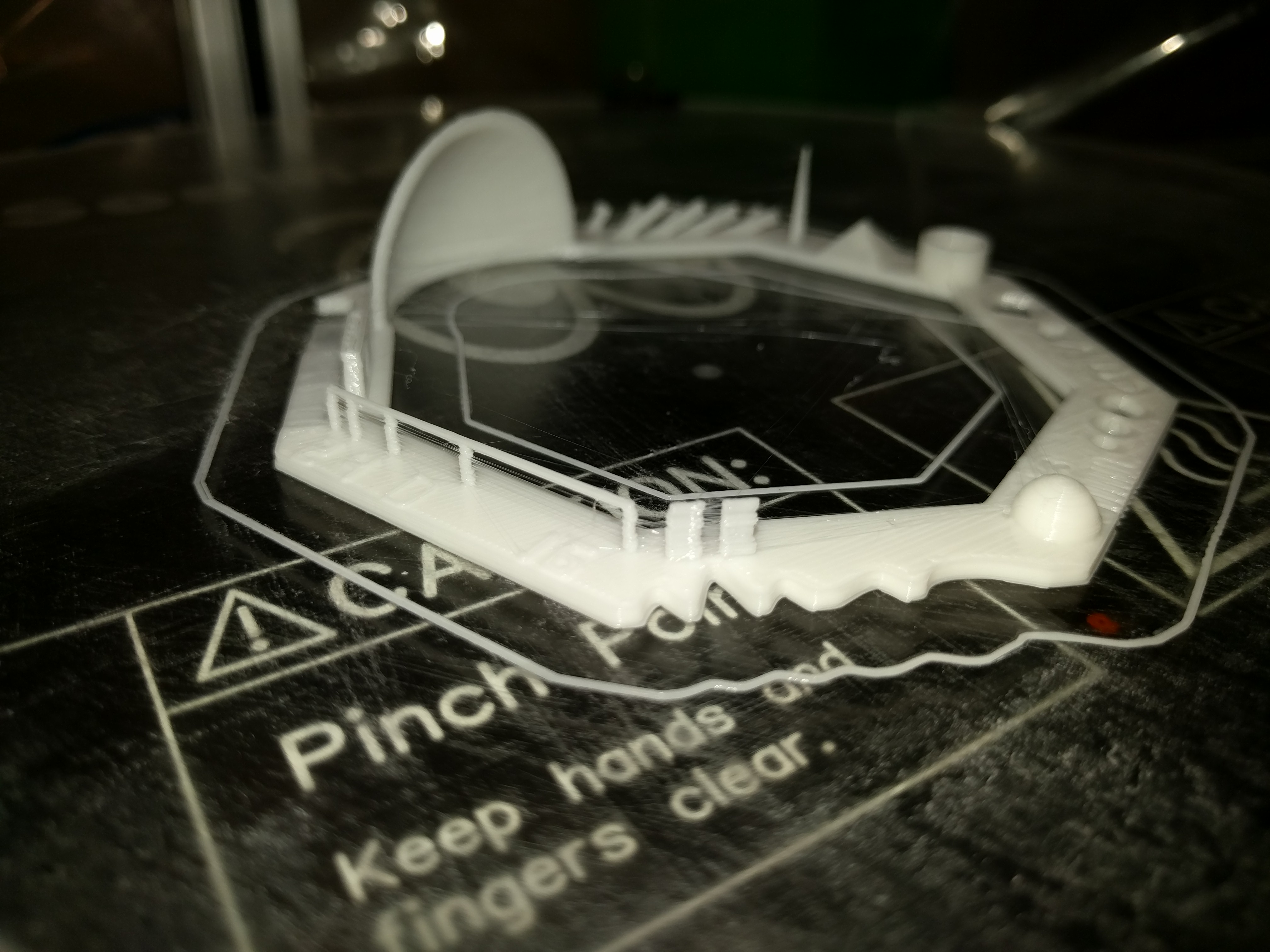

TortureTest.5mm.gcode
If you are running the stock .5mm nozzle and hotend, try running this Gcode. It is set to .2mm layer height, and .5mm nozzle diameter at 30mm/s print speed, 10mm/s first layer speed. 2 perimeter loops to prime the nozzle, and then the print begins. No raft, no supports. Retraction set to 5.8mm at 100mm/s, Travel speeds at 150mm/s. Hotend temp at 230, but you can use whatever temp you think is appropriate.
(1017.61 KiB) Downloaded 390 times
EDIT:
Here are some photos of my attempt at printing the torture test using a .35mm SeeMeCNC nozzle and hotend setup. Sliced using Craftware. By no means a perfect print, and I have some minor stringing in that area as well, but nothing that a little post-processing wouldn't clean up.
