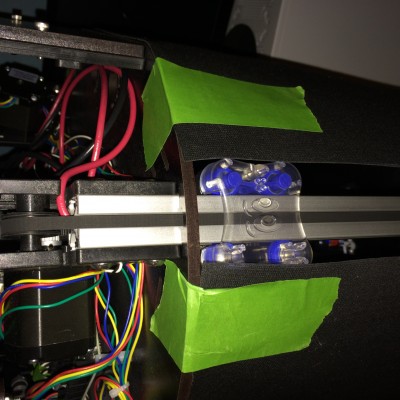

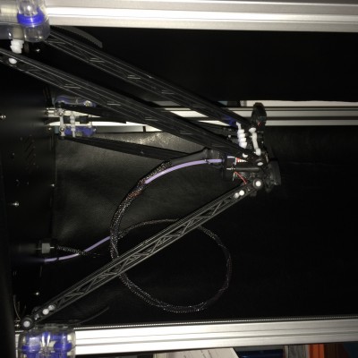

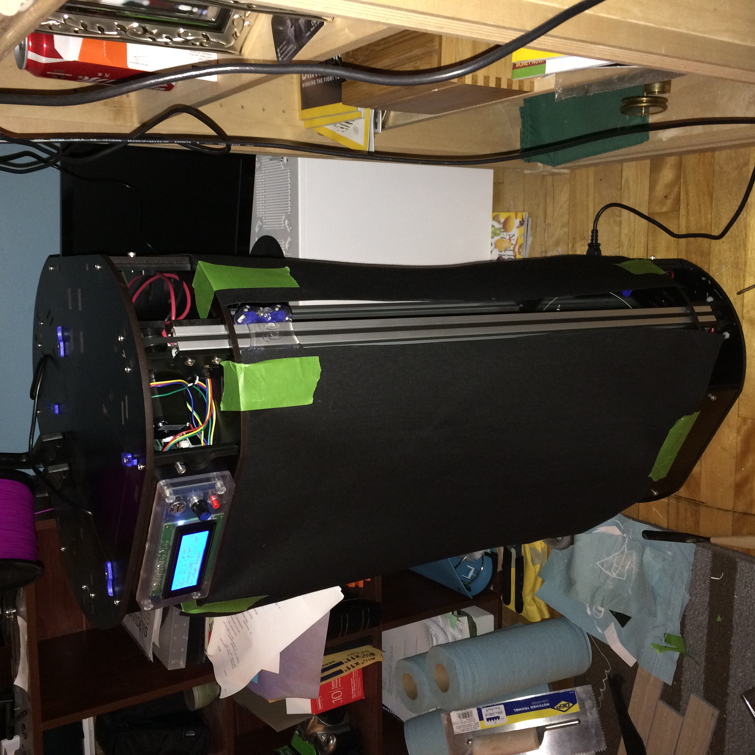

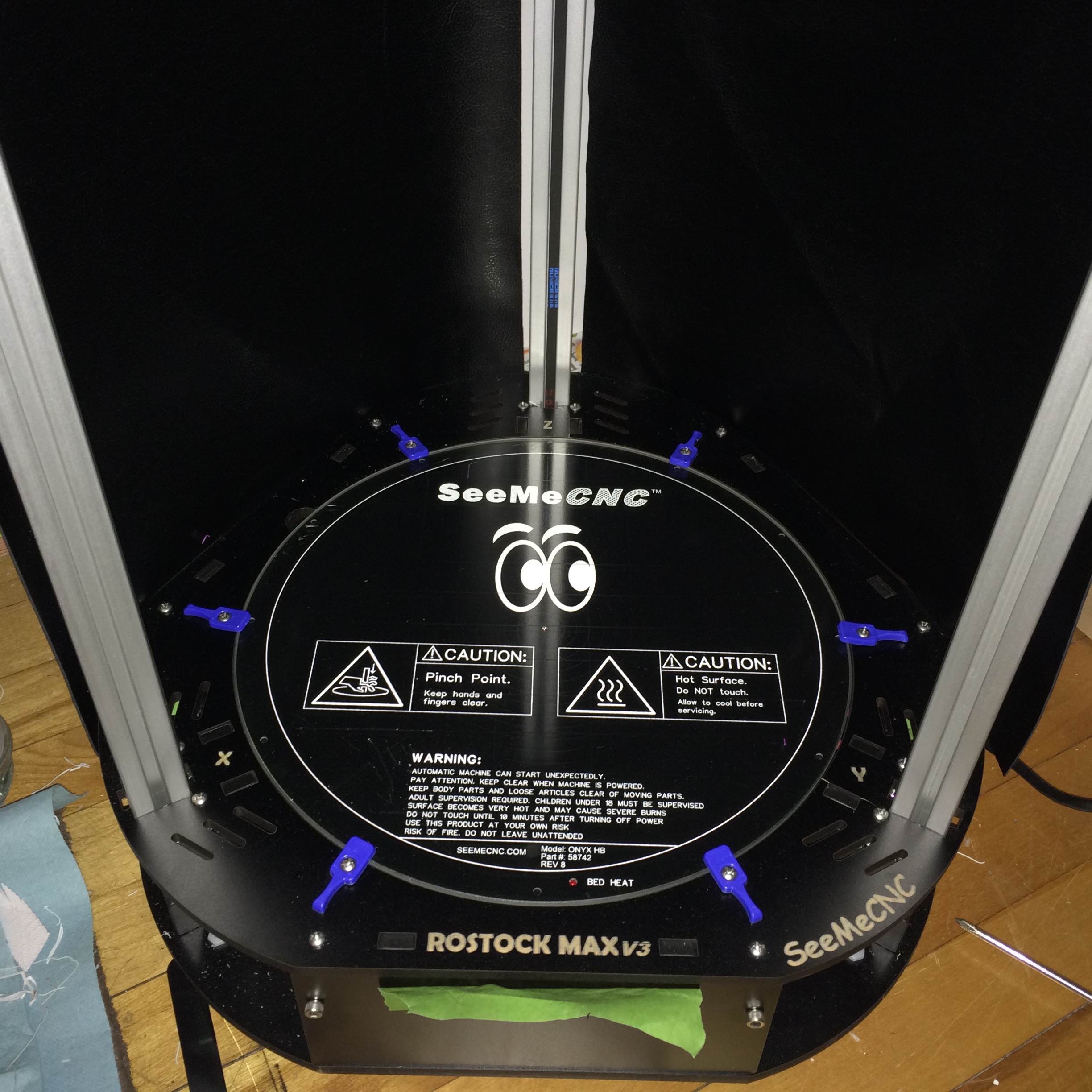

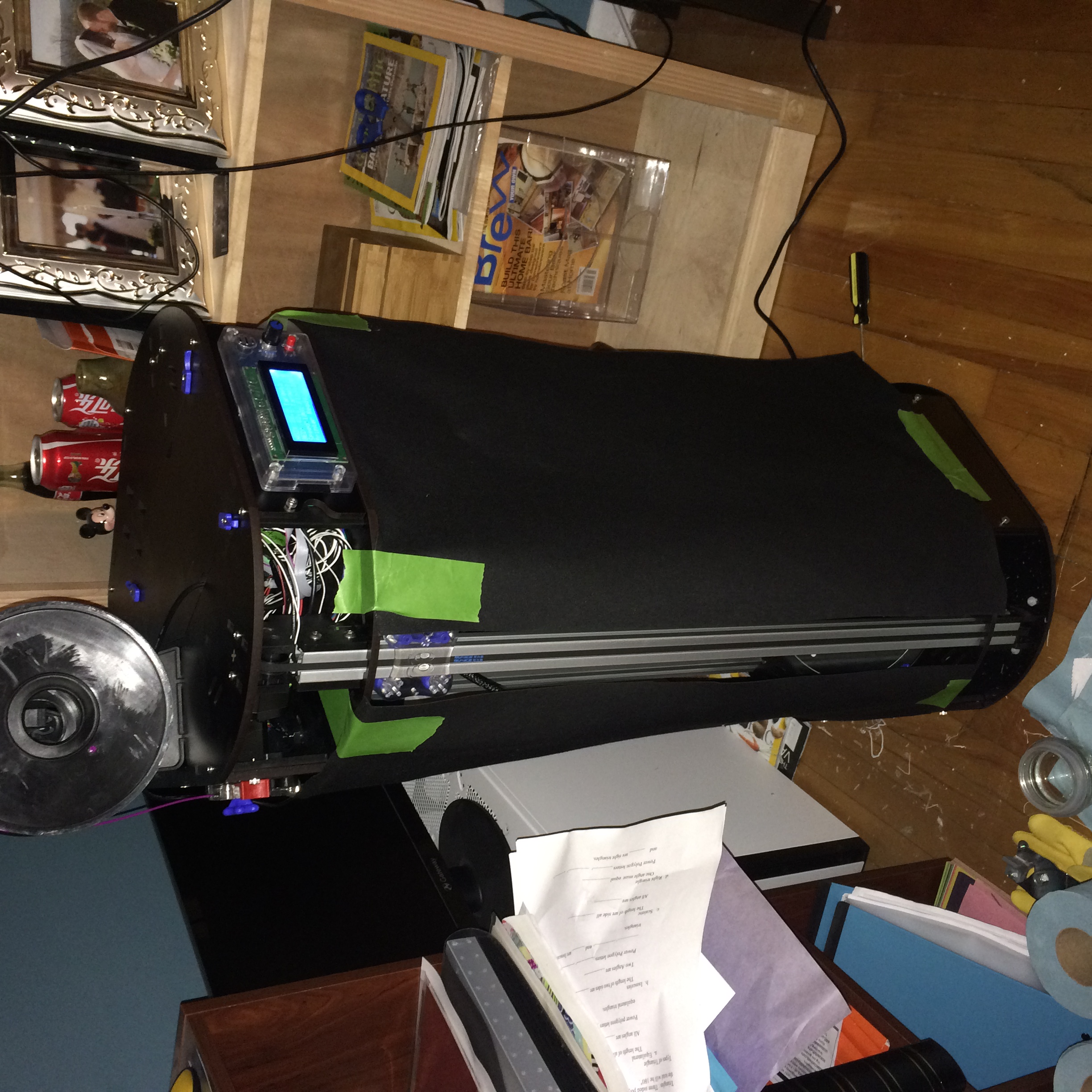

I made some drapes with pleather and green painter's tape (just so the adhesive won't leave a trace). Works pretty well to help the ambient temperature remain stable. I think I used 15" by 28" panels. Just long enough to tape at the top and bottom.
I also used painter's tape to insulate the bottom of my bed support. No insulation. Just trapping the air inside the tape. I eliminated my cold spots (mostly due to the power supply fan) and noticed a 10ish degree swing just by doing this on the left side of the bed support. Time to insulate ("apply tape") the right side, as well.
(and apparently my phone doesn't want to output pictures in the correct orientation - sorry!)

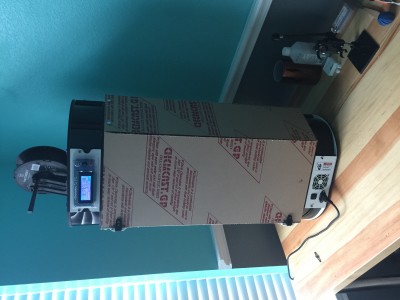

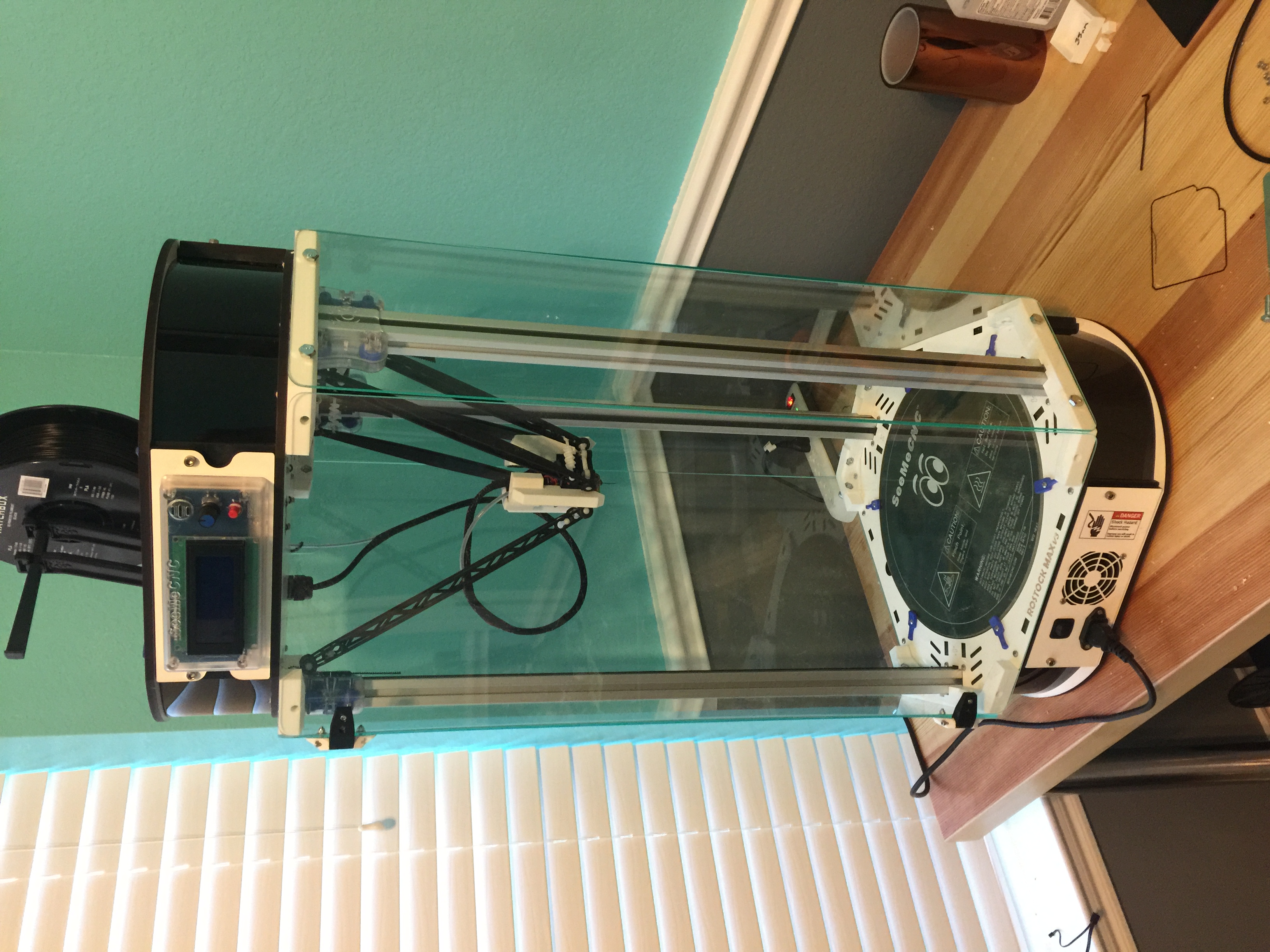

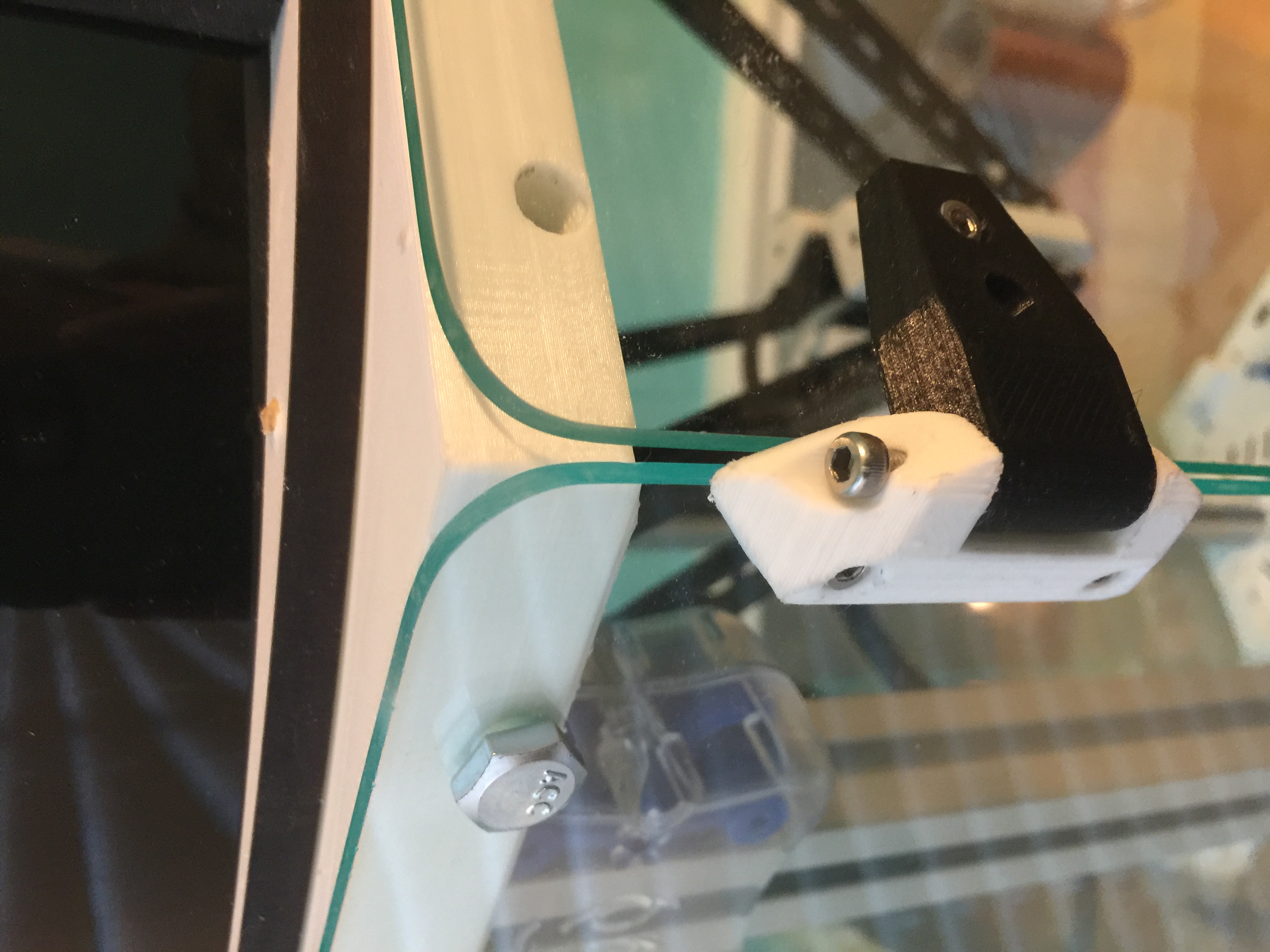

Some pics of the finished enclosure, it is working very well. Seems to be hold temp decently, although it could probably be improved.
Test fitting before tightening the brackets, too much work to fix the sideways pictures.

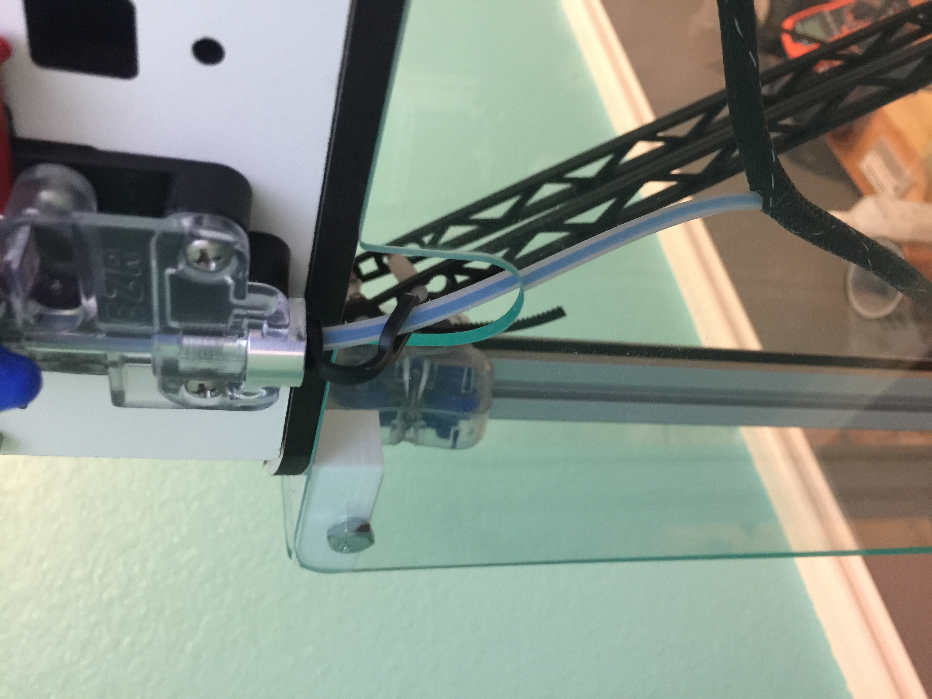

Modified the hinge a bit to bring the screws further away from the edges on the door, rounded and polished the edges with 320 and then 600 grit sandpaper.

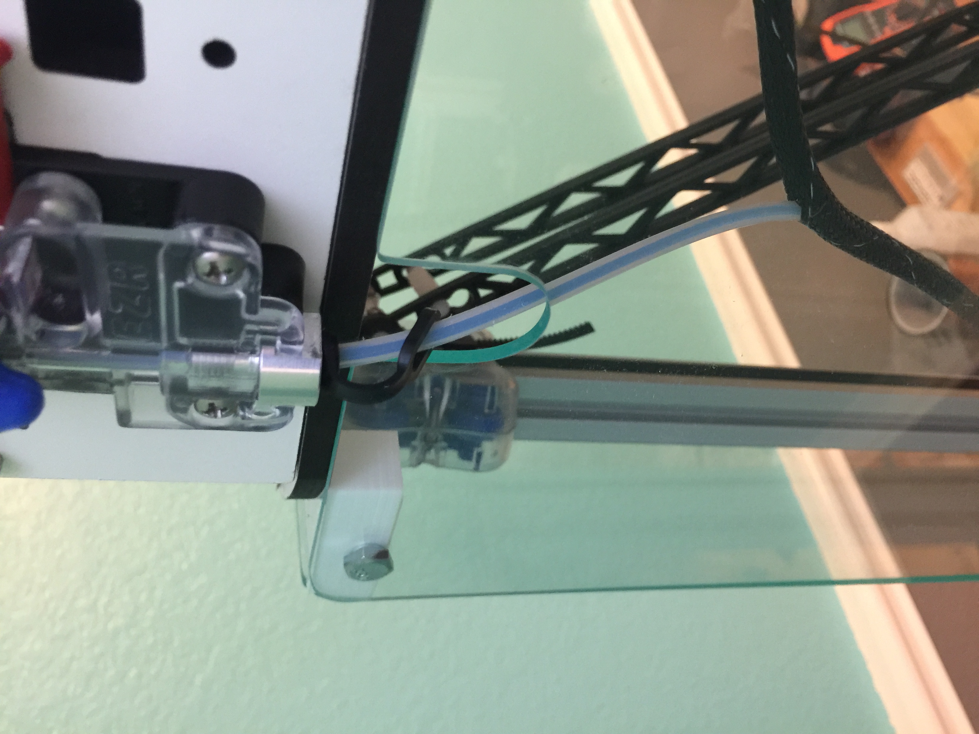

Bowden tube, might make a gasket for this to keep more heat in.
Finished.
