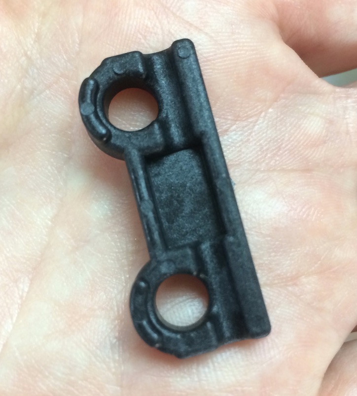

What is this piece? It is in the bag with the belt clamps.
Re: dmpalmer's Rostock Max V3 build
No idea! Didn't use them. Might be a V2 holdover.

I believe it was said that the spare parts are for installing the new carriages to the old arms that uses the steel axles and universal joints. They have to get rid of them some how.

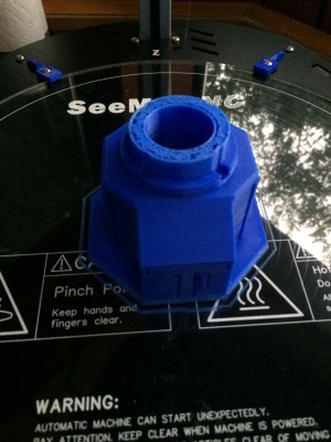

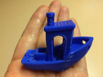

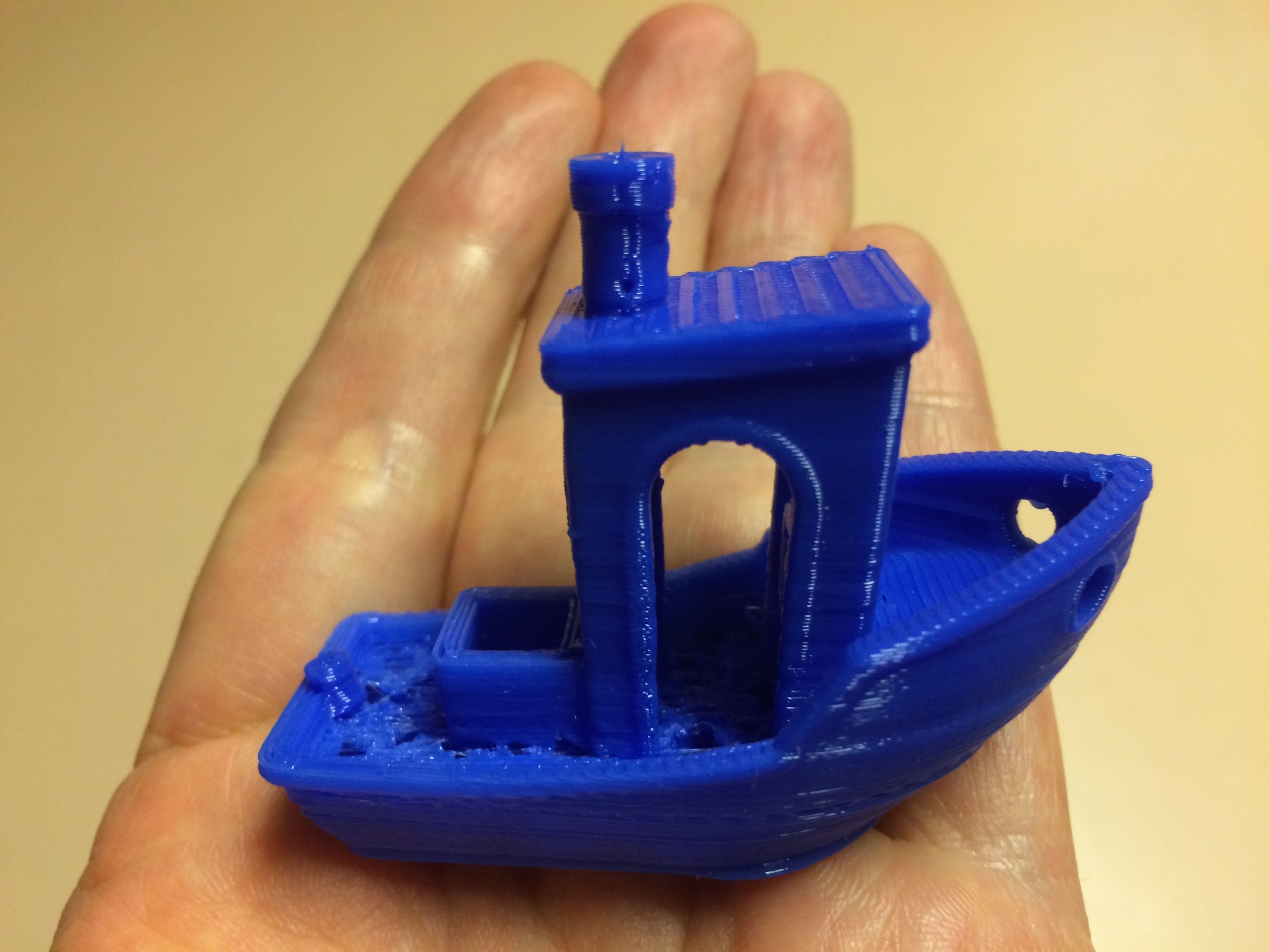

Completed assembly(1 hour)
I couldn't get the spool holder fully installed into the slots on top on one side..

Printing the calibration brick that comes with matterControl, on unadorned glass, standard settings on the standard slicer. SImulating the the stock experience for a first time printer.
Build time to first print: 25 hours[\b].
I like.
I like.

Calibration brick: 20.10 x 20.07 x 9.90.

Here is my 3DBenchy. MatterControl/MatterSlicer in PLA with all stock parameters.
And here is my third print, part of a CowTech 3D scanner. My H1.1 was never this good, reliable, or easy to use.
