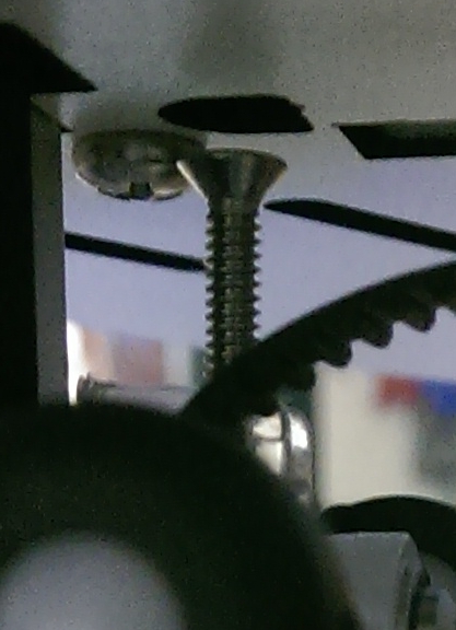

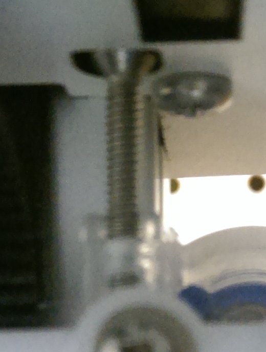

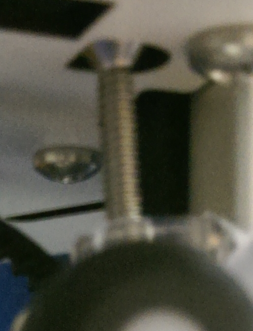

These three photos show X Y Z endstop screws in relation to the endstop. The X endstop is about 2mm lower than the Y and Z after G28
I had trouble getting my phone to focus. The Y and Z endstops were identical.

1) the special SeeMeCNC Repeater firmware has: #define FEATURE_AUTOLEVEL 1 so yes, it should be set to 1
2) this is likely because the length of X is 2mm shorter than the other 2. Is the screw screwed in further? It could also be that the switch is mounted lower (r the others higher) or the edge of the bed at X is lower. In this state, does the nozzle stay at the same high above the plate as you jog out to each of the towers near Z=0?

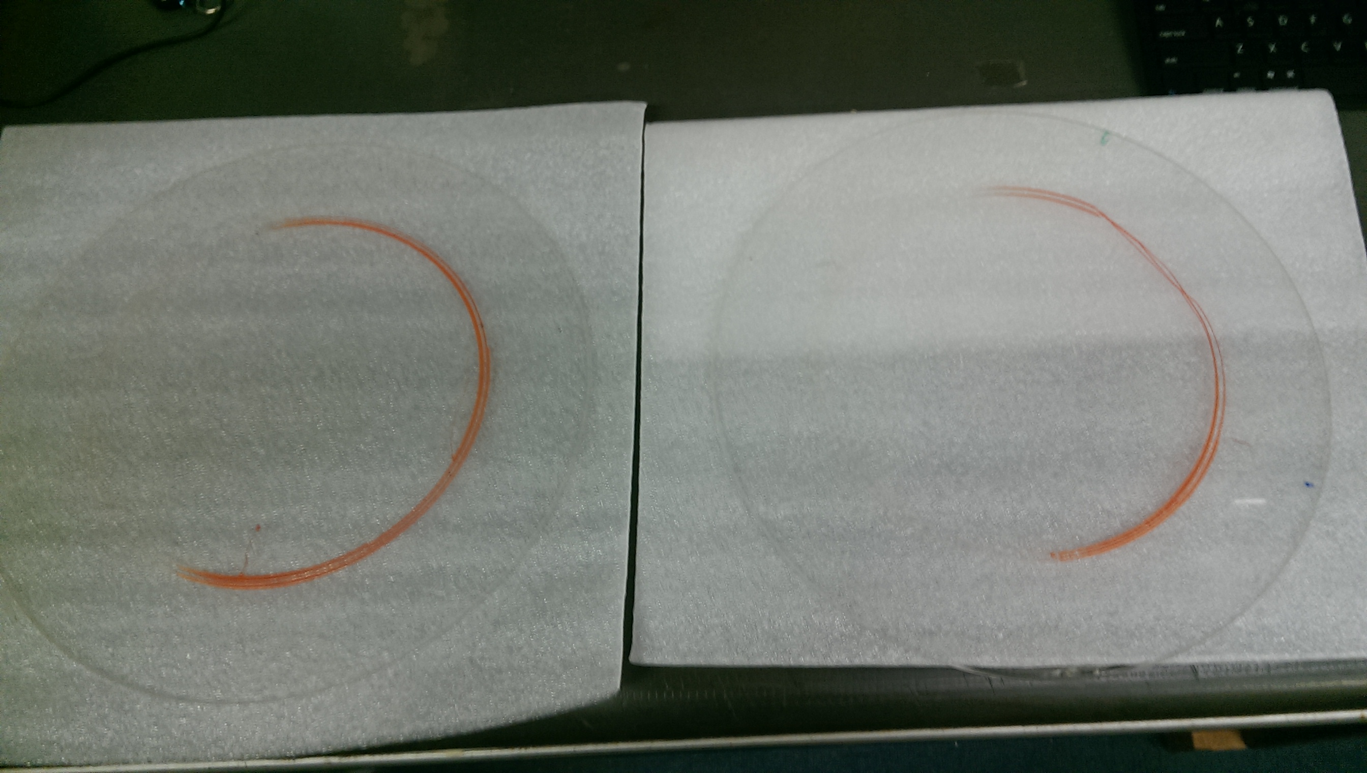

The heights might be correct, depends on your build.
The probing will measure the heights to the glass under the towers and if there is that much difference, that's what you'll see.
You can always check it manually after the auto level by moving the platform to the bed under each tower and checking what the height is, if they are all pretty close the leveling is working fine, The auto level in repetier is very basic, if one tower is miles off from the others the issue is with the probing, you have either a mechanical issue or an electrical issue that's causing the probe to trigger differently on that tower.
It's worth noting that you do want to be close to mechanically correct before you let any automatic level feature correct the error, if for example one towers had an endstop screw of significantly different length than the others it would affect it's ability to accurately calculate the delta radius, though even a few mm difference probably wouldn't make that much of a difference in the final calibration.

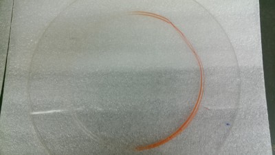

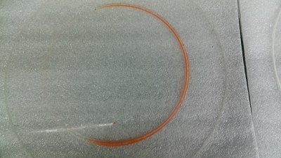

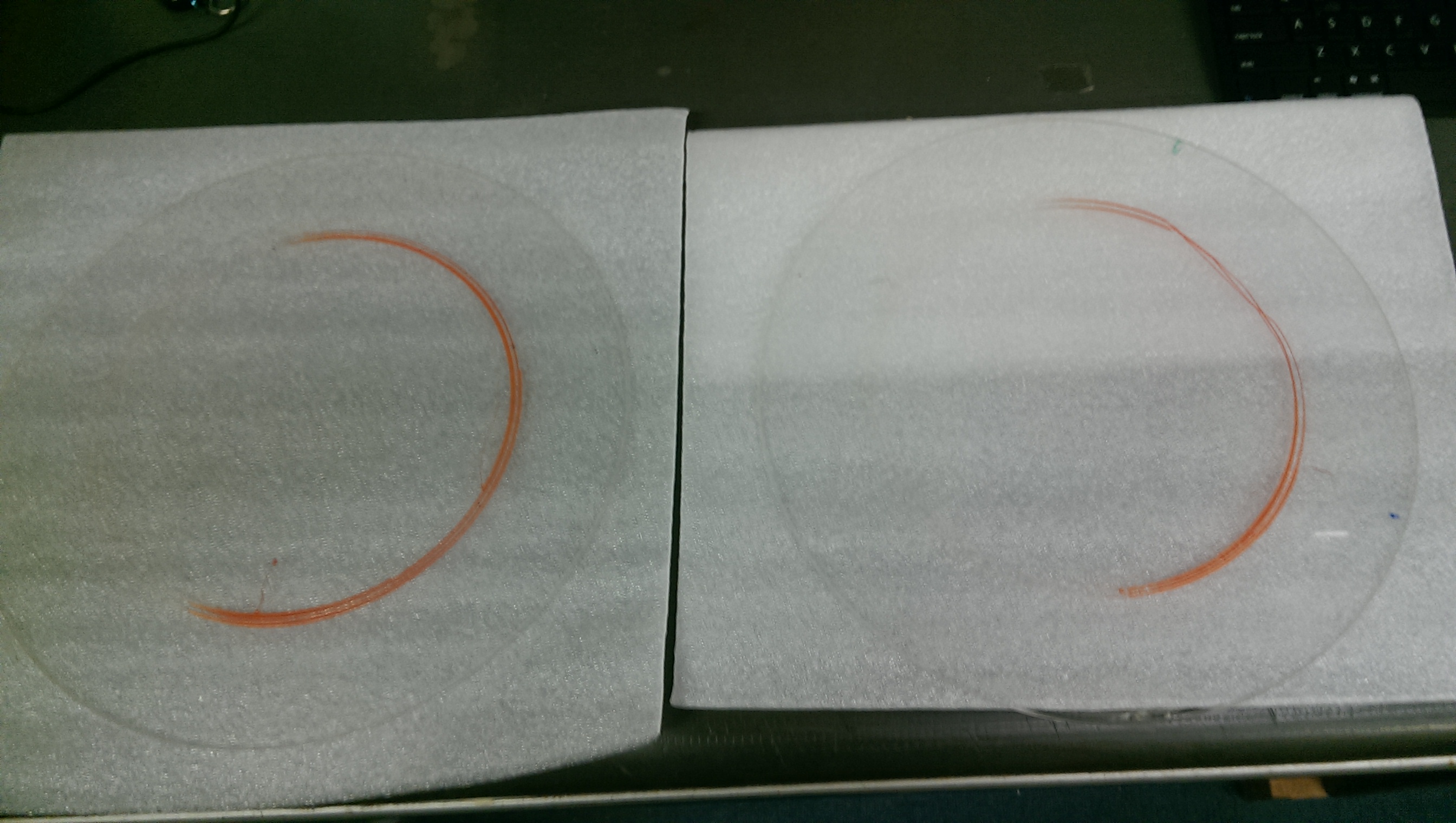

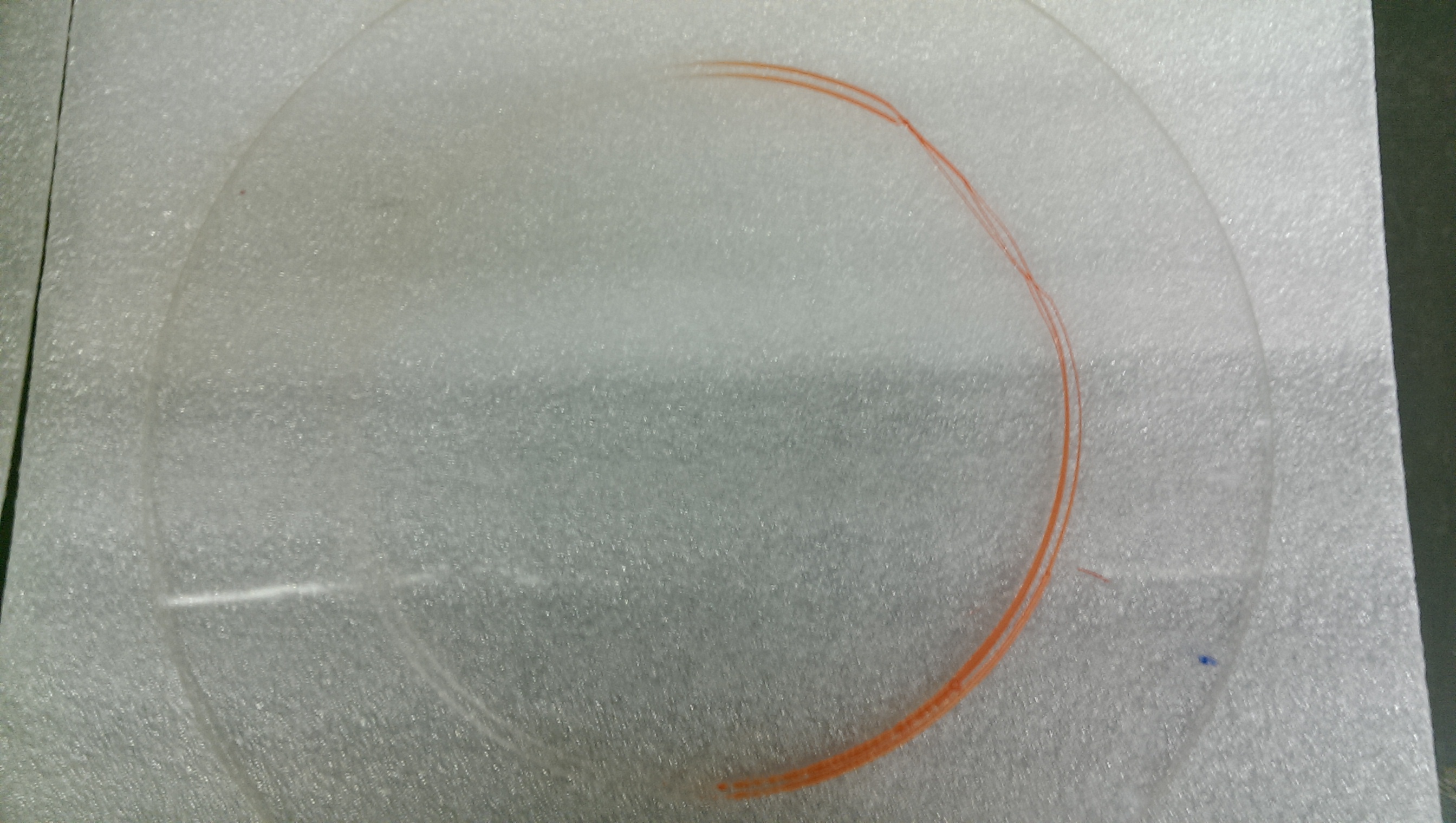

... long story short, I unscrewed the X tower endstop screw enough that the stutter is diminished to almost gone.
I ran auto-level several times. I printed a 100mm disk. See results below.
I've attached the log of the auto-level if that helps. I know something is eschew. The towers are all the same height. I'm tempted to try switching the X and Y endstop switches.

OK all, this is where I am.
I changed the X tower endstop switch. This produced a small change. The stutter still exists. However, the X tower endstop screw stops in a very similar position to the Y and Z endstop screws. The stutter still exists.
I run the auto-leveling gcode and results are as before. See above photos.
I then checked the tower heights as I do manually on my MAXv2. The X tower height was about 0.2mm tight. I set it with the endstop screw and printed with good results. After making this change I don't run the auto-leveling gcode again.
It is the stutter. I don't understand it. I've had the stepper, endstop and power lines separated. Run straight. Kept in bundles. Twisted. Curled. No change. Please take a look at the latest videos. The stutter is clear when compared to the MAXv2 HOME.

Seems to stay on X.
This is what I've been doing to test the levelness of the bed after running the v3probing script.
I set the debugging switch, Dry Run = On. I print a 200mm diameter ring. It is 10mm wide. As the hot end comes down to the bed I hold a piece of paper under the nozzle. As the printhead moves I move the paper with it. If the leveling worked, the paper slides between the nozzle and printbed. If it isn't level, the paper is pinched between the nozzle and printbed.
In this test, the results were the same. I was expecting the position on the printbed that grabbed the paper would have moved. It didn't.
This testing method seem OK with you?
Since changing the X tower endstop switch the relative positions of the endstop screws to the underside of the printer are very close. I couldn't determine if switching XY endstops and steppers.
