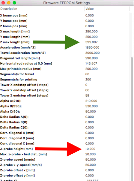

I have a Rostock v2 with the HE280 upgrade and after running the calibration the first layer is so squished nothing is extruding. Is there a way to adjust the calibrated height the autocalibration sets?
						Re: Adjusting first layer

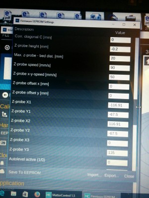

Yes there is. The Z max length is saved in EEPROM and can be manually tweaked (green arrow) OR there is also a Z probe height (red arrow) in EEPROM that can compensate automatically if the situation is consistent. I found I got better results if I set mine at -.2.

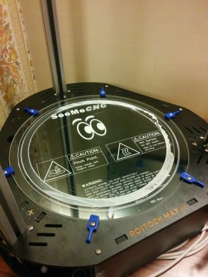

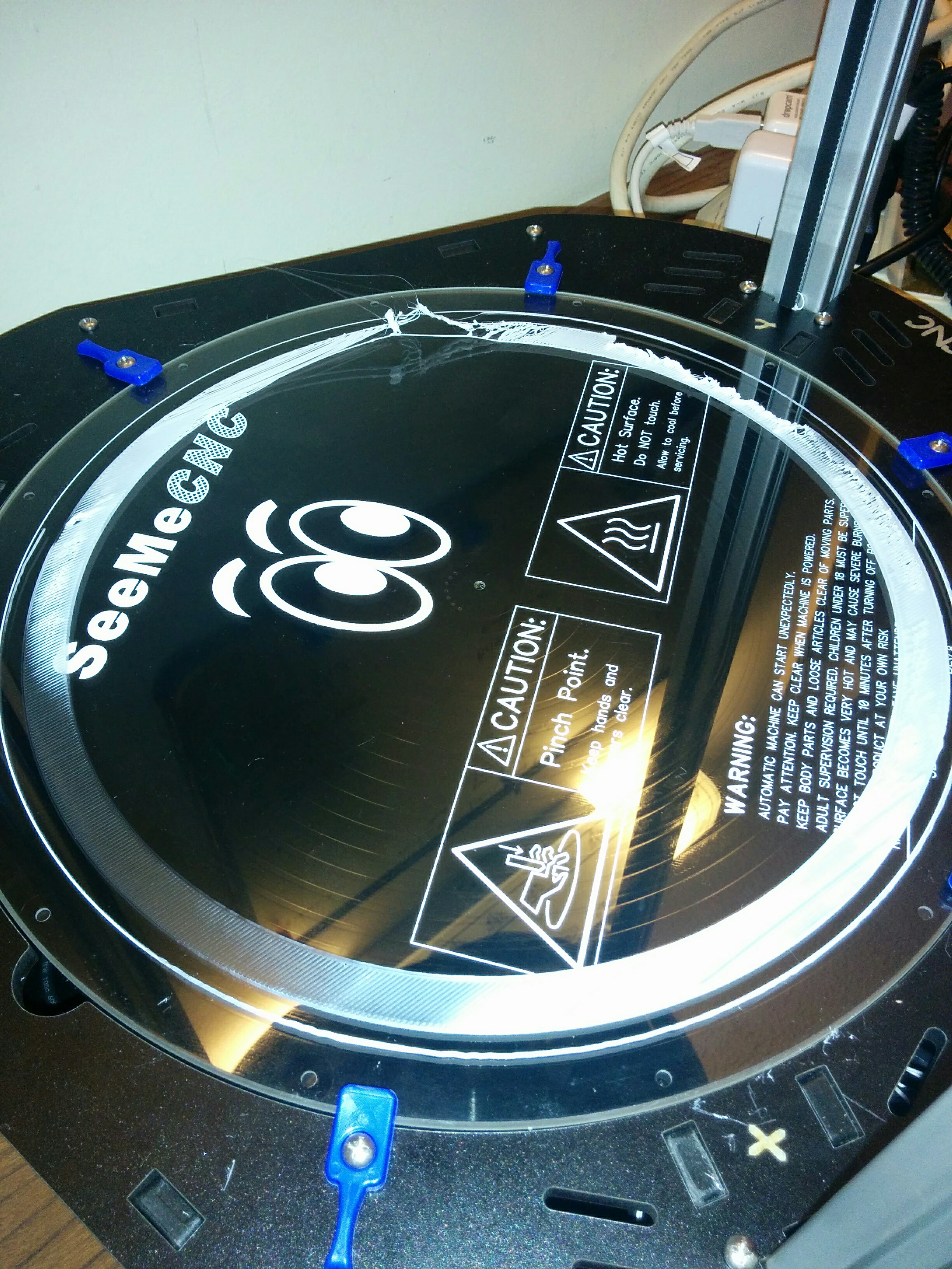

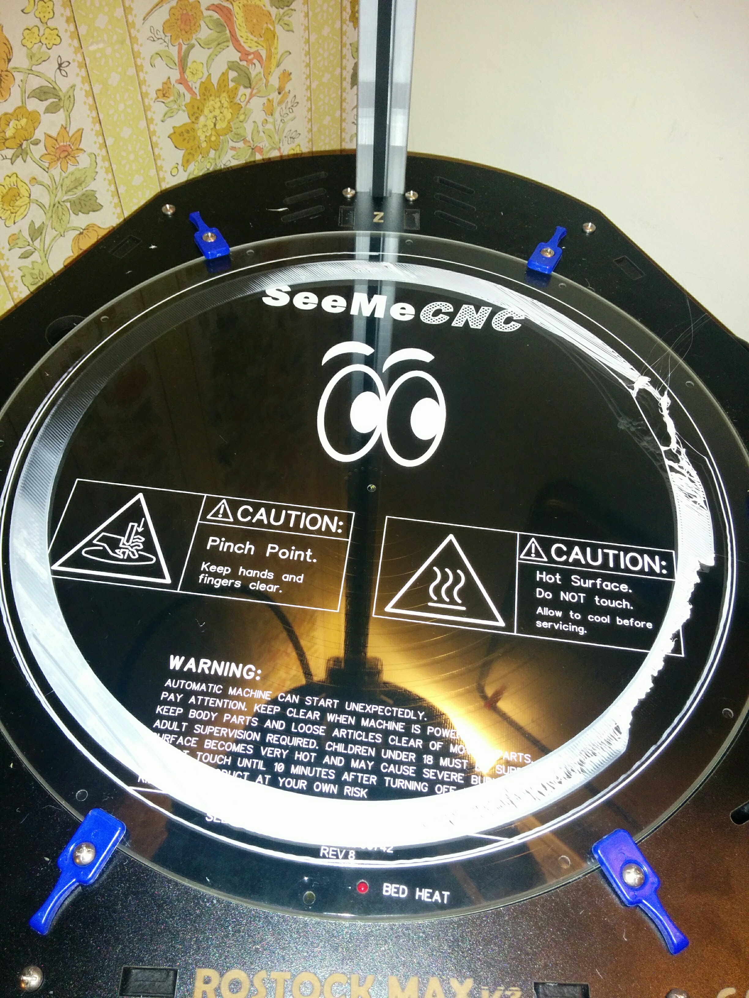

After setting it to 0 it is working much better. Just have a spot between the x and z axis that is too close to the bed.
Unfortunately, a growing number of us are experiencing this and I'm actively experimenting and researching it. Most of us are seeing the same result you are with the low spot between X-Z but there was a report today I believe from someone seeing it between Y-Z. I need to verify that.

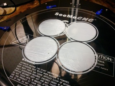

As you can see I am running thin on the XZ during this temp test. I was changing the temp on the printer while it printed.
The good thing is, at least for what I am printing, it hasn't had a negative effect.
After cleaning the surface, recalibrating and running the new calibration ring.

Ok, looking at morgandc's photo I have a theory we can test. If probing at the Y tower resulted in a little deflection (even a tiny deflection of .05mm could cause an issue) then that tower would be artificially too long. This would result in the apparent bed tilt as shown. Any flex or difference in clamping pressure at Y could result in this. I think it's time to scrutinize the mounting system.

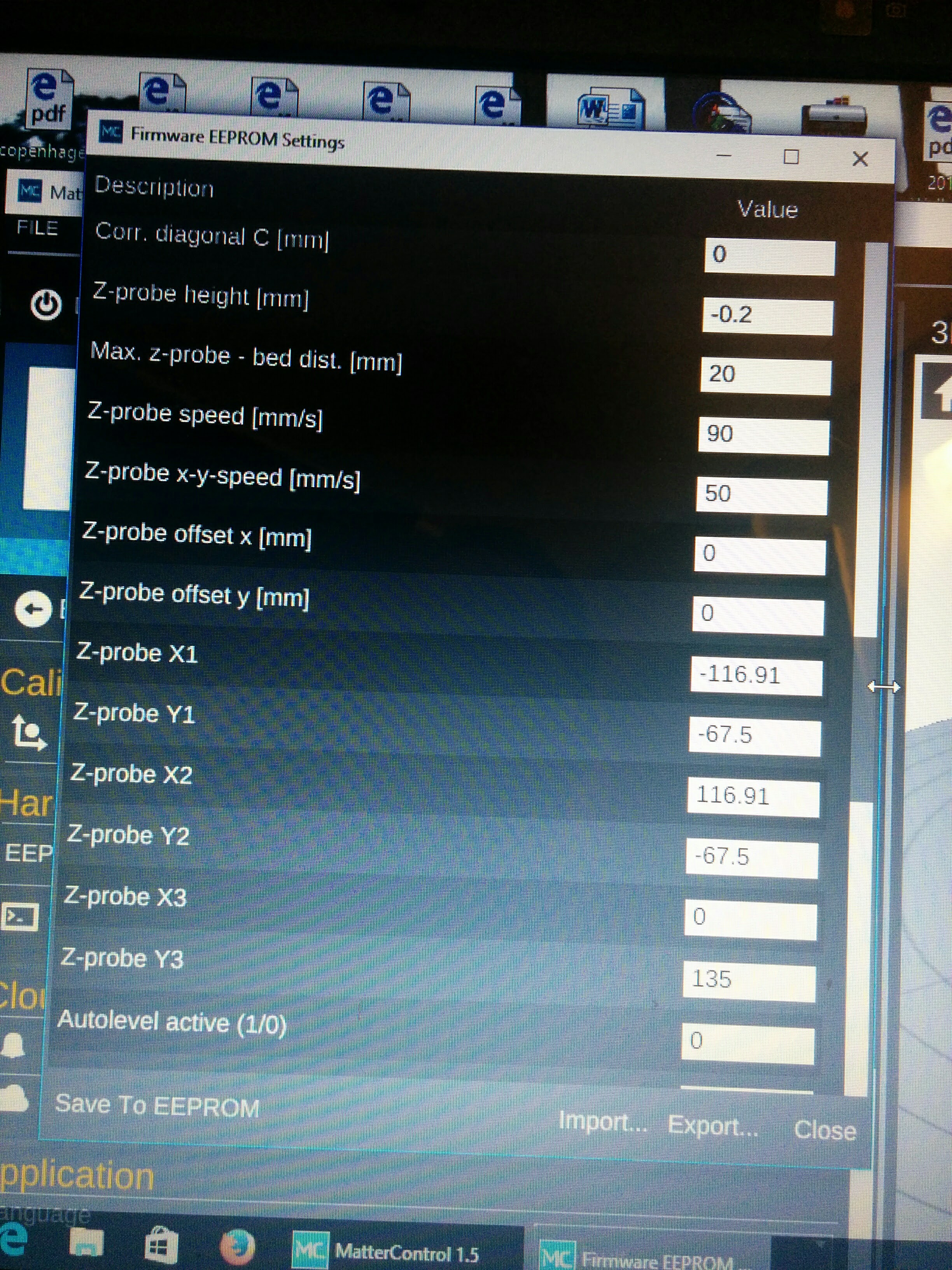

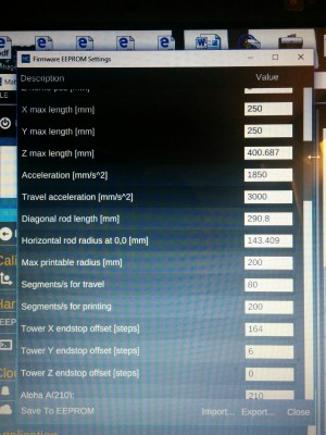

As requested
It's the tower endstop offsets that I wanted to see. You should dial in the offsets to get all 3 below 4 steps. I posted how to do this in my build thread.
Your X is 164 steps!!!! That is over 20mm. That can cause calibration issues.
Tower X endstop offset [steps] 164
Tower Y endstop offset [steps] 6
Tower Z endstop offset [steps] 0
I am assuming this is the endstop screw adjustment, I will work on that this evening. Not sure how it could be over 20mm off...
