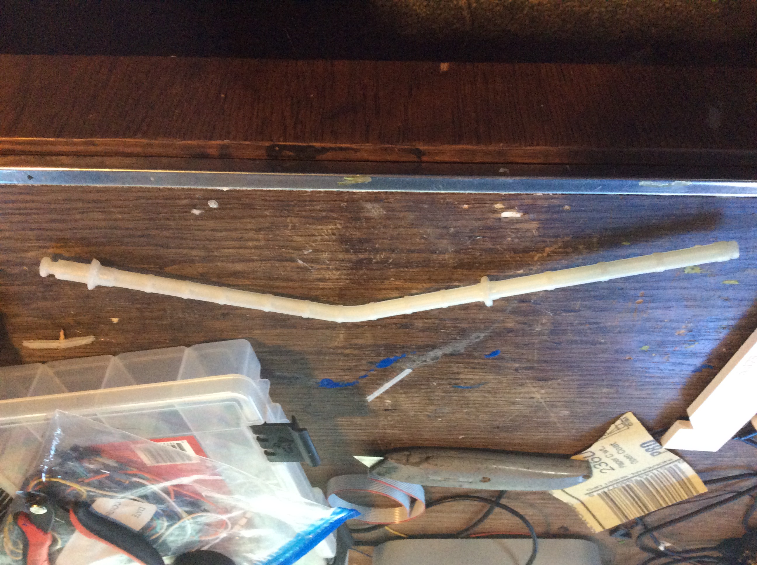

i've tired lowering the retract. But the extruder grinds down the filament no matter what. The first time the filament was broken off and wrapped all the way around the grub screw. I've also thought that the berdAir might be causing the hotend to get too cold, but it stays around 200c. I've verified the temp with a meter, it is actually running about 5c higher. I've also turned the cooling off, just in case.

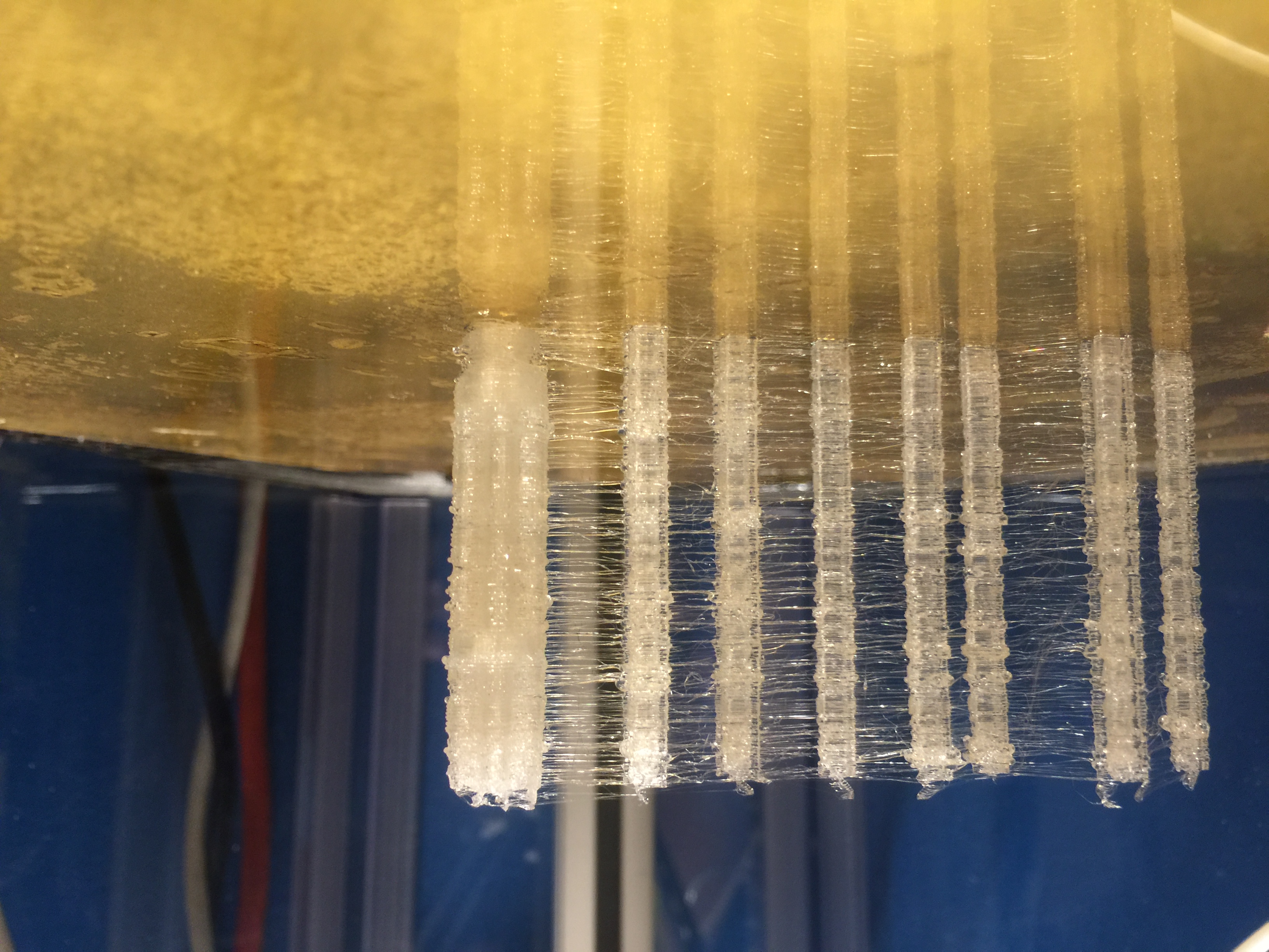

Here is a picture of a a failed print. This is supposed to be about 22cm tall. It starts getting clogged around 1cm off the bed and completely jams about 5cm off the bed.
If I heat up the hotend again, the filament will extrude....

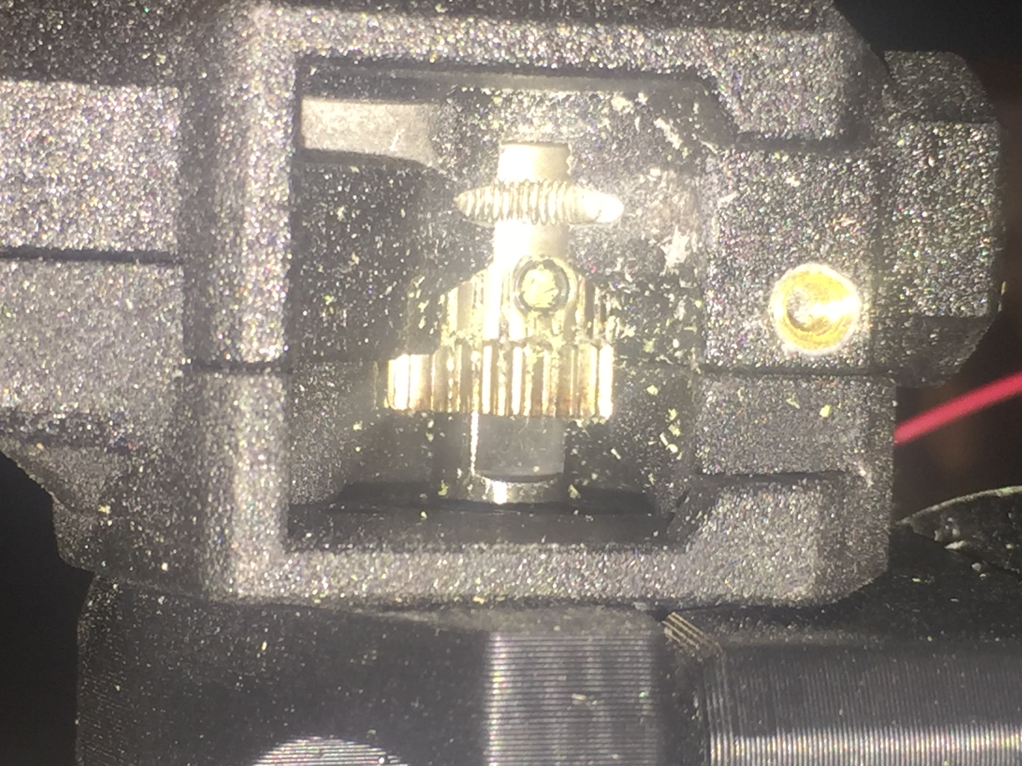

Check your Bondtech drive wheel alignment as per page 4 & 5: https://drive.google.com/file/d/0B7A1ME ... dYcXM/view
This is a user serviceable and maintenance operation and you should learn how to check it. It does not go out of whack usually but it does happen so best to check. I don't think that's your issue though.

It looks like the bondtech is aligned well? I took a look at pages 4 and 5 and it looks the same....
Re: PLA jamming
Ok, that's off the table. By the way, how tight are you screwing down the release lever on the Bondtech?

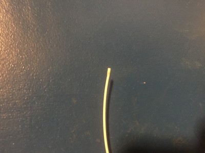

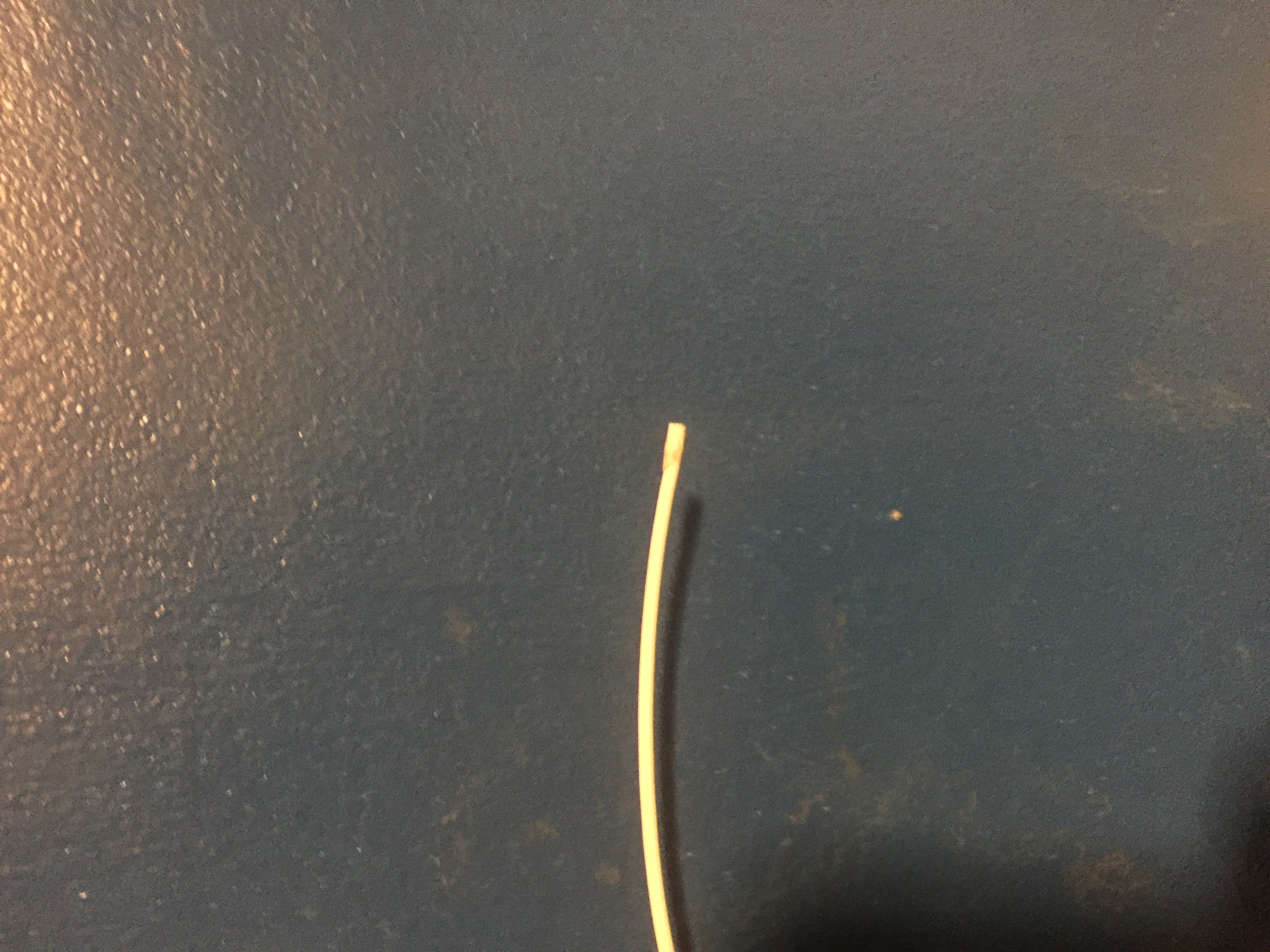

I just attempted a cold pull with ABS (I don't have any nylon) and this is what I got..
