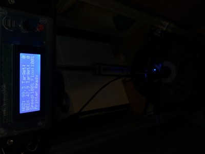

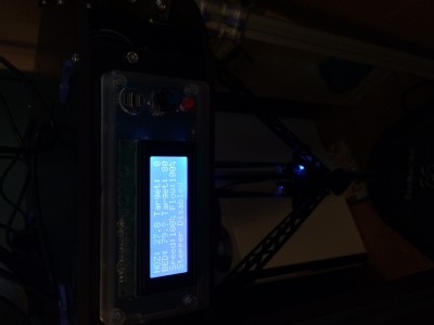

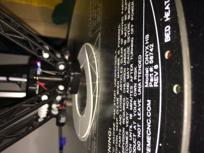

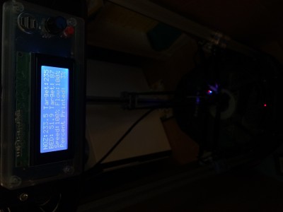

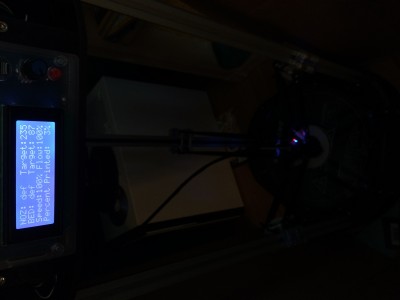

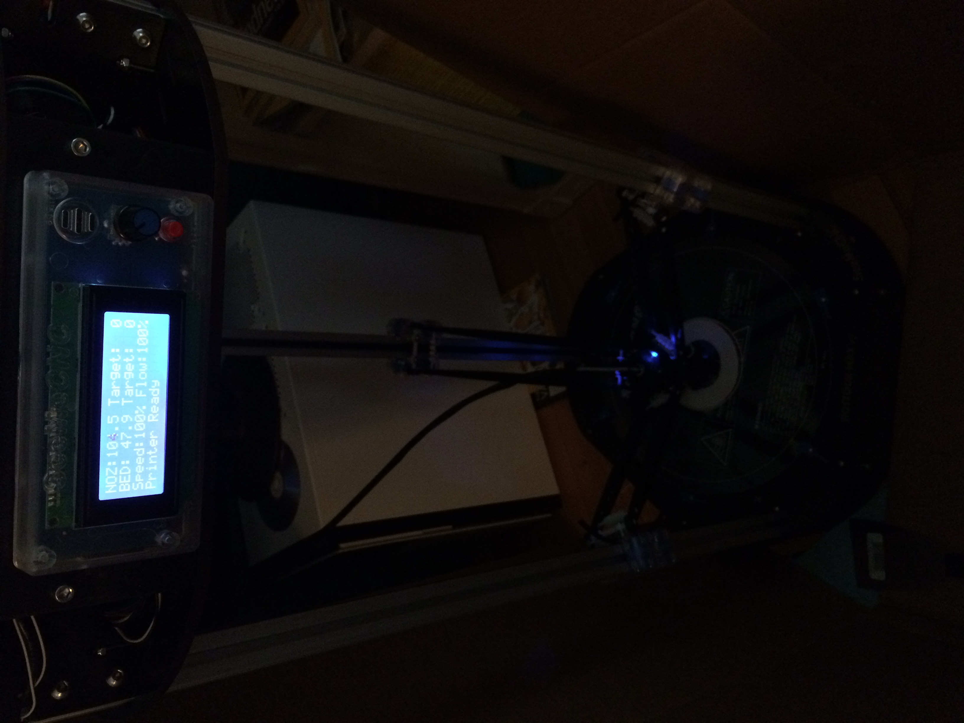

While printing this test print, I watched it carefully the whole time. The raft printed nicely and then the temp started plummeting. Here's my notes that I frantically typed down:
Bed heat plummeted to sub 60 after 2% of the print despite heat LED being on and set at 95. Approx 0.2 deg per second. I can hear snapping and popping of the raft - part must be cooling enough to allow relative motion of the coarse extrusions and delamination from the bed. Temperature at 54 after several minutes (3% printed). This print is at a similar location as the last time it failed (which was also the first time I tried it). A few mins later, bed at 52, still 3% printed on lcd.
Raft has delaminated on one edge of the ~4.5 inch diameter and both thermistors now read def. still 3% in.
Immediate reset using red LCD panel button reads temps fine immediately.
Bed can be set to 80 at the LCD and heats like normal.
What the what is going on!? :evil:
