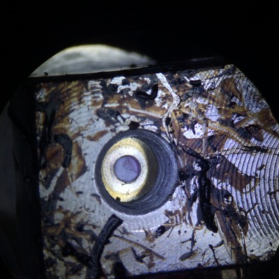

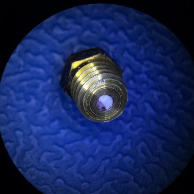

1) Removed the Nozzle. I noted that there was a solid core of white throughout the nozzle, but just a hint of purple just inside the heat break fitting that is screwed into the heat sink. (See image below)
Nozzle
Nozzle
Bottom of the Heat Break

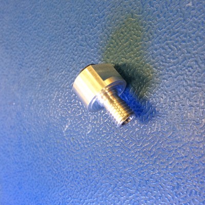

2) Removed the Hot End PTC Adapter (70604) that holds the PCBA to the Heat Sink. It is very clean with no melt, whatsoever.
Clean Hot End PTC Adapter

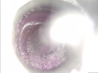

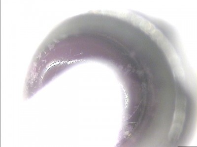

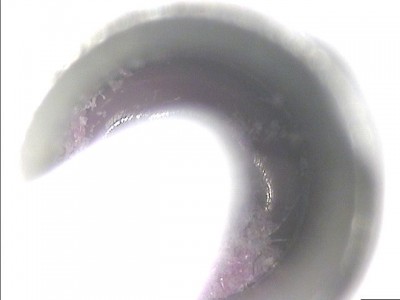

3) Inspecting the bore inside the Heat Sink, I found that there was a very large amount of what looked like crystallized purple melt at the bottom.
Purple inside Heat Sink 1
Purple inside Heat Sink 2
Purple inside Heat Sink 3
A couple thoughts:
1) I have passed white filament through this hot end and printed ONLY white while still experiencing the same binding at the extruder. So, I have reason to believe the purple, where it is, is staying solid and not melting...
2) I feel as though I shouldn't see melt at this diameter. This leads me to believe that I might have backed the Bowden Tube out of the hot end too far and it allowed the melt to rise up, which then prevents the Bowden Tube from being seated all the way down again where it should be.
