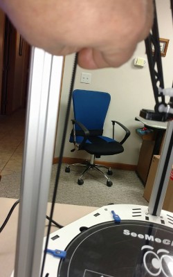

1) Belt Tension: Don't need to sound like a guitar, but not loose. All three tightened the same. Be sure the belts ride over the pulley's nicely. Timing pulley's on the steppers are centered up with the belt and idler's.

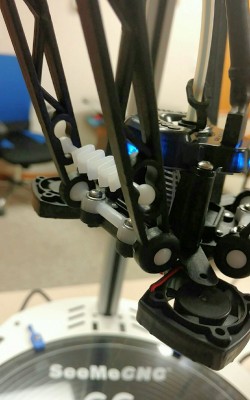

2) Carraige and Platform:

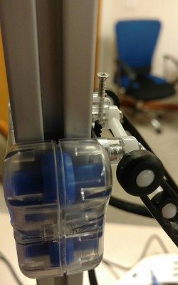

2A) Press-on ball joints firmly and complete first. THEN install washers and screws. If you use the screws the squeeze the ball joints onto the carriage or platform, the ball joints might now seat fully and dimensions and geometry critical to parallel kinematics will be off and cause problems.
2B) During carriage assembly, first check plastic bearing sleeves for strings or burr from machining. Press sleeve firmly onto the R4 bearings. Press each bearing firmly and completely onto the carriages and plastic spring arms. Next be sure the two halves of the carriage fit together with only a small amount of squeeze, then install the three screws to secure the halves. Like the ball joints, using the screws to squeeze and 'seat' the bearings will likely break the plastic.
2C) Install those #4 flat head machine screws square and completely until almost touching the screw holding the ball joint on (and that's the last time you touch the end-stop screws ;) ).
2D) Bowden tube entry and exit from the wire mesh loom can effect bowden-carriage interference, plug connection, and pulling on the platform assembly. Don't exit too close to the top of the hot end - give some wiggle room.

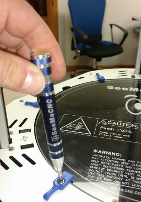

3) Bed Clamps: !! Don't over-tighten these !! Gentle clamp pressure. Over-tightened bed clamps can bow or flex the glass build surface. Use a metal straight edge to check flatness of the bed at room temperature. The Onyx rev8 bed is 1mm thick and 'floats' under the glass to compensate minor expansion. The 1mm thickness allows the glass to easily flatten any warping happening to the heater. Also pay attention to tape and LED leads and the three dimples in the plastic bed insulator that help keep the bed heater (Onyx rev8) aligned. The blocks supporting everything have two different heights. I recommend the deeper side and the glass will sit flush and nicer with the surface of the printer.

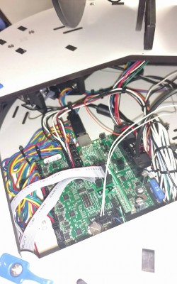

4) Wiring / Electrical: I just built this v3 in the pictures last week. It works great and it probed and printed first time, like all our other production printers. I did tweak the z probe offset a little more to bring in an even surface (tuned out about .003") Looking at my pictures, the guys thought it was funny I looped all of my end stop wires together and didn't cut them short. I wanted to do something that might cause noise issues - YOU should cut them down shorter. I did keep my stepper wires away from end-stop and control wires. The I2C going down the bowden line next to the hot end and part fan doesn't matter because the BED and HOT END are NOT ON during probing. I know, you might be thinking, 'what about the probe wires beside the hot end or part fan pwm wires?' We'll, probing is done while the hot end is room temperature and fans are turned off. So nothing is happening there to mess with I2C wires. If you are trying to auto-probe and heat is on, then you're doing it wrong or you have the wrong firmware installed on your printer.

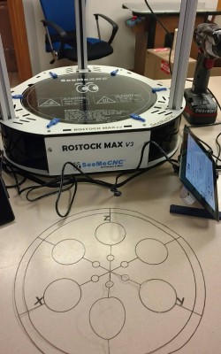

Lastly, I made a 275mm diameter calibration print. Find it here: http://repables.com/r/800/

Steve, the bed mount is the only difference I see on how I assembled my V3. This is what's in the online manual:
Are you saying that you installed the mounts opposite of what this photo shows - the red arrows pointing to the injector pin marks facing up?

yeah i dont know why anyone would install the bed mounts as shown in the instructions. they are clearly backwards and will offset your bed height by an unacceptable amount.

mhackney wrote:Steve, the bed mount is the only difference I see on how I assembled my V3. This is what's in the online manual:
I did. The bed is fairly flush. It fits better this way and we'll look at updating the manual. I'm adding an edit to the online manual now. It's not wrong if you assembled the other way, but things just fit better this way.

pswindler wrote:yeah i dont know why anyone would install the bed mounts as shown in the instructions. they are clearly backwards and will offset your bed height by an unacceptable amount.
You could install a 1/2" thick bed and will probe and print fine. That's the advantage of auto calibrating. Using the nozzle eliminates other offset errors introduced by other methods. Plus if you put a paste extruder or some other end-effector on the platform and keep the prob board, you'll calibrate in no time.

by mhackney
I flipped mine over this morning so I understand what you mean. I'm printing on bare glass for now. The blue clamps aren't excepting any pressure on the glass and it actually moved around during a print. I've taped the glass to the bed with Kapton near each tower just to experiment for now. How do your blue clamps hold the glass down? Perhaps mine have warped using them with the supports in the other orientation.

Also, when I originally wrote up & photographed the bed clips, it shows the clip orientation how I was explicitly told how it should be.

In this case, no one is blaming you for the bed mounts geneb :)
With the mounts positioned as per Steve's comments, my blue clips do not contact the surface of the glass. I don't currently have anything on the glass so there is no extra thickness and the plate top is just barely proud (<.1mm) of the top plate. Is anyone else experiencing this?
I just swapped mine around and was expecting the same result but it actually fits better. The clips are touching and the glass seems to be held well. I have all six in place, I have the widest part of the blue clip touching the bed as it has the little bumps that are touching the glass. The glass now seems to more evenly recessed around the perimeter verses sticking up slightly as before.

I'd love to see a good close up photo of the clip touching the glass and the height the glass is protruding if you can. Those little protrusions on the top of the clip are at the same height as the pad around the screw hole to allow the clip to rotate easily. Since my glass is nearly flush with the printer top, there is not enough leverage for the clip tip to press against it. I can't detect that my clips are warped but perhaps they are slightly.

Here is what I came up with- they are not all touching but when I take them all off the glass most of them will move the glass the I slide it in to place as will the one is these two pictures. Hope this helps my friend.

by Bones056
Here's how I handled the clip problem.... Had to add 3 layers of Blue Painter Tape at each clip to get the glass to stay put!
