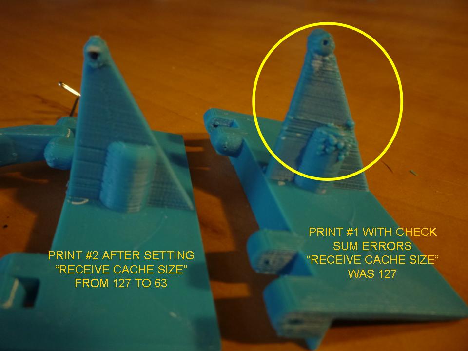

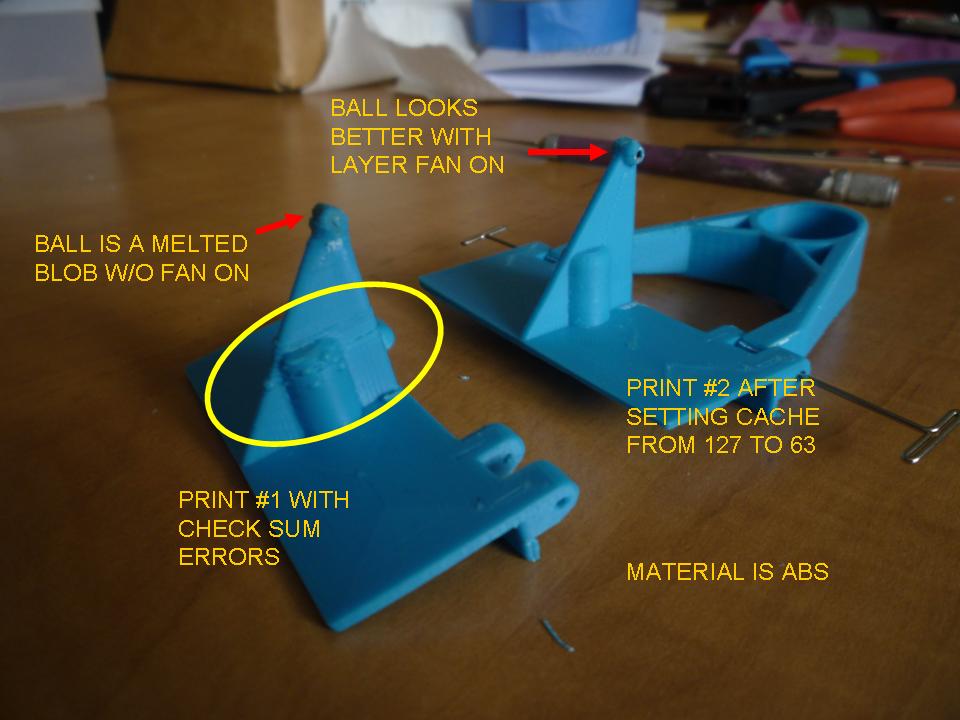

Re: Communications Errors After Switching to Repetier Firmwa
Getting the same errors about an hour into the print. Turning off the visualization seemed to help...maybe just wishful thinking. I do know that when the errors were happening, I opened Windows Task Manager and the performance tab was showing 100% CPU usage.... Hmmmm.
The errors caused the the hot end to just sit motionless and continue to make blobs....
Last edited by Delta Zee Solutions on Thu Aug 14, 2014 12:15 am, edited 1 time in total.
- Delta Zee Solutions
- Posts: 35
- Joined: Tue Jul 22, 2014 7:20 pm
UPDATE
After checking the Receive Cache Size" under printer setting, I found mine was set to 127 and not 63. After making the change, and this change alone, I ran the same part with no errors.....
