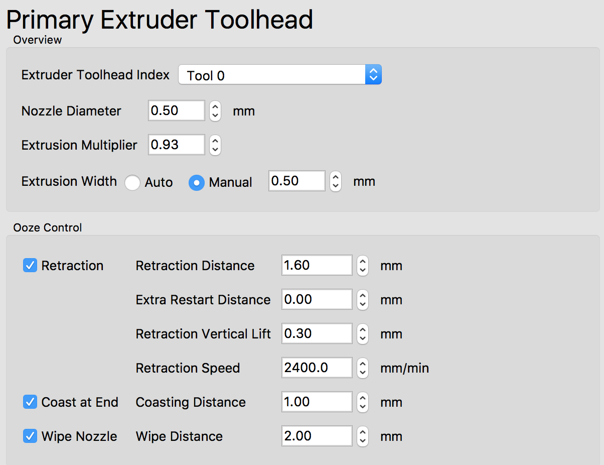

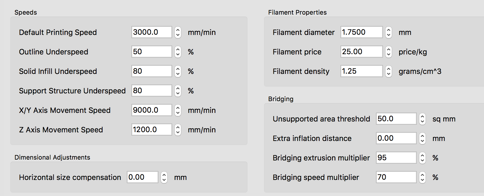

Hey everyone,
Since I have upgraded to the HE280 on my V2, I have had an issue with lots of stringing. I have tried tweaking my slicer settings but it seems that no matter what I do they are still there. I have attached some of my slicer settings below. I am printing with eSun Pla Pro. Their recommended temp is 205-225 but I have even lowered it to 195 and still get stringing. Any tips would be helpful.

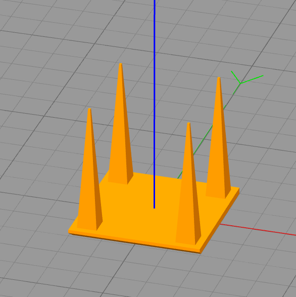

This is one of the tests I have tried to print and there are strings on all sides from top to bottom.

6mm retracts on the HE280 and PLA is a recipe for disaster. It may work for a short time, but will eventually jam the hot end. For the purposes of retraction, the HE280 should be treated like an all-metal E3D.
Try moving your Z-lift to 4mm. Also make sure you set your Z axis speed to 200mm/sec. Set the retraction speed to about 35mm/sec.

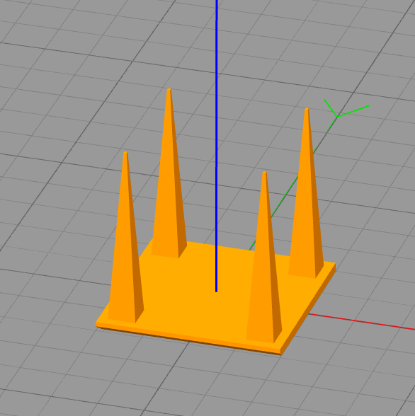

I'll give that a shot. Here is a picture, although blurry, of the stringing I am getting.
Screen Shot 2016-11-21 at 10.32.14 AM.png (59.97 KiB) Viewed 11384 times

Start with 1mm @ 20mm/s.
I would not exceed 2mm.
