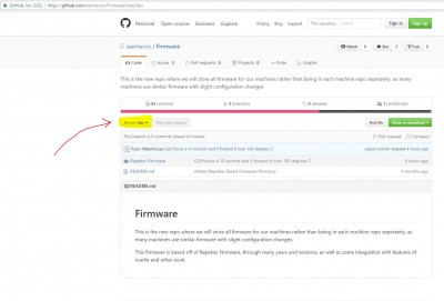

3) open the new DEV downloaded from github.com/seemecnc in the arduino editor

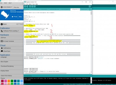

4) for Rostock MAX v3: make sure the PRINTER 5, MOTHERBOARD 301, and POWER_SUPPLY 2 are selected. Change nothing else anywhere, I don't care what you read on the forum.

Please share results here if you are going to try it. Eventually, DEVelopment code will be merged into the master.

If I have a max v2 with probing board what are the correct values for printer and Power supply?

With my he280 upgraded Rostock Max V2 do I need to invert the Y motor like all previous versions? Also I have 300mm arms do I need to change anything for them?

DerStig, yes the orientation of the Y stepper is different between the V2 and V3 - this is a configuration option, not a firmware thing. So you will need to invert Y.
And yes, you need to change the diagonal rod length, the auto calibration does not calibrate this and I assert it should not. The way to set diagonal rod length properly is to get the rest of calibration correct then test print. Use the X-Y dimensions of the test print to calculate the diagonal rod length. Check my V1 build thread or blog for info on how to do this scaling. Trying to calculate this value without an actual reference is not a good idea. The Open DAC stuff used to do this and I think it still does. Don't use it or follow up with a known test print and check dimensions as per my blog.
