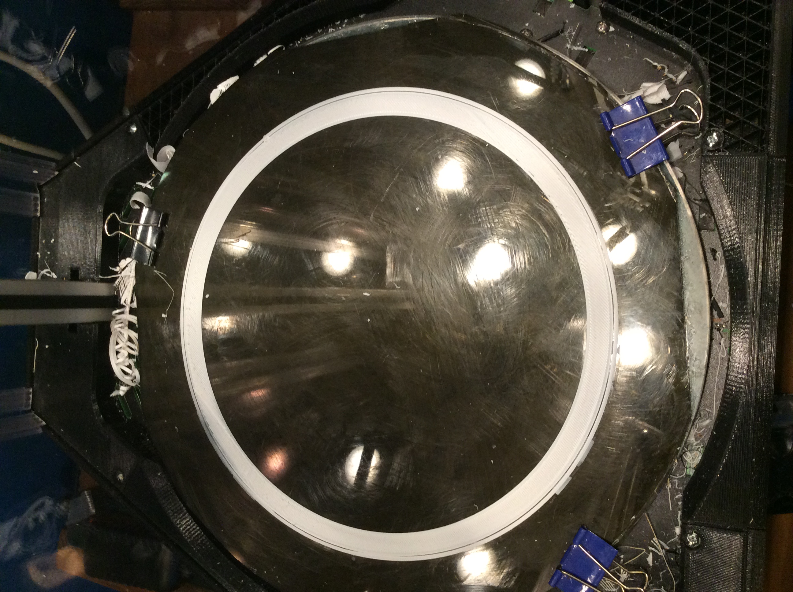

				Got the calibration dialed in, as far as the bed goes. Didn't take that long, but i haven't had a lot of time to work on it :-/. The ring reaches as far out as i can print (limited due to het enclosure)
I've already got the temps checked with a thermocouple.. but now i'm printing a temperature test to see what the best temp is for my abs, followed by a retraction test.
