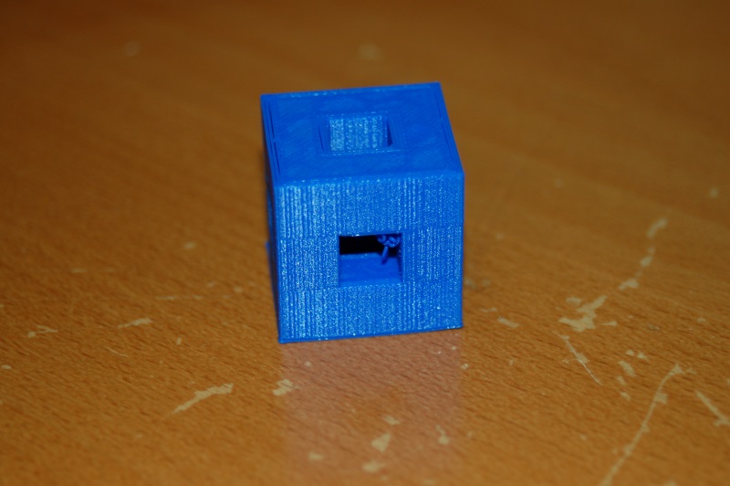

[img]http://www.geneb.org/rostock-max/50-micron-cube.jpg[/img]
50 micron layer height, 0.5 nozzle. Printed that on a v1 in 2013 and took two and a half hours.
I wouldn't do it again with anything larger than a 0.35 nozzle.
