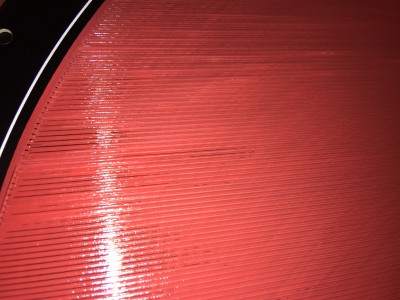

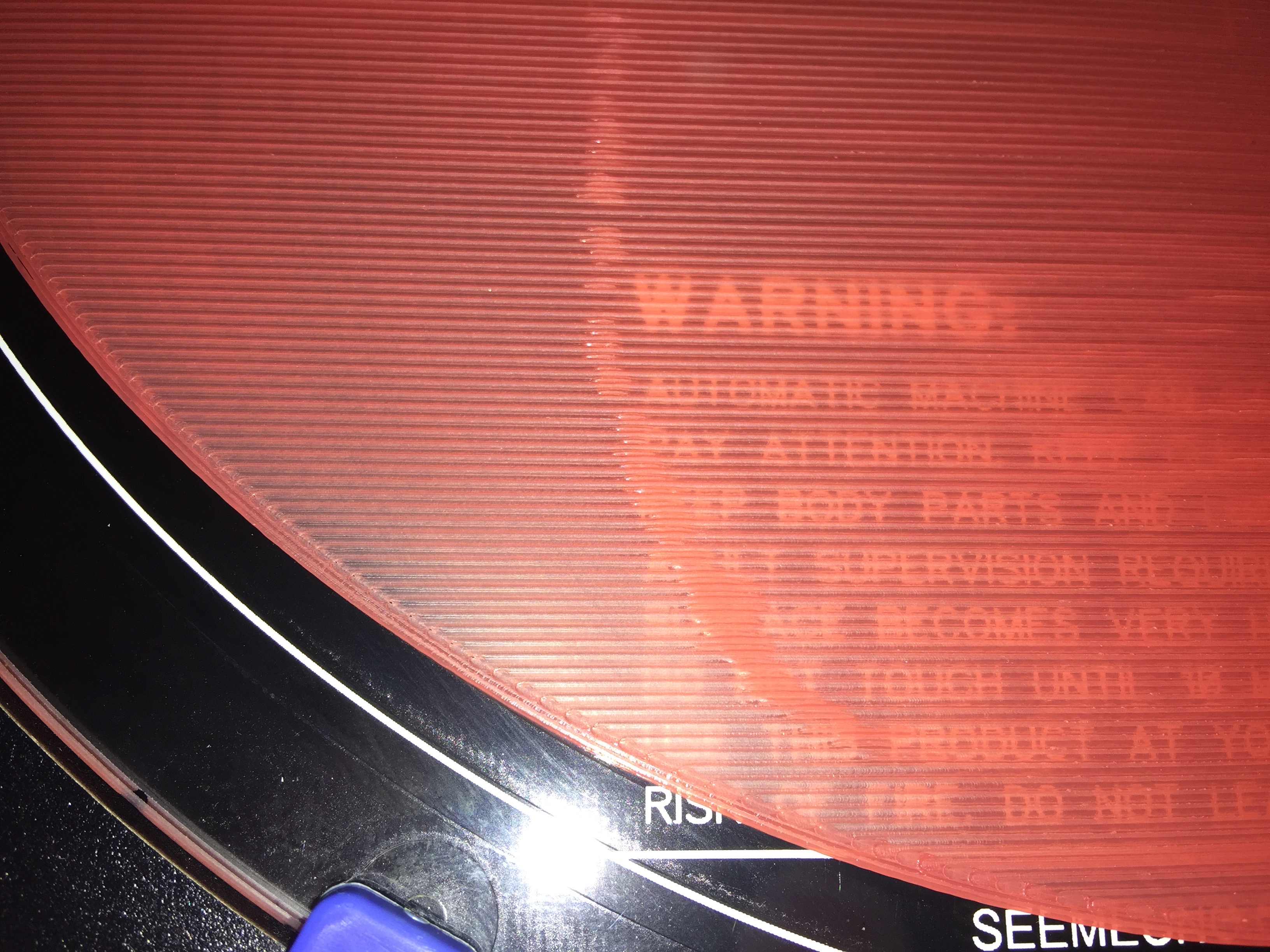

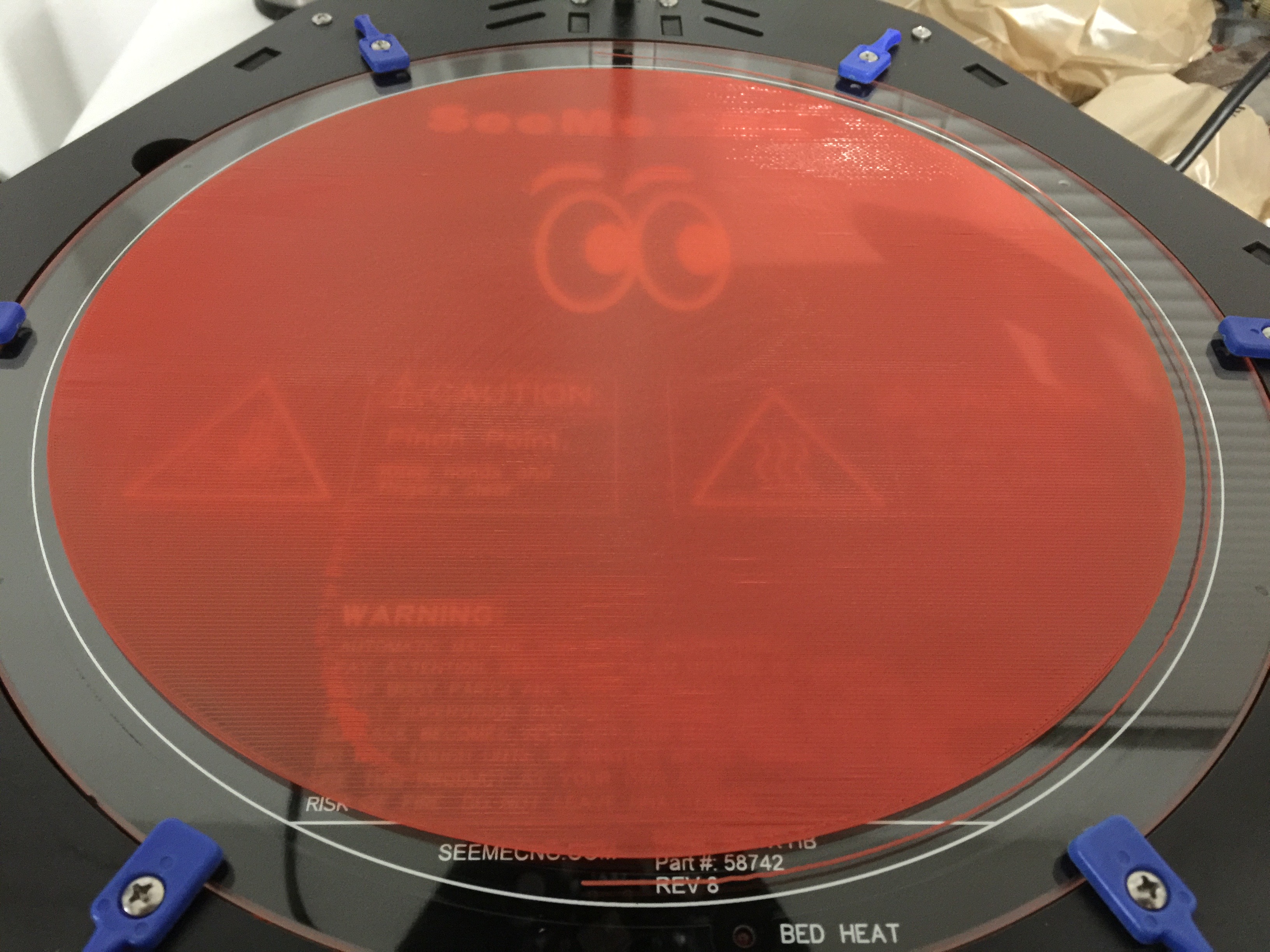

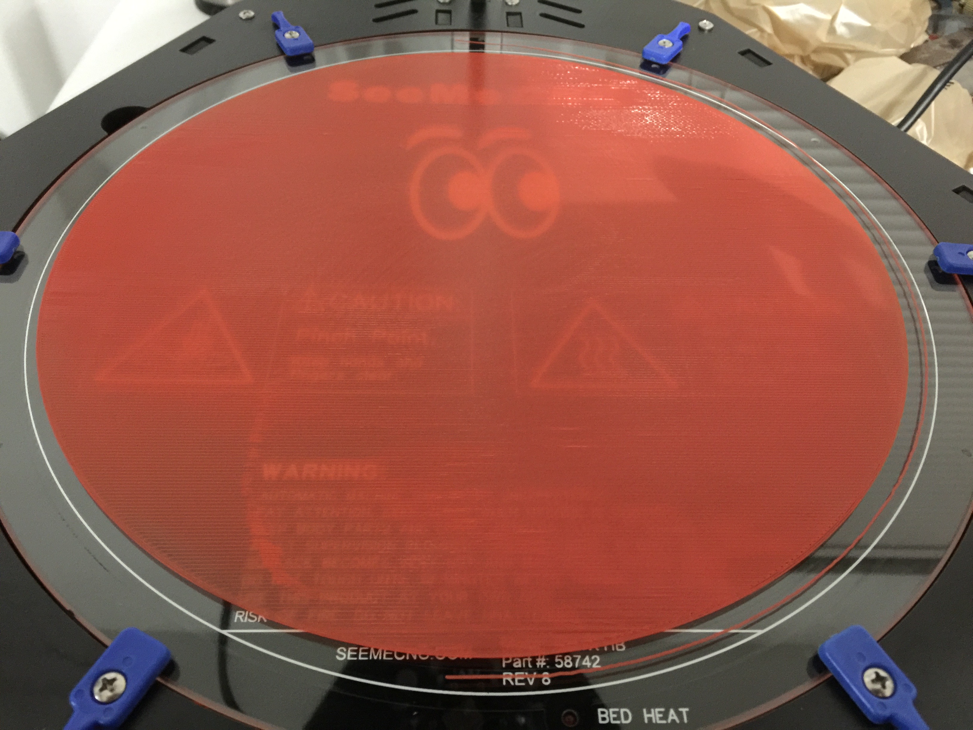

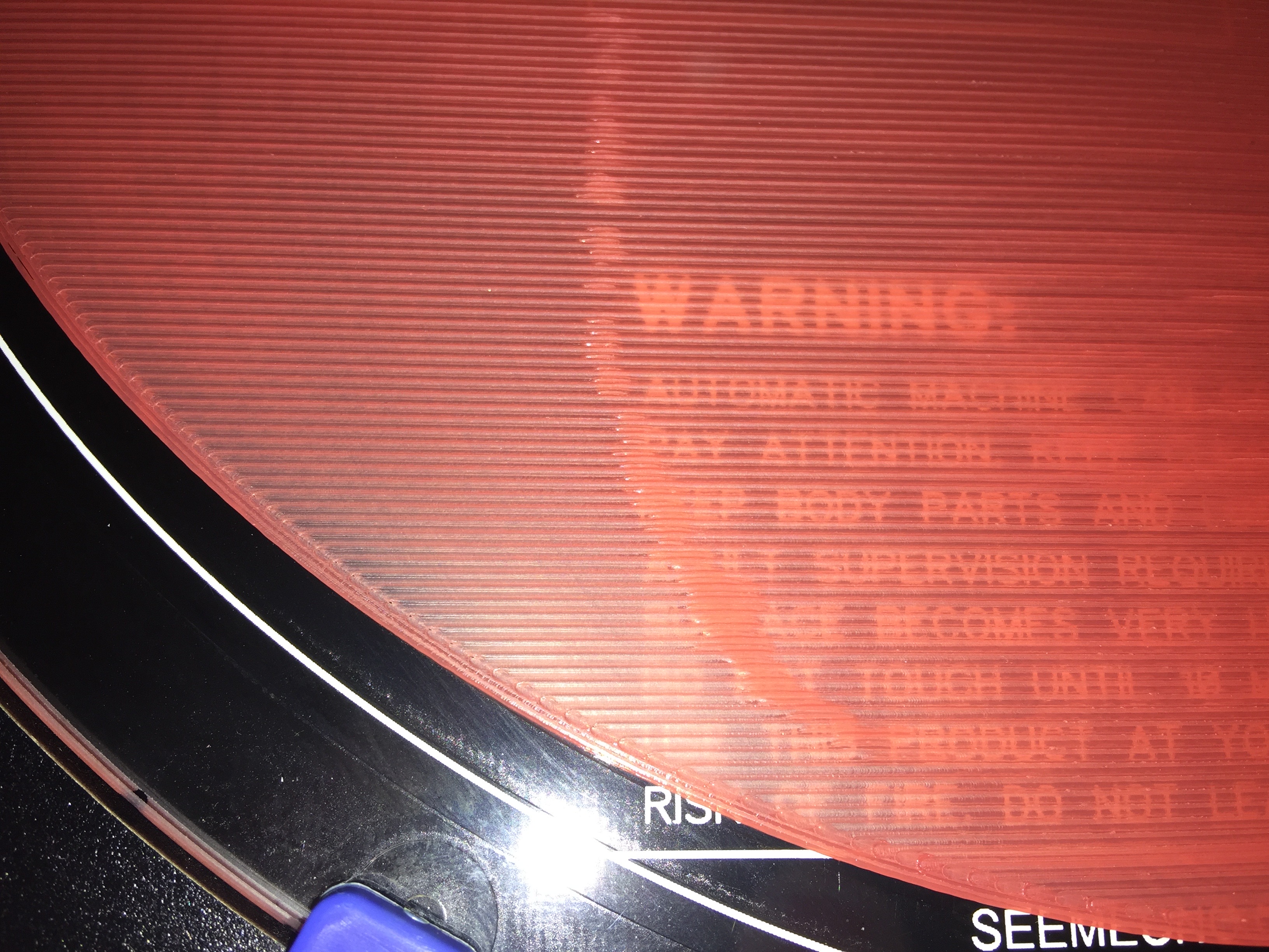

WOW! After getting the new firmware & OctoPrint plugin working, you can see the great results in the pictures. It's a single-layer 270 mm diameter disk. I still have a few slightly high and low spots, but overall DC42's least-squared calibration routine has made a MASSIVE improvement over what I had before (you can see my post in the Troubleshooting forum on my earlier troubles if you're that bored). The entire print bed is now usable, which was not the case before today. Kudos to DC and the SeeMeCNC crew! Thanks a ton!

@ToddZilla - and this is why I've been promoting Duet and dc42 for over a year! I've been enjoying calibrations like that since migrating. And now, to correct those minor second order "defects" David has implemented grid based compensation. It's still in beta but is working amazingly well. That will require Duet and dc42 though as it has to modify every XYZ movement coordinate to compensate. In theory this could be done on the gcode - I actually did exactly that 18 months ago with my Barycentric Interpolation Compensation. But it is soooo dependent on the slicer's output and being able to generate code that can be reasonably parsed. The much better solution is to do it in firmware like dc42 and smoothieware have done.
