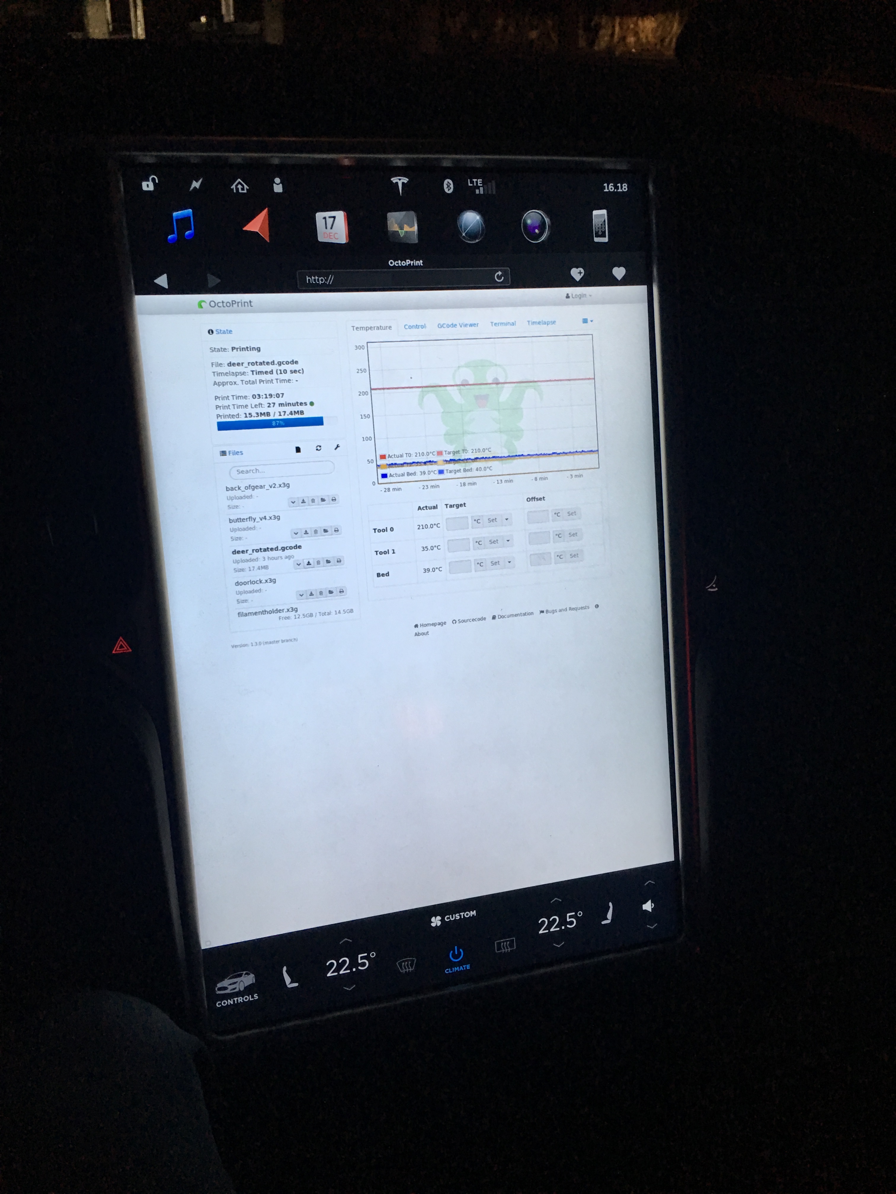

I just have to attach this geeky pic since I got the idea of getting a Octoprint setup from this thread. Took this picture in my car today when my gf was in the store :D Print surveillance!
