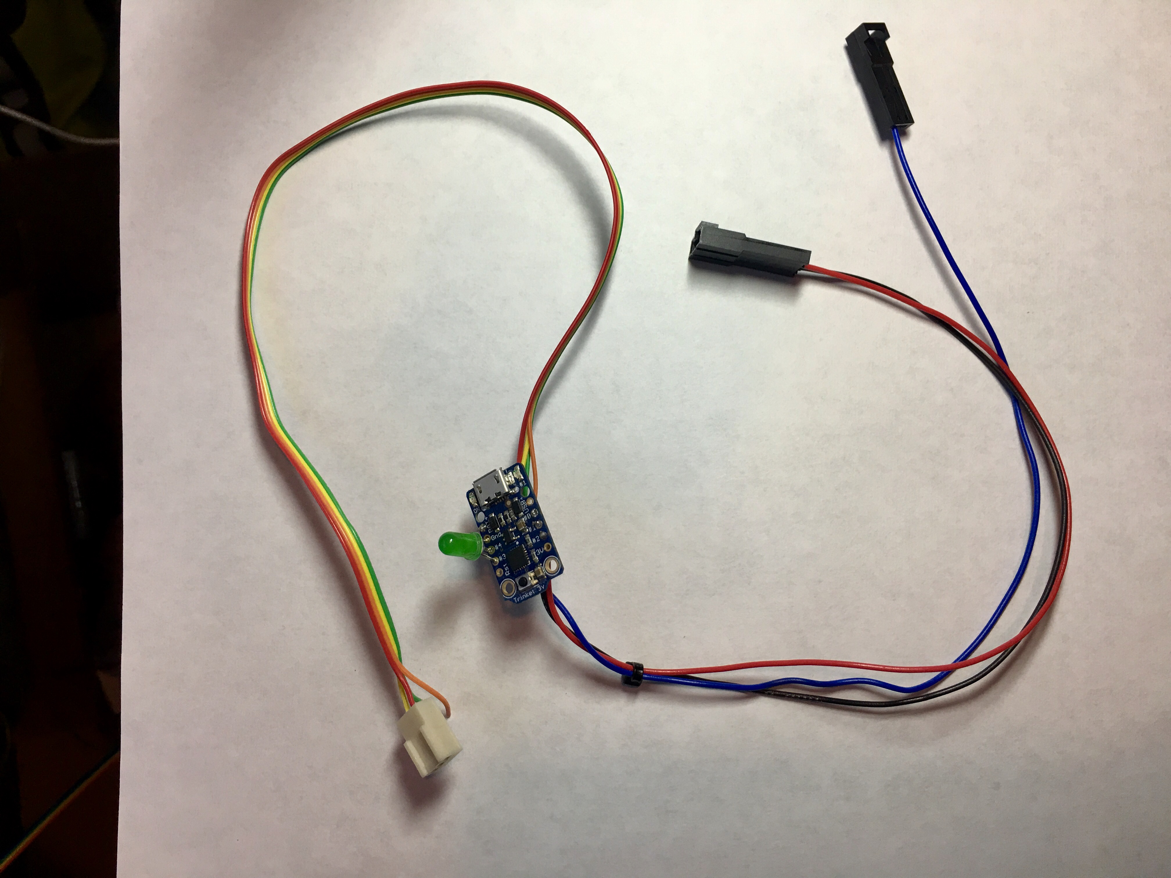

[youtube][/youtube]I know Trash80 posted his Teensy 3.2 version a few days ago - we've exchange PMs. It is good work and it did make me realize "simple is better". I had a version working very similar to his 6 weeks ago and have been using that on my V1 with the HE280. It is based on the ultra inexpensive Adafruit Trinket 3.3V that runs an ATTiny85 processor. These are $8.97 from Amazon with Prime 2 day shipping or $6.95 plus shippingdirect from Adafruit. My original intent was to take the ATTiny85 and design a custom board for it that plugs directly into the HE280 eight pin connector and reuses the 3 probing wires in the whip. While this would allow probing with the hot end actively heating, I now think it isn't that big of a deal and would be much more involved installing (remember that big piece of shrink tubing you had to stretch and stretch over the 8 pin connector? You'd have to cut it off!). So, I'm publishing my simpler, near the Controller mounted, version and be done with it! (note, I AM still working on the free-standing accelerometer probe)
Since Trash80 posted details for folks to follow first, I'll call mine Yet Another Accelerometer Adapter - or YAAA for short. I've posted all of the files on Git.
You will notice that I take great pains to document the code and configuration, that's just my nature! This version plugs into the Duet's E0 endstop port. I'll post config updates later today. You might see that there are 4 wires in the connector harness, the intent is/was to use the Duet's Probe port, as David Crocker described the other day in Trash80's thread, to configure the sensitivity via firmware. That is not yet implemented. This version does not reset at the start of each probe cycle as Trash80's does - in 6 weeks I have not had a single probe failure. It just works.

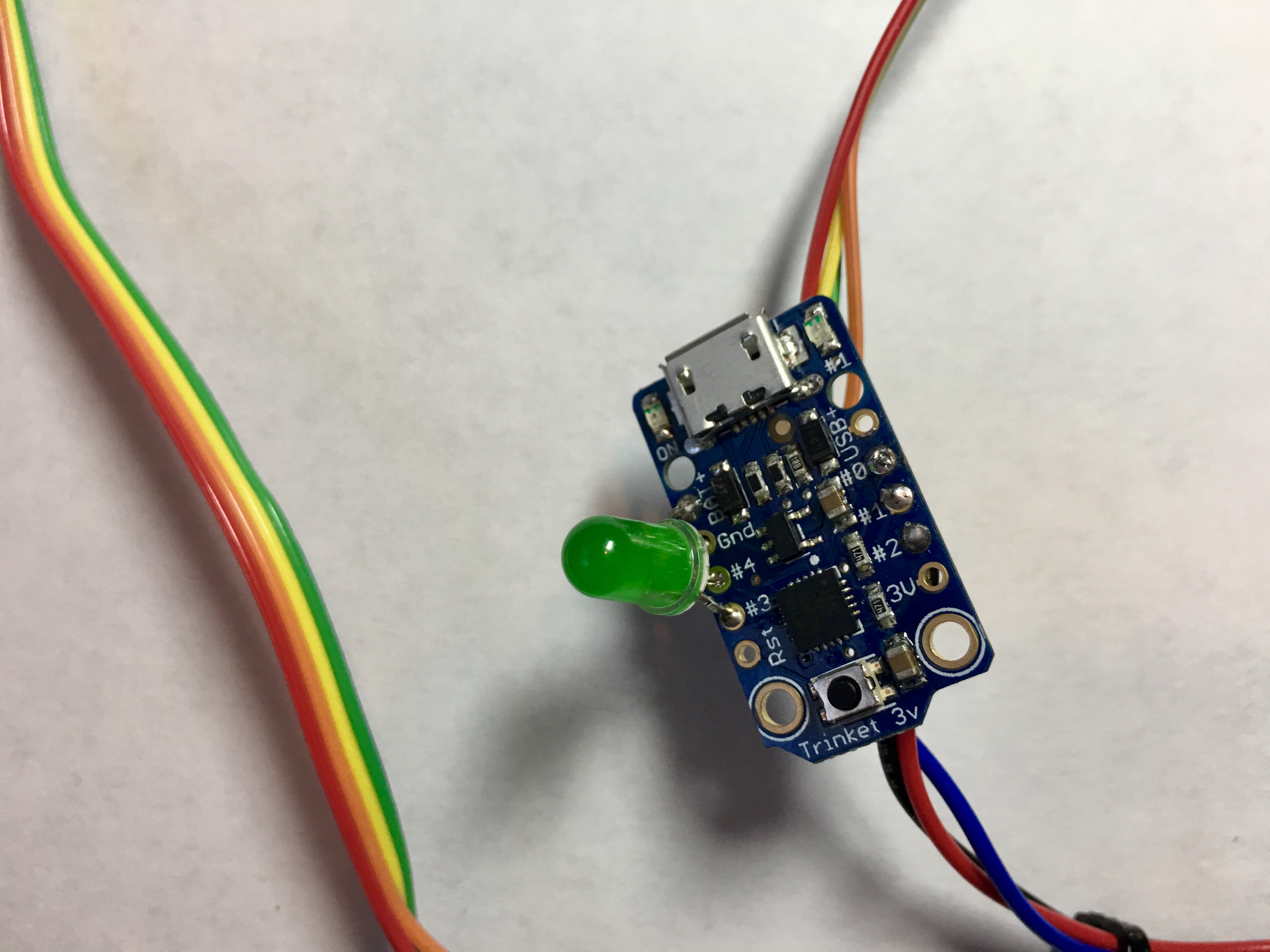

You'll also see an LED in my photos, that was a status LED so I could debug the thing. There is a little red LED on the Trinket that will flash when a probe hits so you don't need the extra LED. In fact, I need to use it's pin for the version that takes advantage of the MOD pin on the Duet Probe connector.
This version *should* work with any 3.3v or 5v endstop connector control board - like Smoothie. But I have not tested it yet.

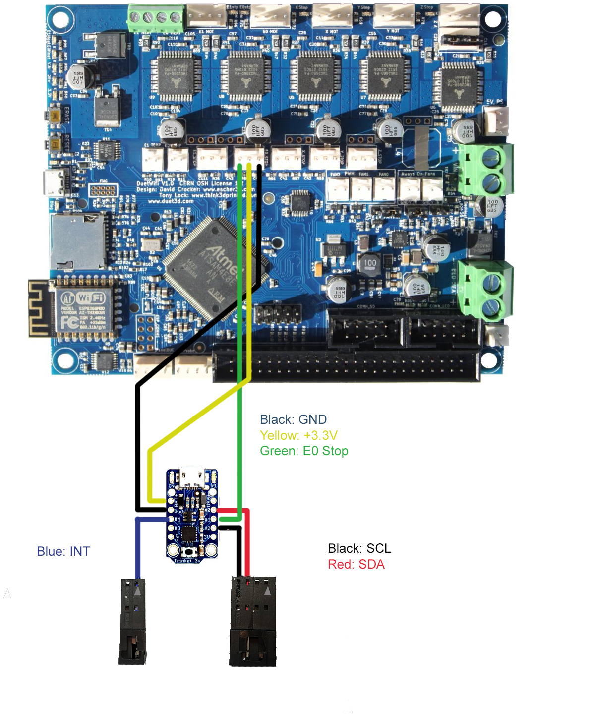

There's a bit of "hidden circuit" here, since for I2C to work the GND supplied to the HE280 must be the same GND that's on the endstop connector. And, of course, the HE280 still needs power as well. Important info for anyone with a hybrid hotend, using the HE280 solely for the probing feature.

Re: Yet another Duet-to-HE280 accelerometer probe adapter
I've updated GitHub with a drawing and support for the Duet WiFi and 0.8 4 pin probe connector. I've also done a little tuning to improve reliability.

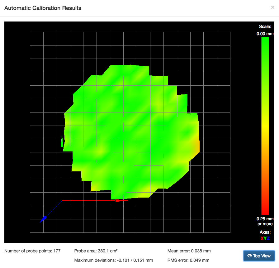

And now for some results!
G29 auto calibration
6 factors, 13 points - deviation after 0.026 (oh yeah)
Diagonal 291.060, delta radius 144.228, homed height 408.381, bed radius 120.0, X -0.374°, Y -0.512°, Z 0.000°
Endstop adjustments X-0.26 Y0.45 Z-0.19, tilt X0.00% Y0.00%
G30 grid compensation
Run this immediately after G29 without homing in between
177 points probed, mean error -0.00, deviation 0.05
And this is the height map that Duet Web Control now generates:
