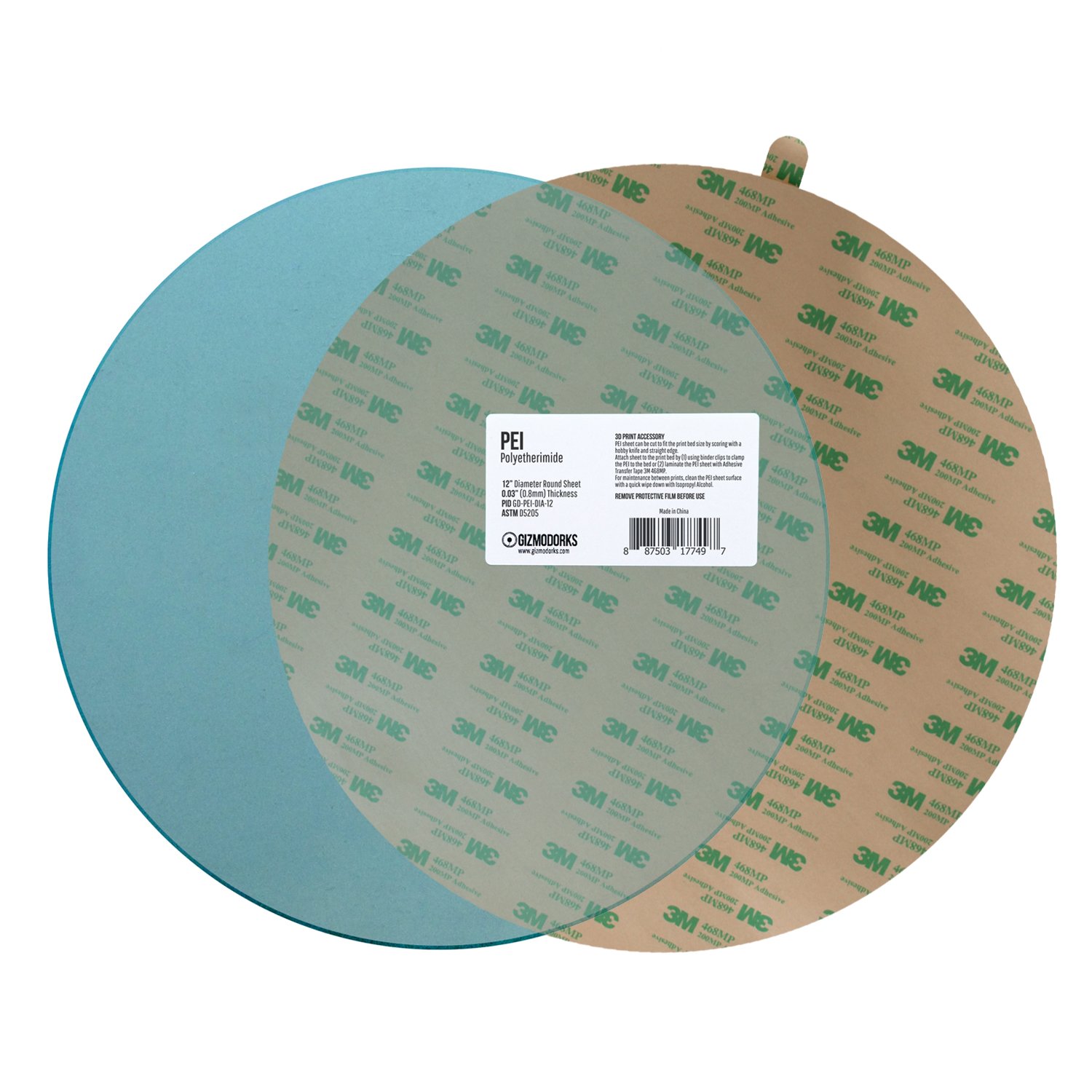

For $21, I guess I'll give PEI a try.

That's a great deal for a precut AND 3M adhesive! I'm picking up a couple myself.

I thought it seemed a little too good to be true, as well.mhackney wrote:That's a great deal for a precut AND 3M adhesive! I'm picking up a couple myself.
I've had a slab of PEI sitting around for a couple months (it's literally a 1/4" thick chunk of it) and after discovering that I couldn't lasercut it into a circle, I kind of forgot about it... For the price though, I'll be giving the GizmoDorks product a try on Thursday (love Amazon).

Yeah, mine are coming on Thursday too. Just in time to put on a new D300VS delta I just completed yesterday. Thing is a mammoth!

Aw man! I didn't see the round ones! The 12" square ones were easy to cut down into shape after installation, Ima gonna order a few more round ones for the other machines.

I like the ones I get from CS Hyde Company. You can order whatever size you want. I get them 12.25", that way it's not such a pain to center.
They are only $12.27each, the shipping that kills it, but if you're ordering more than one it's cheaper than the amazon price. I paid $21.02 for one
shipped.
Once it's set, run a new razor around the outside edge.

I don't understand you guys, the place I've linked several times is 1/2 the price, adhesive already on it (yes 3M) and you can get it cut within reason the size you want.
Re: BuildTak, GeckoTek, ZebraPlate, FabLam, what are the cool kids using?
You are likely getting the very thin 20 mil sheets for that price, right

Sorry TwoTone, wasn't ignoring you, I see what you're talking about here:
http://catalog.cshyde.com/item/3d-print ... d-d-310dia
Those will fit the RostockMax build plates exactly. I'm going to order a couple.
I also see they'll do custom sizes. I'll most likely be ordering a couple for my 400mm superkossel build.
5 mil. That is going to be prone to tearing and any bubbles when applying will telegraph through to the surface. I experimented with various thicknesses 3 years ago and 30 to 40 mil is the best bang for the buck, lasts for years and doesn't telegraph adhesive bubbles.
That's 3mil - .003". Barely thicker than the diameter of a hair. Caveat emptor.
