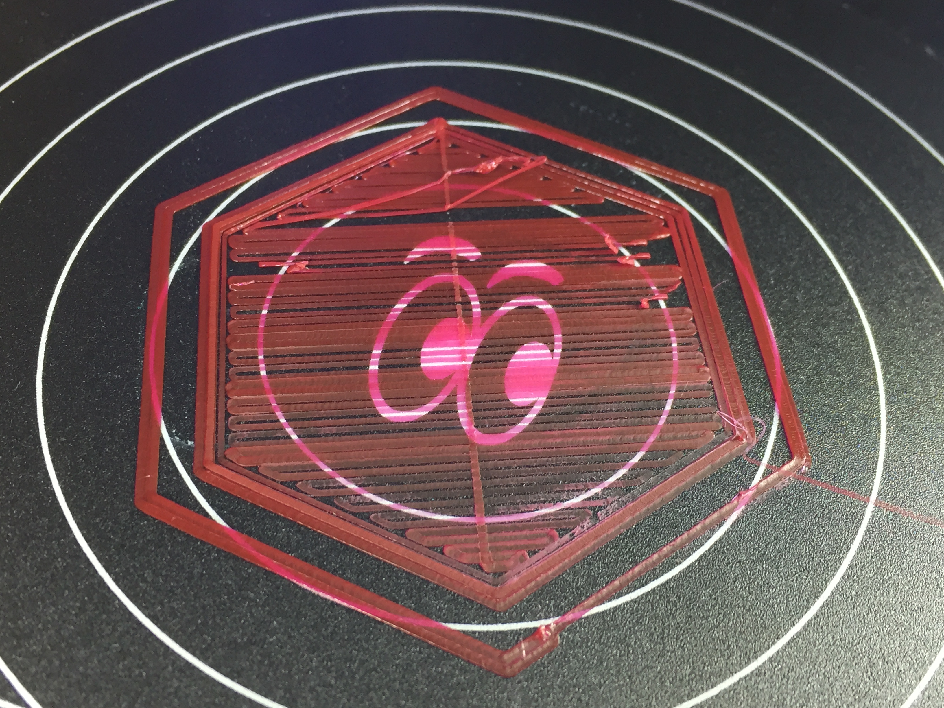

Re: Eris settings for Simplify3D?
Oh well... this needs work.
I printed this with MatterControl, and canceled it after the first layer.
The print near the Z tower is quite high, to the point where the filament is barely adhering (and sometimes comes loose)
The print head gets closer to the build plate as it moves towards the front of the machine.
Not what I would call a good first layer.
Any suggestions are appreciated.
Calibrate.
I did calibrate... several times, with the nozzle cold (as was previously recommended... or has this changed?)
I got an email response from JJ, I will take a look and see if there is something else to do.
Run the eeprom_clear program, load the firmware (after setting it up for the Eris) and then run G29 to calibrate. Turn off any "calibration" in MatterControl.
I wound up clearing and reinstalling the firmware via the Arduino method.
After running G29 results still were not good.
However, JJ suggested I try the Delta calibration wizard and that seems to have worked for my machine.
