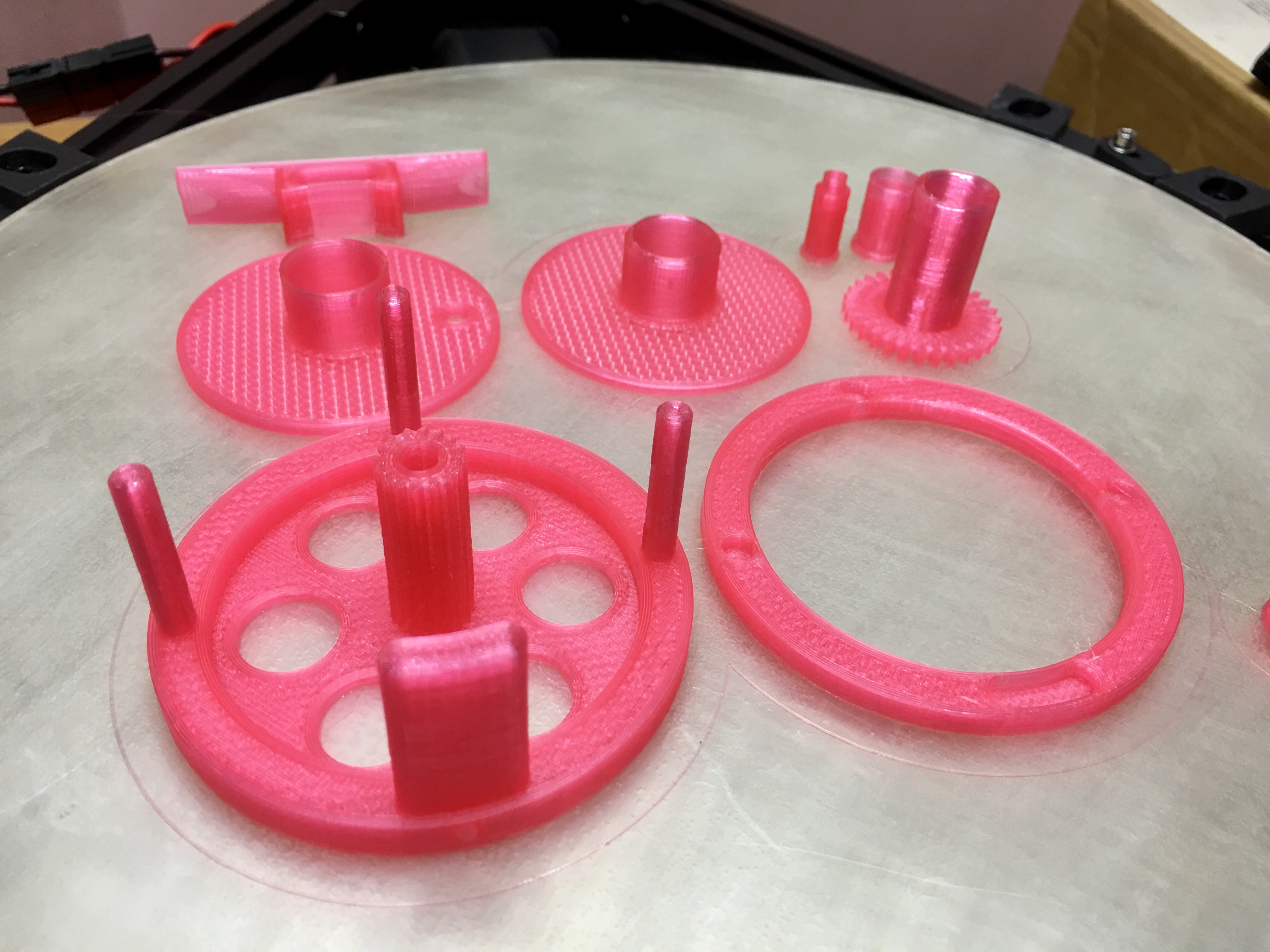

Yes, the lowest printable temp and then add 5°C for a little buffer. And yes, you do this for your system - extruder, PTFE dimensions, part cooling, etc. It all plays together.
In general it is not a good idea to use excess pressure (cold melt) to fix problems. It results in others. So I print at reasonable melt temps. What you are trying to do is get in a good region and not use too much heat. Faster printing is more challenging. You do usually need to increase temp as you speed up but this is where experience and required results come into play. I do use wipe, .5mm.
Here is a platter of parts I just printed. I have not touched any part and as you can see, no stringing whatsoever. Those thin pillars are very challenging as are the parts with the open weave and the "gear" looking part.

Thank you for the advice, it has helped quite a bit. After reading through your guides, I lowered my retraction to 2mm, got rid of my coasting settings, and have a small wipe move around 1mm. I also sped up my travel movement for non printing moves, which also seemed to help. I have almost printed through an entire roll of PLA, and the prints I am getting are some of the best I have gotten out of my printer.
I am still having a small issue with stringing however. When I print a set of parts similar to the fishing reel that you posted, I get these super fine strings coming off the parts. My first instinct would be to raise the retraction setting some more, but I was afraid of jamming again. Are there any other settings you might suggest to help with that? I know I can't lower my temp anymore. When I did that, the layers would no longer have the strength they need to stay together.
