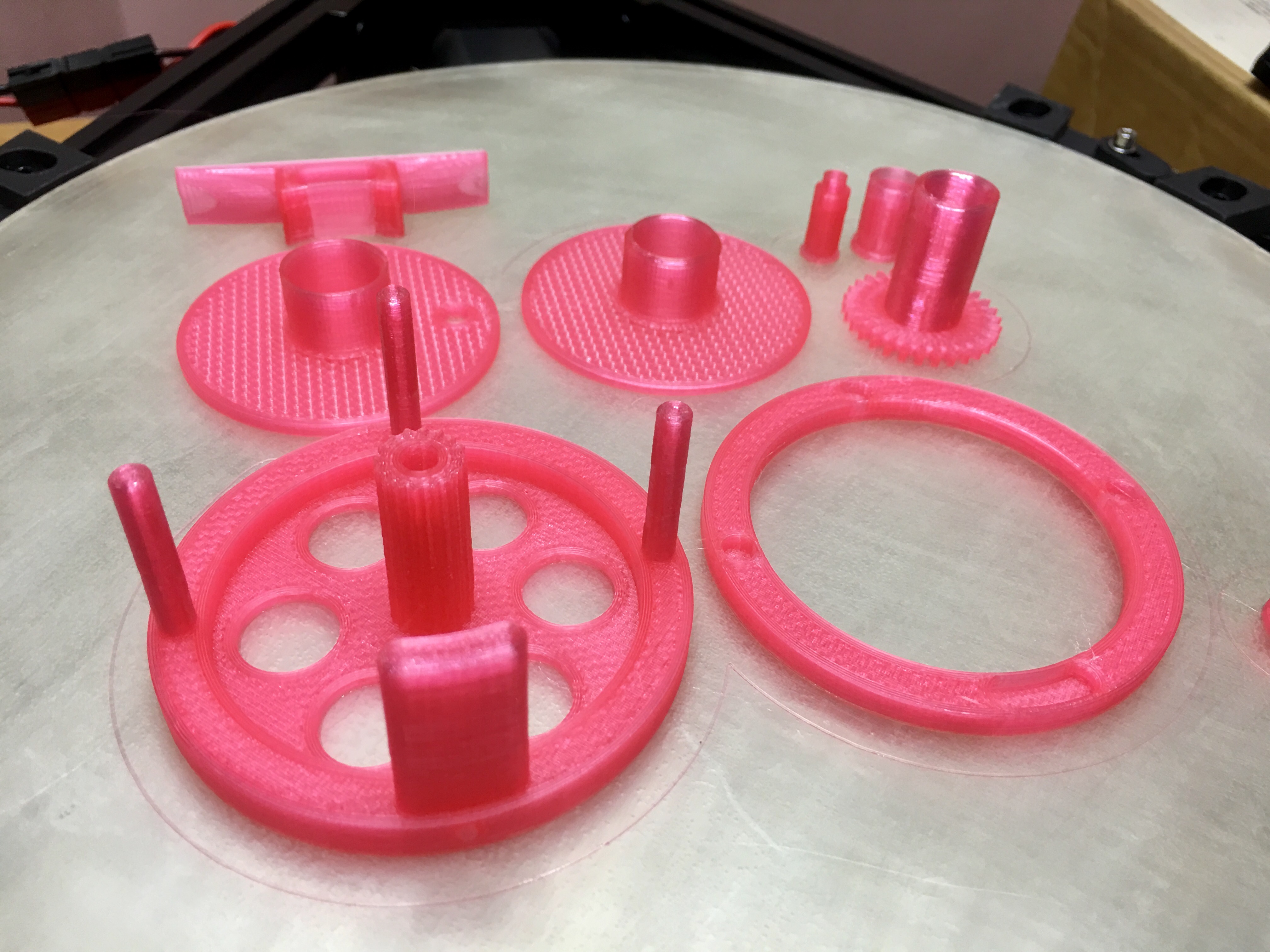

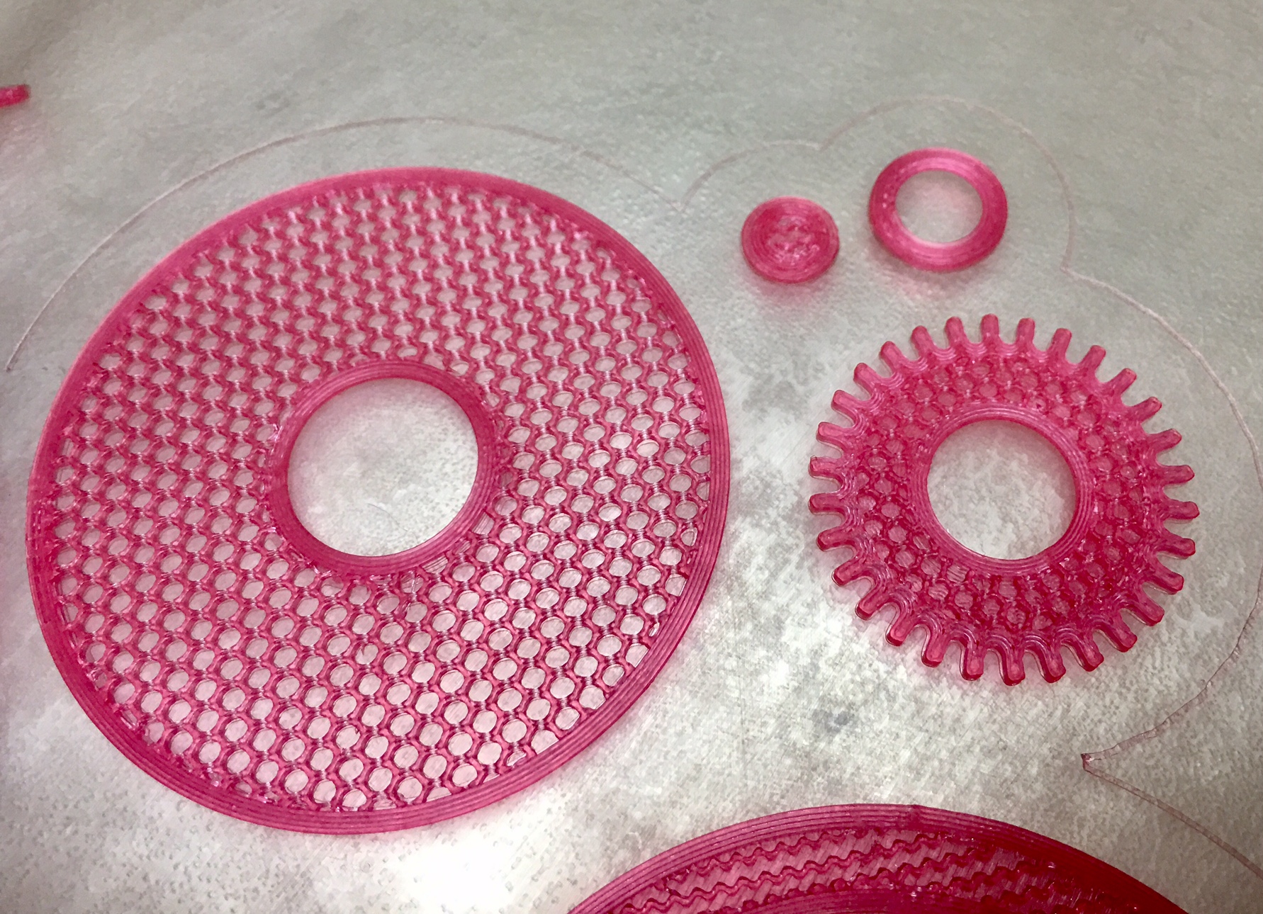

I've been spending a LOT of time testing and experimenting with the stock V3. It is a perfectly capable of machine for most users. However, I have very very high print quality standards (look at my avatar for an example of what I do). Also understand that the majority of my printing is in PLA and PLA compositions. I do work with many other filaments but my goal for this machine is to be a workhorse for my fly reel production in PLA. So, I do have a number of observations - all backed up by tests and experimental results and a few that I am still testing thoroughly. Here's what I've done and what I'm currently planning to do:
#1 completed: the thermostatic fan mod
#2 completed: a BondTech QR extruder upgrade. By far the most reliable and robust extruder and it allows me to run 1.8mmD PTFE for my Bowden to further improve print quality and retract "crispness"
#3 completed: Duet WiFi controller and the latest RepRapFirmware with the BEST delta auto calibration and grid based compensation available
#4 completed: an micro controller adapter to use the HE280's accelerometer for probing with Duet
My jury is still out on accelerometer based probing. Again, perfectly fine for the vast majority of users but compared to FSR and IR probes, there is a lot more variability between probed point data than I like. This is the one area where I have spent over 100 hours testing and collecting data. Accelerometer based probing is much more sensitive to print surface and although it works reasonably well on glass or other hard surfaces, I have data that shows that any print surface on the glass - blue tape, FabLam, PEI and others - significantly changes the probe response, ability to trigger and run-to-run reproducibility. I print on PEI exclusively so this is a critical thing for me. I've already designed a significantly better FSR mounting system and it's ready to install and test but I do still have a few more accelerometer experiments to complete first. When I say I've spent a lot of time on this, I'm not kidding. I am working with the application engineer at ST (the accelerometer manufacturer) and with trash80 (here) and sharing my data, collecting trash80's data and implementing the recommendations the application engineer is making. Things have been converging and I know enough know to know what effects changing impact speed, probe velocity and many other parameters will have on reproducibility. There is still one critical correlation that eludes me and that is the correlation between accelerometer triggering and measured probe Z height offset. Of course this is the most critical for a probe!
I spent a LOT of time with the E3D hot ends and they give my work credit on their blog for the design changes made in the V6 hot end. So I understand it inside and out, literally. I have not had a single hot end plug, failure or any other badness for over 2 years on 7 machines printing many hours per week. I have not got to that level of understanding and experience with the HE280 so I am still working away at it. I'm not sure how much more time I will put into continuing given what I currently know but we'll see.
I am also not an advocate for the "part blasting" approach to part cooling. Many commercial 3D printers take this approach because it's "easy" to get "good" results. But the stuff I do requires finesse and precision. I've written about this here and other places (check the links in my signature). I prefer the minimum amount air directed exactly where it is needed. I have experimental data to back this up as well - at least for the types of geometries I print. The BerdAir system is an excellent off-the-shelf example. I built several similar systems before the BerdAir was available. I'm using the BerdAir on all my new machine moving forward.
Steppers, once you've tried .9° steppers with Duet WiFi in a delta printer, you really don't want to go back to 1.8°. I'll likely upgrade my V3 soon.
The basic mechanics - frame structure, carriages, arms, unique ball cup joints (which are quite nice) - are all well done and really do not require any modifications.
I'll throw this photo in to show what I expect from my printers. All perfect. No stringing, no blobbing, great registration. Each one of these parts offers unique challenges that would be difficult printed alone. Being able to combine them all on a single platter takes a fanatic attention to details.

				Beautiful prints!  What type/brand filament did you use for these parts?  You mentioned PLA in this post, but these parts (at least in the pictures) look more like the PETG that I've experimented with.  So very cool...
				Re: Rostock Max V3 Build with minor mods
				Posted: Thu Jan 05, 2017 11:58 am
				by mhackney
				This is generic eBay stuff. I don't pay much attention to brand, I pay more attention to color! These are all PLA. Many PLAs are this beautiful translucent. That's what I look for when I buy. I can get good results from any PLA I've ever tried.
