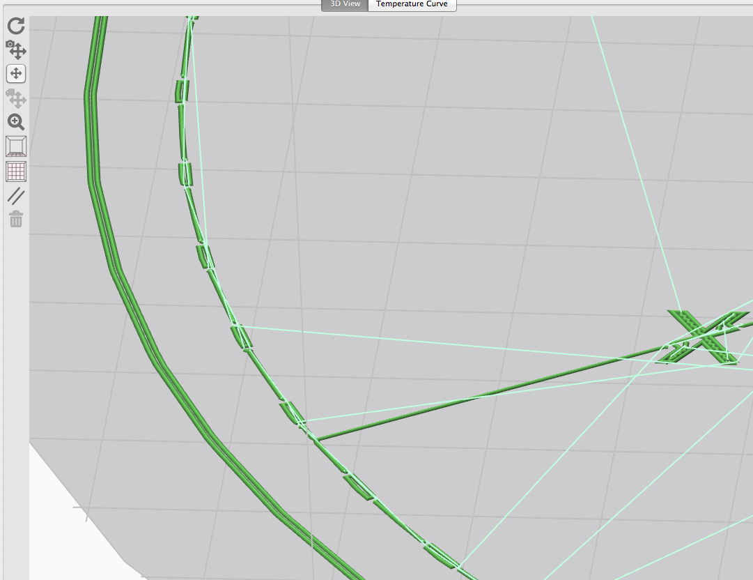

@Highcooley - I have tried printing your calibration thing and some weird stuff is happening! After it prints the large circle first (2  wide) it then prints these odd dashes where the smaller circle is, then prints some other areas and comes back and fills in those dashes. The dashes are causing all sorts of headaches. I suspect this may be a slicing issue. What app and what parameters did you use to slice yours?
cheers,
Michael
							cheers,
Michael
Re: The Ultimate Rostock Thing Collection
I see from the gcode what is happening:
Do you have a smaller nozzle perchance? Mine is .5mm.
Odder yet - that feature does not appear in your STL file! Your file clearly has 2 rings - a larger one and one about 1/2 to the center. My sliced version is printing 3 rings. The larger one you see here and another about 1cm inside that. Then the smaller ring. That smaller ring may also have another inset ring but I have stopped the print before it gets that far. Vary odd slicing issue. The radial line you see coming from X should go all the way to the outermost ring but it stops at the phantom inner ring!
Ok, I figured part of this out! The outermost circle is a perimeter not the part! If I don't explicitly set extrusion widths (to .55mm) and let slic3r calculate them (.70mm) then the circles are generated as a continuous bead and not broken up into the "dashes". I think I can print it now.

Sorry for my late reply. I was off during weekend. I sliced with slic3r, having set the nozzle to 0.5mm. I would have to check, if I set 0.55mm as the extrusion width. Anyway, I didn't have these dashes. But something other was a bit strange. Instead of printing continuous outlines one after the other, the perimeters where split up to different sections and the letters where printed separately. Although I checked the design twice, that the different parts should be merged into one single part, this somehow doesn't seem to be the case. Maybe netfabb would help. But I haven't tried it yet.mhackney wrote:Ok, I figured part of this out! The outermost circle is a perimeter not the part! If I don't explicitly set extrusion widths (to .55mm) and let slic3r calculate them (.70mm) then the circles are generated as a continuous bead and not broken up into the "dashes". I think I can print it now.

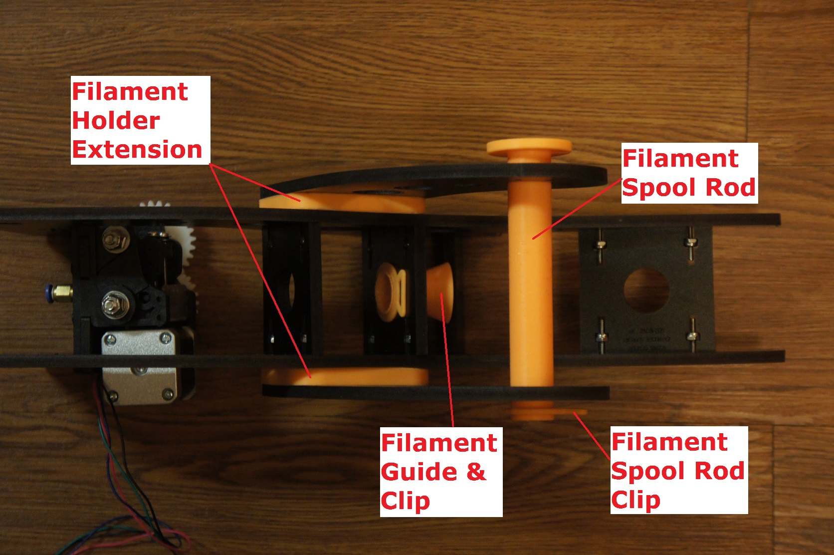

I bought some filament from RainBot this weekend.  Since thier spools are wider than the ones from seemecnc or Protoparadigm (the only two spools I've ever had), I designed a kit to widen the spool holder.  http://www.thingiverse.com/thing:60322
There are three different versions of the extensions. A single extension (you'll need to print two), a pair of extensions, or a set of small spacers to use instead of the big extensions.

Mhackney, thanks for adding it to the collection.  Here's a pic of the kit installed.

It works great too! I love the little clip that holds it in place.
I have the full extension set printing now. My add a struder kit is due to arrive today and I received my Rainbot filament today. I now know what this extension is all about, those are WIDE spools!
@AV8r RC - I really love the way the filament spools roll smoothly off this Spool Rod! Nice upgrade. I used to have to baby-sit the filament spool to make sure it didn't get stuck, no longer with this. I am printing the extended set in black ABS to compliment my white Add-A-Struder kit!
