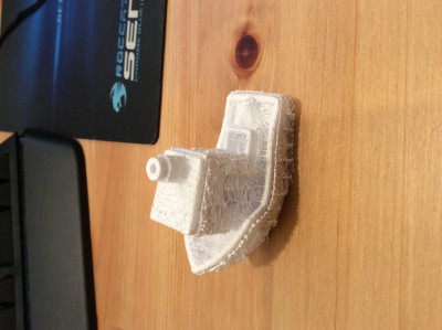

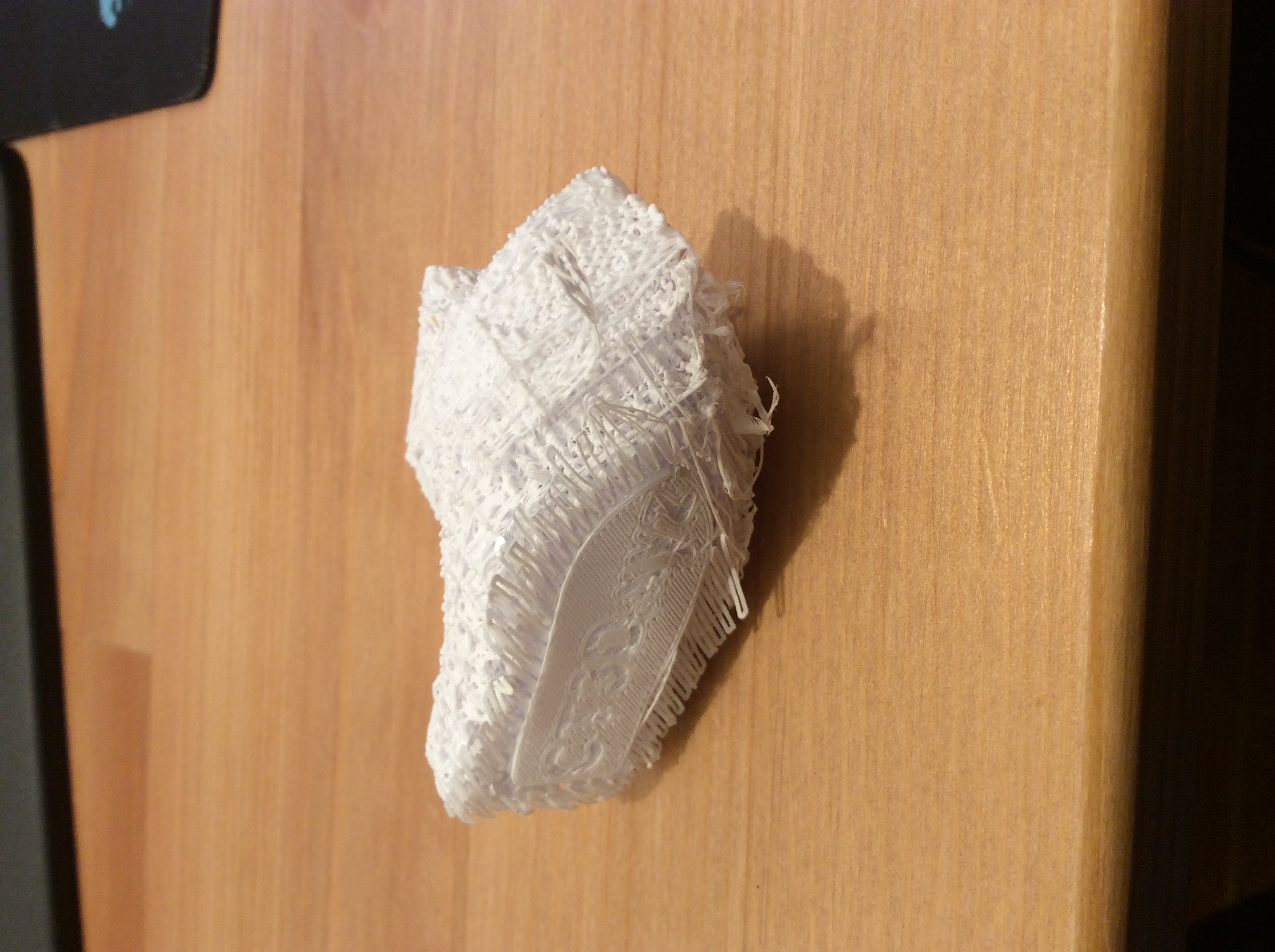

I posted a pic of what the layers look like when the extruder starts kicking back and grinding. It starves the layers and makes them tiny.

My best Benchy ever!
Also, here are some additional tests I've done:
I disconnected the tube from the extruder to the hotend and checked if I could push through filament by hand easily into the hotend with no resistance. PASSED
Pushed filament through from the extruder end to the hotend through the bowden tube to check tube resistance - PASSED
Pushed filament through the bowden tube while connected to both hands to check for resistance - PASSED
Double checked PTFE tube in the hot end for defects - PASSED
Looking at this Benchy, my first thought would be something is wrong in the hot end, but I've already torn it apart and inspected. I'm going to do it again now.

I've adjust the retract distance, cleaned and adjusted the hot end according to this
https://seemecnc.zendesk.com/hc/en-us/a ... lament-JAM
if I print small parts I don't seem to have problems but printing something larger. the first layer starts fine then it goes to pot after that.
Here you see what happens, yes its starved for filament. its making that click sound frequently during this print
You can see it started fine in the upper right of the photo is where it started printing then it went to down hill until I aborted in the second picture.
I ran about 5m of filament without the hotend and no issues noticed. th issue was after running that and cleaning and adjust above.
any idea's or should I look to open a ticket with tech support?
