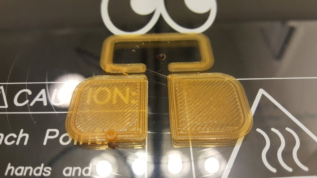

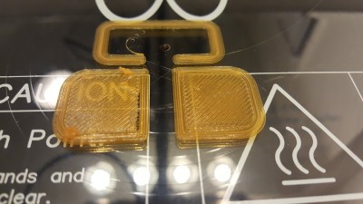

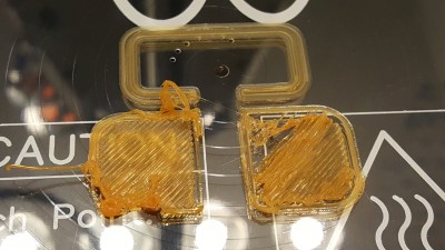

@geneb: I found 1 side had a very slight concavity to it, the other was without problem. So I marked the good side and it seemed to help some. I used a steel straight edge, and then switched to a piece of finished/highly polished) slate marble. I got it wet, and slid the glass on it from the side, covered with water. The concavity stood out very clearly (as a bubble that could not be "pushed" out), When the side with concavity was down it generated quite the vacuum when I pushed on it trying to remove it took a bit of consideration. The flat side, while it generated some vacuum did not "suck" down onto the plate when pressed. Also I do not have access to a raspberry pi at the moment, it is on my to-get list though.
@DeltaCon: I ran some tests and took some pics just to show. The first layer with auto calibration COLD, the first layer with auto calibration HOT, and the first layer with manual tweaks to the HOT auto calibration.
- AutoCalibration with a COLD bed and nozzle. Printing with hot bed and hot nozzle.
- AutoCalibration with a HOT bed, and hot nozzle (not actively heated at the time of calibration). Printing on hot bed with nozzle obviously hot...
- Manual modification to the Z-Height via the navigation menu after HOT auto calibration.
These are items with SMALL foot prints, so far I have not had issues with small foot print items changing layer height across the bed. When my current print is done. (prob an hour or two). I will attempt a larger foot print item and see how the first layer goes down over a large area. I THINK it may be fixed due to a minor imperfection in the glass. I have manually tweaked it JUST a bit more beyond the pictures, but I think I'm dialing it in.
I'll keep trying to get it straightened out. I know I'll get there. I just would like to try to get my consistency up, and not have to tweak so much between changes. I have done a couple nice prints once I got it calibrated. (last time around).
As usual thanks guys for the input and I'll keep working at it.
Matthew (TaggedZi)

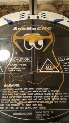

Sorry for all the "add on's" but I have tried printing something with a larger foot print at my son's request. My first print with the same settings as before, with NOTHING changed (I hadn't even moved the glass bed.) came out awful. I tried to manually adjust a bit, but that did not seem to help. So I auto calibrated twice, and ran again. When I saw the prints were coming out bad, I tried to adjust the Z height. It helped but I'm getting uneven results. One end of the bed is too far OFF the platform, and the other is squished down on to it. Here is a pic to show:
- Auto calibrated Hot bed, hot nozzle. No elements in/on or near the printer were physically moved out of place. One end is squished (z tower) the other end is to high above the plate (x/y towers).
This is the type of thing I was getting before, and it was driving me crazy. I'm going to try flipping the glass over and make sure I didn't mark the wrong side of the glass when I found the concavity... but that is all I can think of.
Matthew (TaggedZi)
