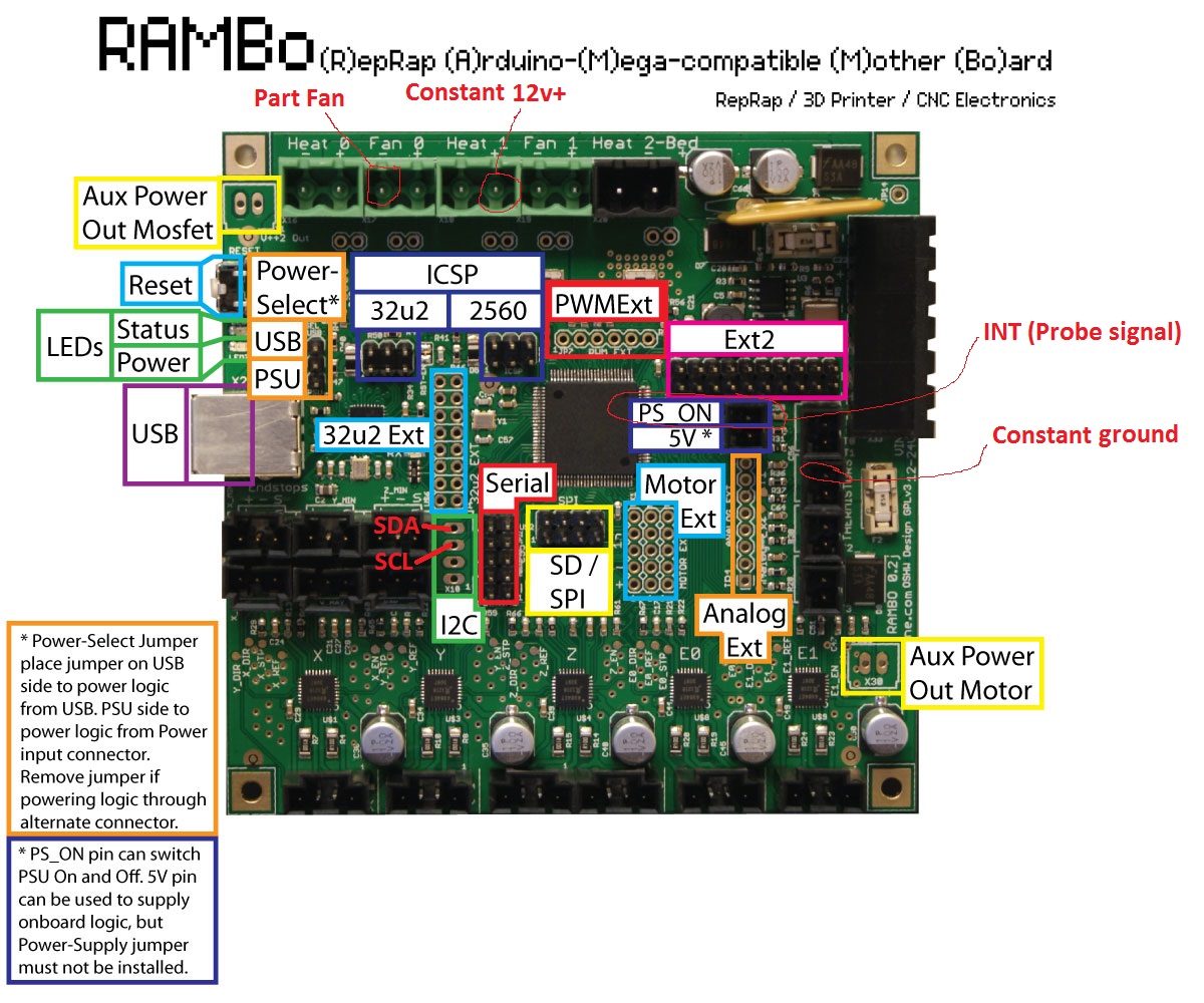

I've got a Rostock Max V1, and always found calibrating annoying. I saw the new HE280 accelerometer board and bought one straight away.
Then I had to figure out how to get it working.
The below pictures show my wiring / setup.
I have left my heater cartridge and termocouple separate, they are not wired to the accelerometer board.
Note: Thermister signal, and hotend switched ground are not connected in my setup.
Connect wires to these pins (naming matches picture above)
I hope that helps someone.
Then you can follow the guide on firmware upgrade for the V2
