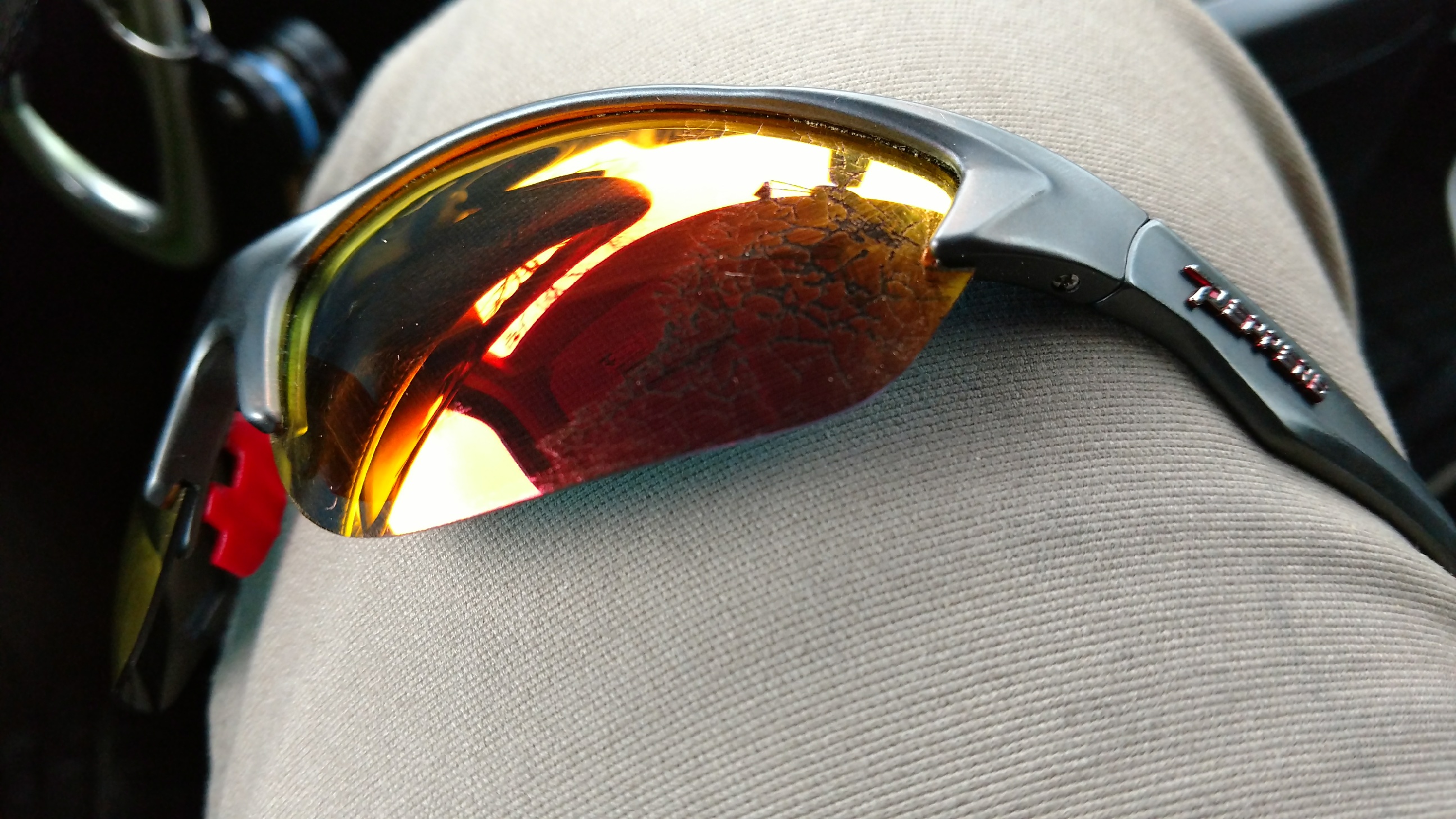

Some coolant isn't nice to sunglasses either. Walked through a machine shop to work on a computer and this happened.
