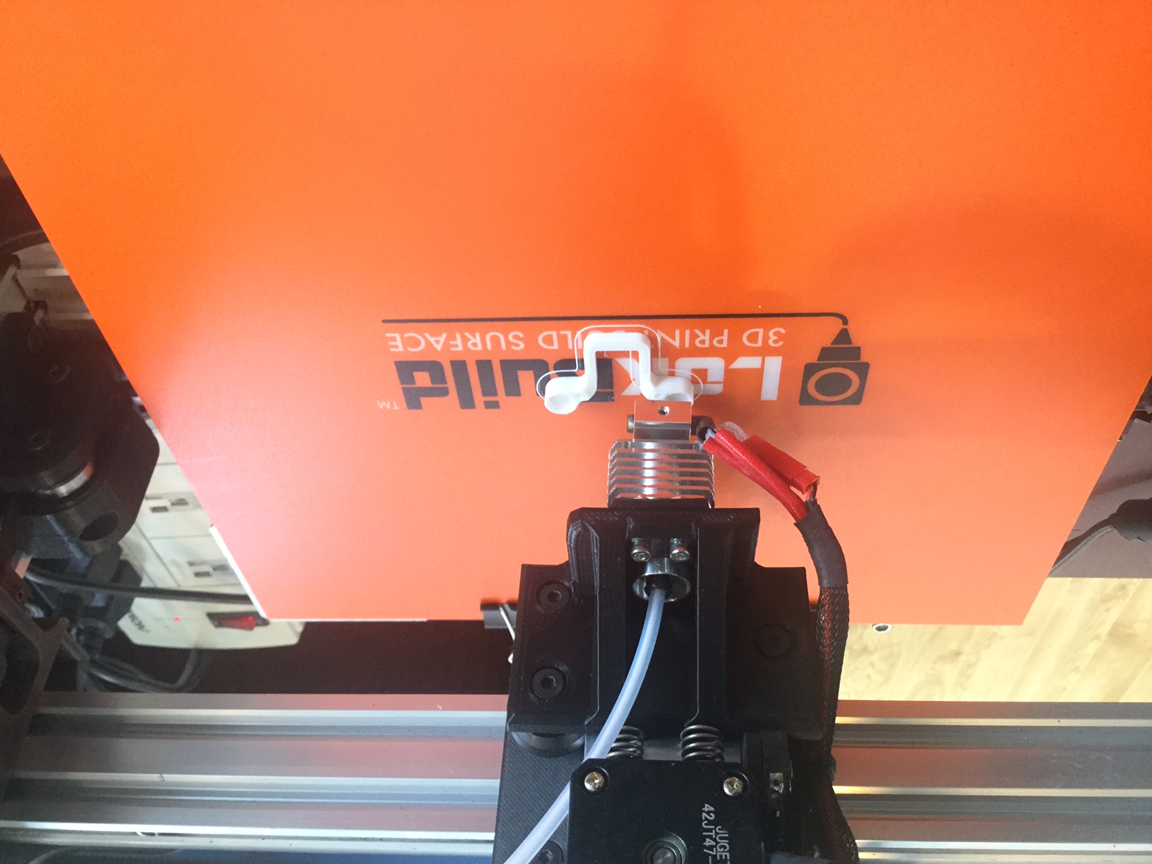

I am super impressed with this sheet of lokbuild and I don't impress easily! It is from a kickstarter campaign. http://www.LokBuild.com
PLA with no heat sticks every time and pops off with a snap when ready. I'm curious about its longevity compared to PEI.

Is it an adhesive sheet, or does it come in a plate?
Re: LokBuild - wow
It's an adhesive sheet. - sticks down quick with no air bubbles
Re: LokBuild - wow
What sort of surface finish does it have and leave on the part?
Re: LokBuild - wow
It leaves a nice matte finish. It seems to have similar surface to a thin flexible cutting board.mhackney wrote:What sort of surface finish does it have and leave on the part?

Hi Joe,
Have you used it with anything else but PLA yet?
I really was hoping it would be as close to the perfect print surface as can be, but I am hearing mixed opinions about it.

So far, after 15 or so prints it is good. Any residue scrapes off with a razor blade as would PEI.Zesty_Lykle wrote:Hi Joe,
Lykle
One problem - I use my nozzle as a Z-Probe to auto set my Z Height, so after heating the nozzle and it touches down it dimples the build surface where the hotend makes contact. Those dimples have stayed dimpled, if you will.

Ok, Love affair with LokBuild is over. Back to my 2.5 year old PEI... like putting on an old pair of shoes. The Lokbuild just isn't good enough for day in, day out printing.

Lokbuild just isn't good enough for day in, day out printing. Too much left over plastic from previous prints... Dimples from my Z probe... scratches crazy easy... TPU was unremovable and left residue even after careful scraping.. left ugly finish that transferred to next print.
You know, stuff that PEI does not do.

SeeMeCNC's Ultralex is pretty good for PLA. GeckoTek is good for PLA, ABS, PETG, TPU, and nylon (requires different surface) - but it scratches very easily, and a new disc is ridiculously expensive. Kapton tape is cheaper. Glue on glass is very easy, and once cleaned, the glass is the best surface for an automatic calibration. I think in the future, there will be some engineered surface that handles all of these things and doesn't get all scratched up if you look at it funny.
