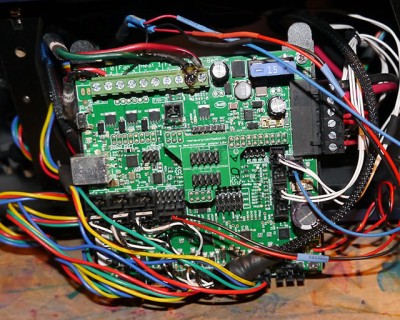

After successfully installing & starting to use octoprint on my V2 (and printing a good number of stuff) today in mid-print I see the heated bed temp dropping. This was midway through a 4.5 hour job. At that time everything else was working fine except heated bed (although I didn't check in my haste what temp the hot end was)
I took off the onyx heated bed and after optical check everything looked fine.
Then I looked at the RAMBO and where the heated bed is connected one of the leads was partially fused into the connector. It must have gotten pretty hot there. Checking resistance between heated bed wires shows they are shorted. Ok. That's fixable. But how can I verify that the RAMBO is working fully? Should I measure 12V at the red/black heated bed terminals on the board? I want to make sure that the board is ok before I put it back in.

If it was a true short, the 15A blade fuse would be blown. Is it? Remember the expected resistance of the bed is around 1 ohm, which isn't very much. Some of the cheapest multimeters might not even be able to measure 1-ohm directly.
Do a search for "melted connector" if you want to find other cases of this in this forum...you aren't the only one. There's a lot of current through the bed connector, and poor connections will generate enough heat to do damage.
The positive (+) terminals on the bed/heater/fan outputs are all connected directly to the red input line, via the blade fuse. You can do a continuity check on those.
The negative (-) terminals are connected to ground via the mosfets. You'll need a live board with a way to operate the mosfets to test those.
But yes, when the associated mosfet is 100% enabled, you should be able to measure the input voltage between the two pins on each output.

15A fuse is fine
Looking at the trouble spot it looks to me as if the red and black wires which feed the bed heat are getting pretty hot during operation and over time weakened the insulation enough that the wires got exposed and shortened out.
Re: Rostock Max V2 heated bed short
Posted: Tue Feb 21, 2017 8:33 am
by joe
Were you using the right gauge of wire for the heated bed? It looks like the hot end wires are the thicker gauge as indicated by your photo.

A loose connection will cause arcing, and that will heat up and melt a connector like this as well. Anytime you're in there, it's worth making sure that those things are snug.

Arrrgggg.... Just had the same bed heater connector meltdown. I haven't had my Max V2 opened up since I installed an HE280 upgrade in September. Lots of printing since then with no issues. Suddenly today a few minutes into a print theres an ugly burnt electronics and plastics smell. I went over to the printer and it was still going and everything looked fine. No smoke, just a really bad smell. Canceled the print and opened it up to sniff around. Found the melted connector.
Ugly burnt heated bed connector

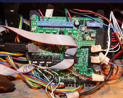

Well, I just happen to have some screw terminal connectors that were the right size so after a couple of hours of swearing and desoldering, prying and desoldering, more swearing, prying and desoldering its back up and running with a new connector block:
New connector block
New connector block
Downside is that the heater bed wiring is just a bit too short after triming off the damaged ends. Guess I'll be replacing that wiring now...
