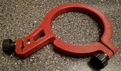

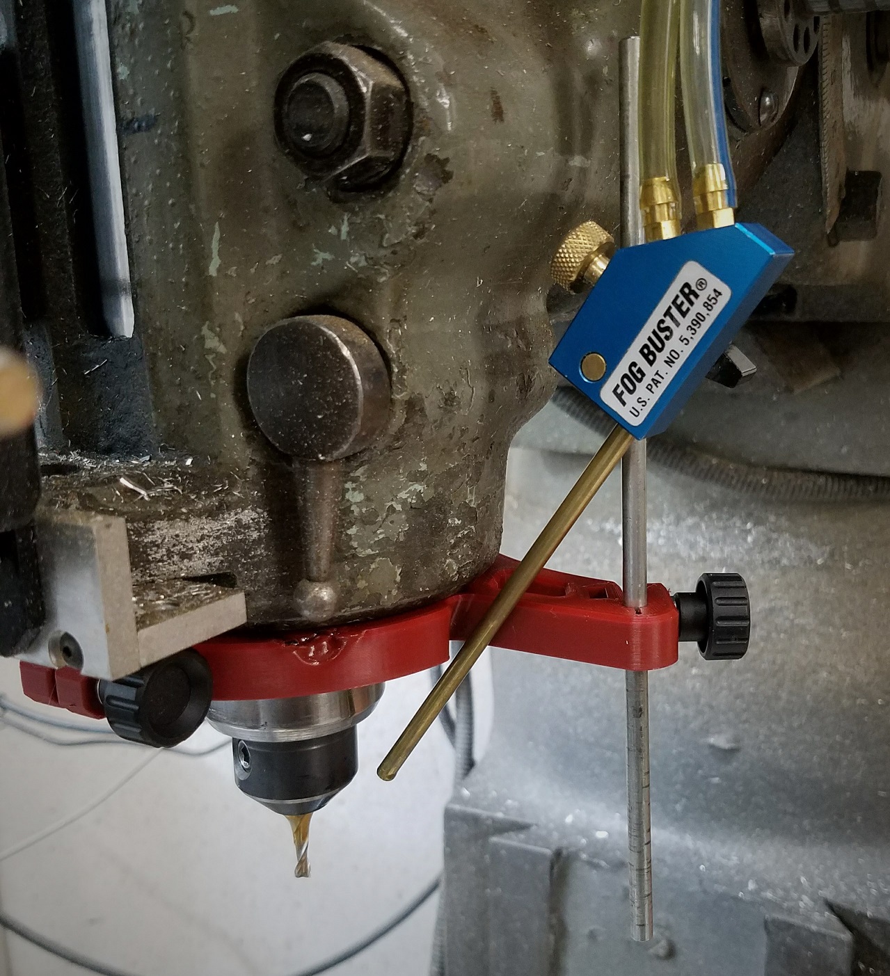

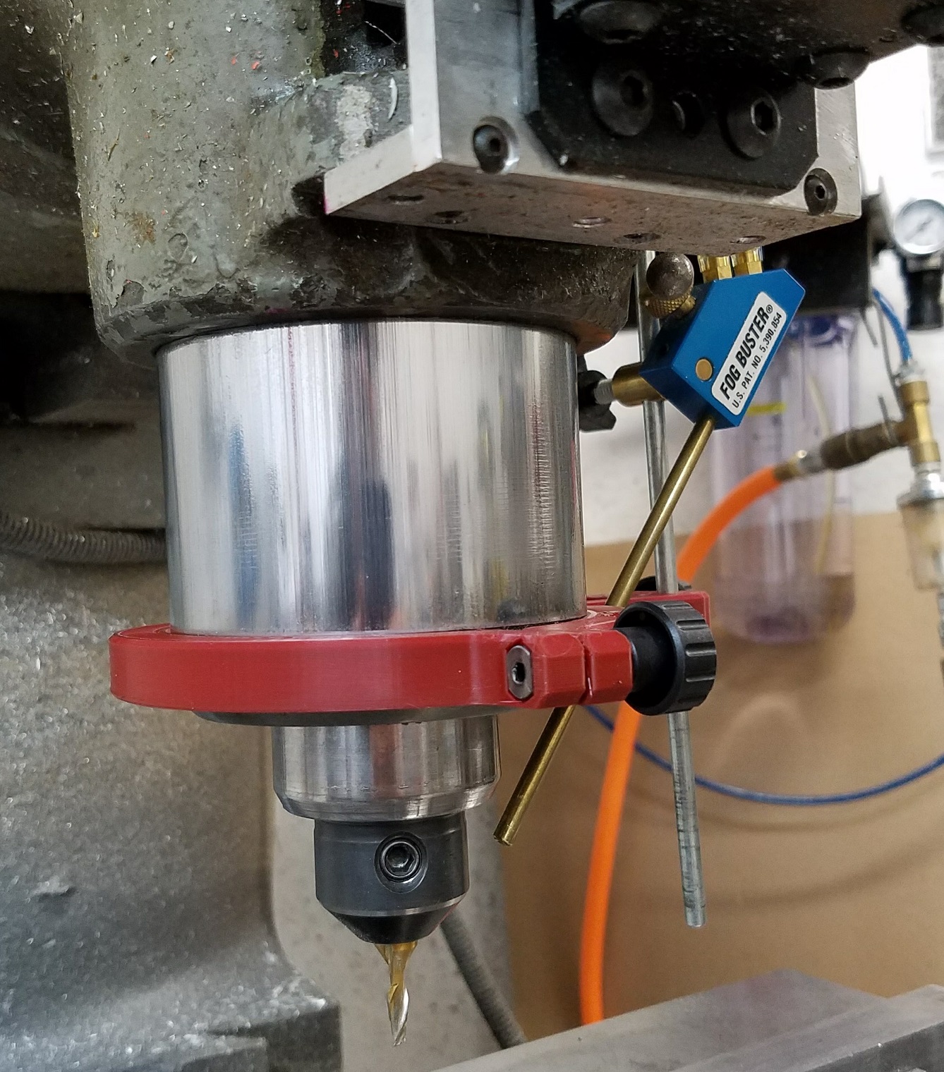

Bracket I designed to hold the Fog Buster cutting fluid mister on my Bridgeport CNC mill. Clamps onto the quill so it follows tool up & down so mist stays right on tool. It was mounted on head so it did not move with tool. Drawn in Fusion 360.
.stl & .stp files on repables.com
http://repables.com/r/826/
