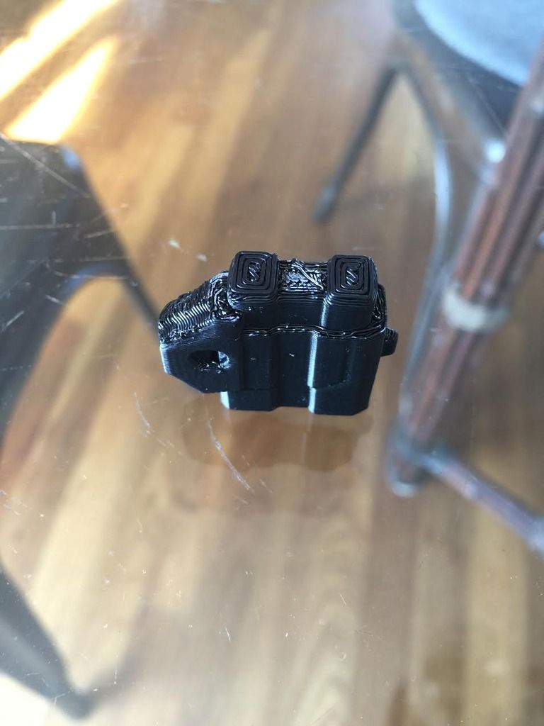

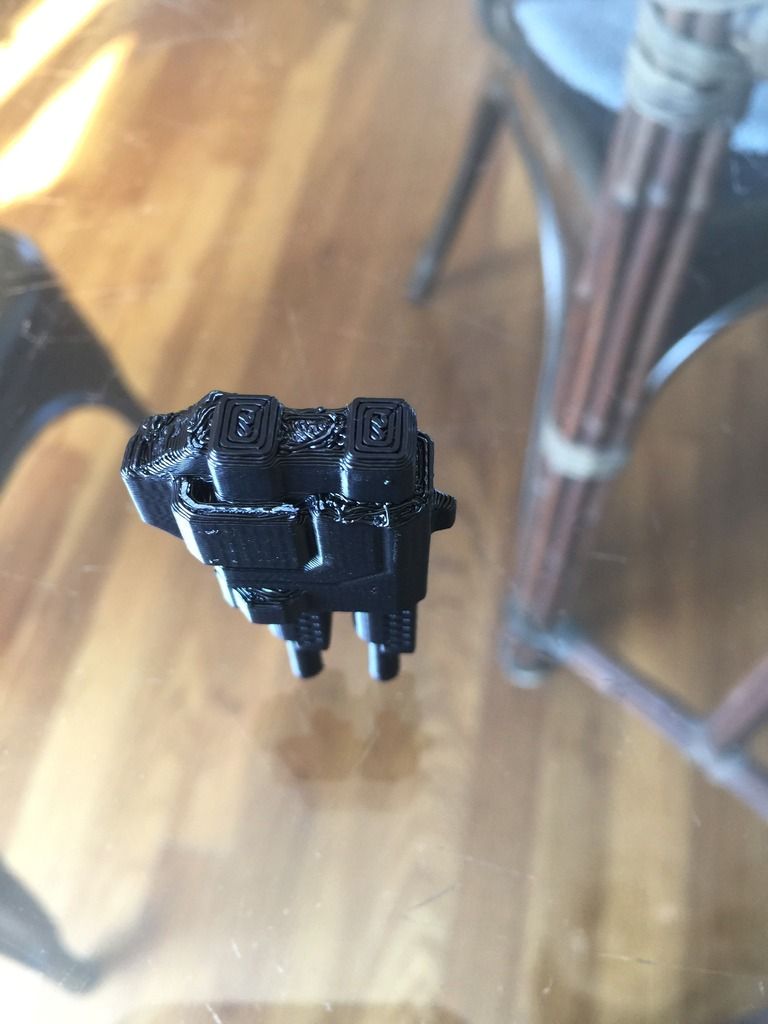

Here are the undersides of the items I printed. If you don't see the bottom, it looks great.
[img]http://i878.photobucket.com/albums/ab34 ... asers1.jpg[/img]
[img]http://i878.photobucket.com/albums/ab34 ... /narc1.jpg[/img]
Nothing but squigly, hot garbage on the bottom sides.
[img]http://i878.photobucket.com/albums/ab34 ... asers2.jpg[/img]
Notice that any overhang (all 90 degree angles) are gross looking.

Actually, I think you're really close to getting great prints!
Those overhangs are actually pretty nice considering the extreme angles. Subsequent layers are looking really smooth and free of artifacts. At a glance, your printer seems to be working great.
The only printer setting that's wrong is your first layer is too high. See those big gaps between the filament on the first layer? Increase your max z distance in EEPROM by 0.05 - 0.10 mm until you get a nice smooth finish on the bottom of the print. This might mean you have to eventually put some more effort into leveling the bed to get good use of the entire print surface, but the V2 holds a calibration well once you've got it.
Now, for the overhangs, you're up against the laws of physics here. There's no way to squeeze molten plastic out into thin air without some extra help.
Turning on the cooling fan for those bits might help some, but if I was printing it, I'd add manual supports to the model, and expect to do a little bit of cleanup with an xacto knife and needle file.
I'll download the model and see if I have any good ideas for it. I know that KISSlicer has an option to print perimeters from the inside out, instead of the outside in. I don't recall if MatterSlice does. You can see some areas of that model where the whole outer perimeter was unsupported and came out badly.
So, if the software supports it, telling it to print the inside of the model first, so the interior perimeters can help support the outer perimeters, might help a little.
Another easy answer might be to slice the gun into two concave halves to print, the way the author did with the mech cockpit/body.

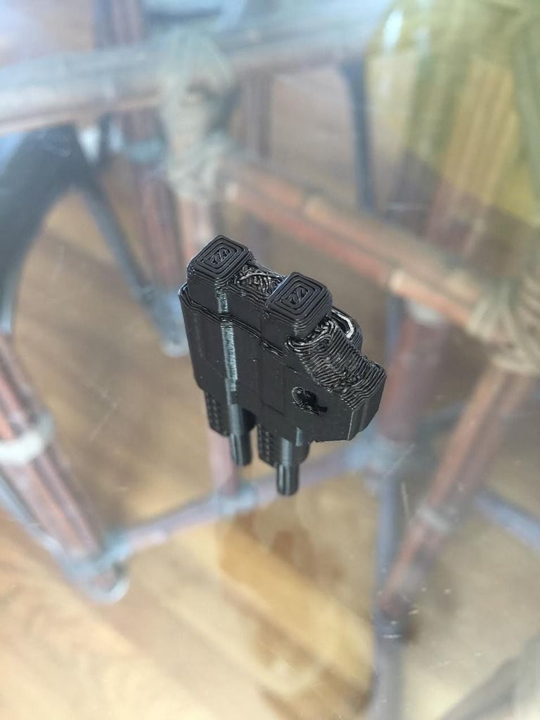

I checked the "Supports" box and it printed a bunch of stuff I had to snap off, but this is what I got.
I would love to know how to split the gun, I'm not good with 3d software. I may talk my friend into helping me. He's a tech artist for Unity so dude knows how to 3D.
gchristopher
Posts: 175
Re: Rostock Max V2 w/E3D V6 Advice?
Post by gchristopher »
Yeah, I dream of better software-generated supports that consistently solve the problem you're seeing. I know someone who did her entire Master's in Computer Science on generating supports for 3D models.
Like a lot of hobbyist 3d printing, the most significant limiting factor is the software. If I really want nice overhang printing, it seems like I need to create the support structure myself a lot of the time.
I just started using esbowman's adjustable belt tensioners for my V2, and there's a huge 90-degree overhang that prints wonderfully because they included a handmade-just-for-that-print support structure in the model STL.
