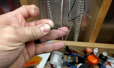

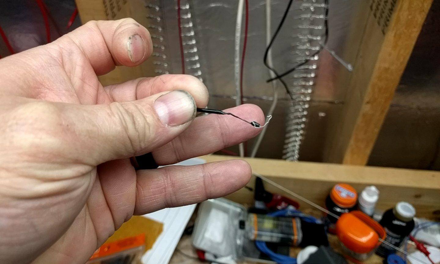

This is what the tips of my filament look like after my switch process: http://imgur.com/msU4hia
If you're getting any more of a string than the one on the far right, you need to tune your pause / retract until it at least looks like that.
