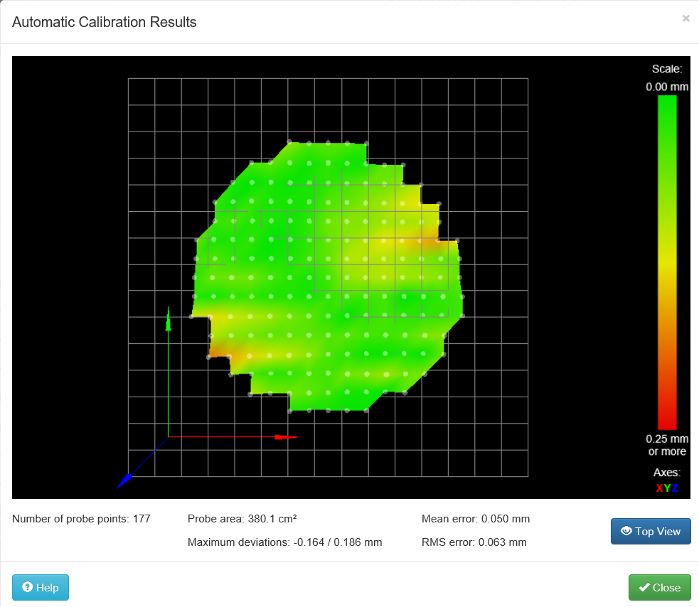

by djarmag
I used to do g29 three times before I start a print for the day. In mattercontrol, you can set the slicing engine to Cura and set the zheight offset in there. It was hit or miss everyday so I ended up upgrading to FSR probes and now my cals are within .2 deviation everytime.
