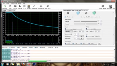

Re: Power Supply - low power output - bad Onyx heating
Mine will also only reach 80*C. Even after about two hours straight. I had it set for 100*C to do my calibration but would only get to 80* and would stay there like I set it for that. Anyone know if a stronger PS will increase it's temp?

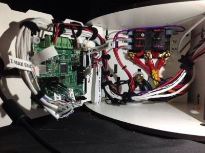

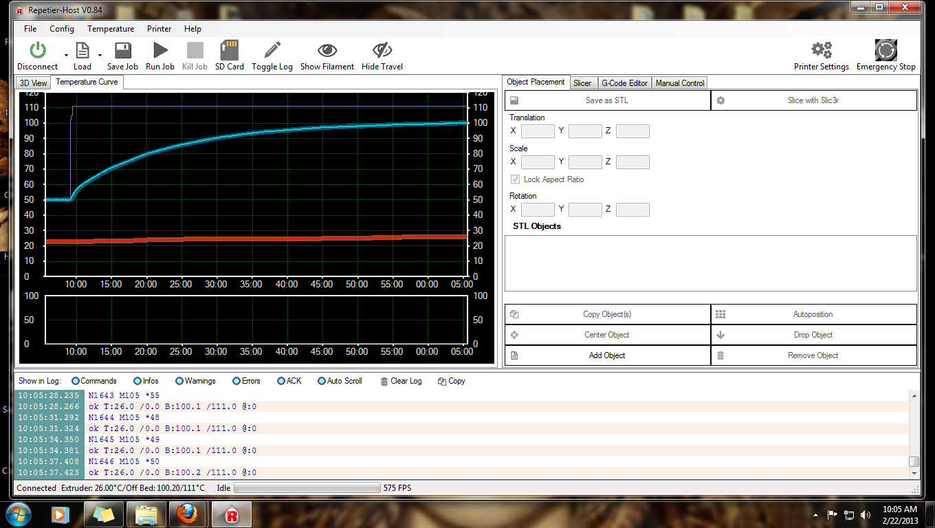

Re: Very bad Onyx heating (max 80°C)
Hey folks, I measured the output on my 12 V 30 amp supply and it is actually putting out 15volts - there is an adjustment to tune output and this one was set to it's max out of the box. The other 4 were not. This one also was set to 230VAC out of the box whereas the others were set to 120V.
So some thoughts - I am actually getting a possible 173 Watts output to the heated bed. That's about 56% more power. The other thing is, are you sure you are getting 9.2 AMPS/12V to your heated bed?
I have ordered a 24V 14.6Amp supply which should give me about 277 Watts to try out on the MAX. It should be here the first week of March and I'll report back.
Godspeed, firstly, I don't think there are any major issues with the Onyx. This is a LARGE heated surface! It actually works fine even with a lower voltage supply. Heat-up time is long but that's a lot of area to heat. I'm already running at 15V and 11.5Amps and it has no problem with that. I'll check in with Steve and John before I try the 24V supply and report back here.
I am not saying anything is wrong with the Onyx at all.
Anyway, Steve was very up front about the heating times when I ordered my Onyx and said since he designed it for 12v (due to the standard 12v power supply) and it was larger than the Phebe, heating times would be longer. I think he actually said it might take 10 minutes or so to get up to operating temps.
I think though that having your heated bed at 80C after more the 30 minutes might indicate something in the build is different.
What is interesting to me and to others is how exactly your machine is heating the Onyx faster. That is a good feature we would all like to emulate consistently without damaging our printers,
I have two 18 gauge wires for each of the (+) and (-) connections to the RAMBo. You can see them in my build thread I think. Nothing fancy.

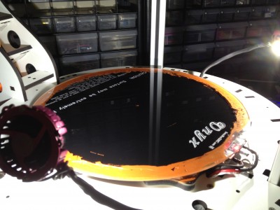

Here is a solution i attempted to fix this problem using mineral oil.
Note: I also have the v1 onyx plate with 10ga wire then i knew ahead of time that the glass was too big but i bought it anyways. I knew i would get something to work.
I figured your grabbing more heat being released through the top and now i have my glass leveled and suspended on high temp caulk.
however heat being released through the bottom of the pad is killing me.
* It seems to heat up faster than what some claim but i think the bonus here is it can hold the temp longer if you wanted a slower cool down
* The glass is not pressured down in pressure areas. Just flat, as long as the heat dont warp it inward or something. The mineral oil in the sealed environment should prevent that.
* Eliminates hot spots on the glass.
IDK it was fun let me know what you think.
********keep in mind before you attempt this im not even sure if this method is better, also the flash point of mineral oil can turn into an instant fire once it reaches a certain temperature. The sealed heat bed helps change the flash point but lets say you slam into your glass and break it and have high temps on your bed could be an instant fire, or burns on skin, eyes, ect!.
i got the cheap mineral oil like 99.5% at your common food store. Companies do make higher rated temp oil ********
also abs juice applied on cold glass grabs well, then when cooled down slides right off! but im 100% new to 3d so i cant compare with my testing.
I also may be the first one to even attempt this... I looked around didn't see anything like it. : )
maybe ill post an image tomorrow if i get time. It looks BA : )
I timed my Onyx today. With nothing else happening, it took 14 minutes to go from 15 degrees to 70 degrees C. Stock power supply, three wires to both poles of the RAMBo heated bed power connector, 12 gauge stranded wires to both poles on the Onyx, borosilicate glass clamped to the Onyx.
Doesn't seem like it should take that long. The temperature curve was flattening out so it looked like it would never get to 100 if I had tried.
- dan
- dan
Look again. : )
when the heating bed does power up you can hear the draw of current being pulled from the supply. My fans rpm change which means voltage drop.
However I don't think that's the main problem.
I'm going to put my rostock in an enclosure and will recirculate my lost heat. And vent slowly to attic or outside.
I will also beef up the power supply down the road since i'm going to add many mods to my new fun hobby I will eventually need it.
thenewguy wrote:Look again. : )
did you measure how much voltage you are actually getting to your heatbed? If your voltage drops to much it affects the temperature of your heatbed and how fast it heats up.
May I ask where you purchased that fuse holder that I see in your picture?thenewguy wrote:Look again. : )
Yes, I did. The voltage drop in the wires is negligible. The problem is, that you will never get more power out of this bed, if you work only with 12V.cambo3d wrote:Did you combine three or more of the 12 volt wires for the heat bed and its still not giving you enough juice?.
Not really the reason. The most im portant thing is, that his supply can be adjusted to deliver 15V.cambo3d wrote:The reason why hackneys heats up quicker, is that his power supply holds a consistent voltage under load which helps maintain the amount of current flow needed to get the bed up to temp.
ATX spec allows a drop down to 11.40V, but that's it, what this standard supply could drop, until it has to shut down.
Would be great, if you cold open a new topic for this, when you have ideas how to do it. I thought about this too.thenewguy wrote:I'm going to put my rostock in an enclosure and will recirculate my lost heat.
