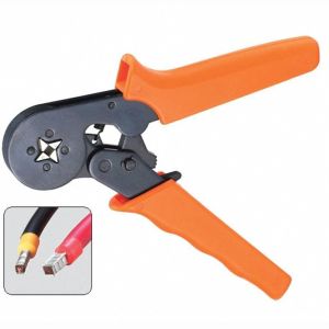

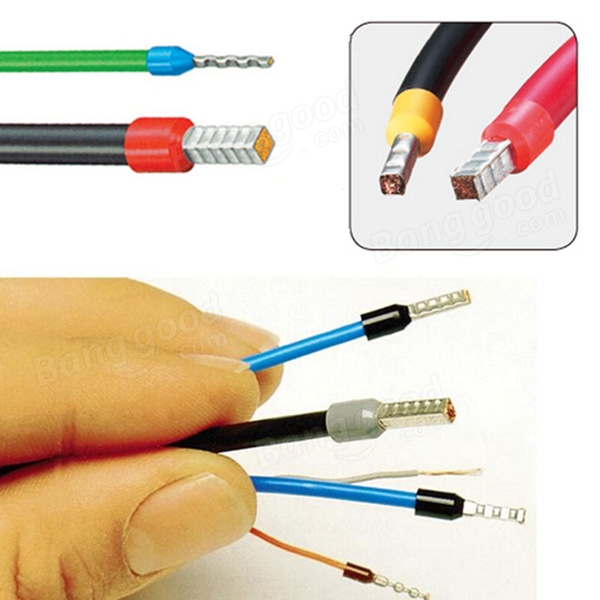

When I was building my v3, I was told by a German friend that one should NEVER put a stranded wire in a screw down connector, tinned or otherwise, but especially not tinned. He was horrified that I would even consider it.
Instead, in Germany it is common knowledge and practice to always use a ferrule. In all my years of electrical work and electronics, I did not know this. Apparently, wire ferrules just aren't popular in the US. Go figure.
The tool used to crimp the ferrule is really cool. It crimps the ferrule equally inward in four opposing directions.
I've seen German wiring, house and other, and it is always very neat, organized, and perfect.
Here's where I got my ferrules and crimp tool:
https://www.amazon.com/gp/product/B06XC ... UTF8&psc=1
Here are some photos:
[img]http://s3.amazonaws.com/3dPrint/wire%20ferrule.jpg[/img]
[img]http://s3.amazonaws.com/3dPrint/wire%20 ... ection.jpg[/img]
Update: I just noticed that this image I nabbed off the web shows more than one wire in each ferrule, which is also a big German no no. At this point, I am trusting the Germans!
[img]http://s3.amazonaws.com/3dPrint/wire%20 ... 20tool.jpg[/img]
[img]http://s3.amazonaws.com/3dPrint/wire%20 ... 0crimp.jpg[/img]

As someone who does industrial electrical work at times, those ferrules (bootlaces is another term I see a lot), are great. Any system where I expect wires to ever move from a terminal block will probably be fully crimped. However, for household wiring in the US, solid core wire is the most common. And unlike many chunks of europe (which I believe includes Germany), we are not expected to attach our own plugs to appliance cords (A common source of stranded wire work). Thus most americans work very little with stranded wiring.
As an aside, I do trust the Germans fairly well with electrical work, as the german DIN standards define a huge chunk of the terminals I deal with, however the pictured solution is far better than multiple ferrules there, as the screw terminal is relatively small in area, and multiple ferrules would make for poor contact, given that the insulation on the rear would make them both enter at angles. However, if it were a larger terminal area, I would agree multiple ferrules are better.
