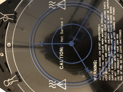

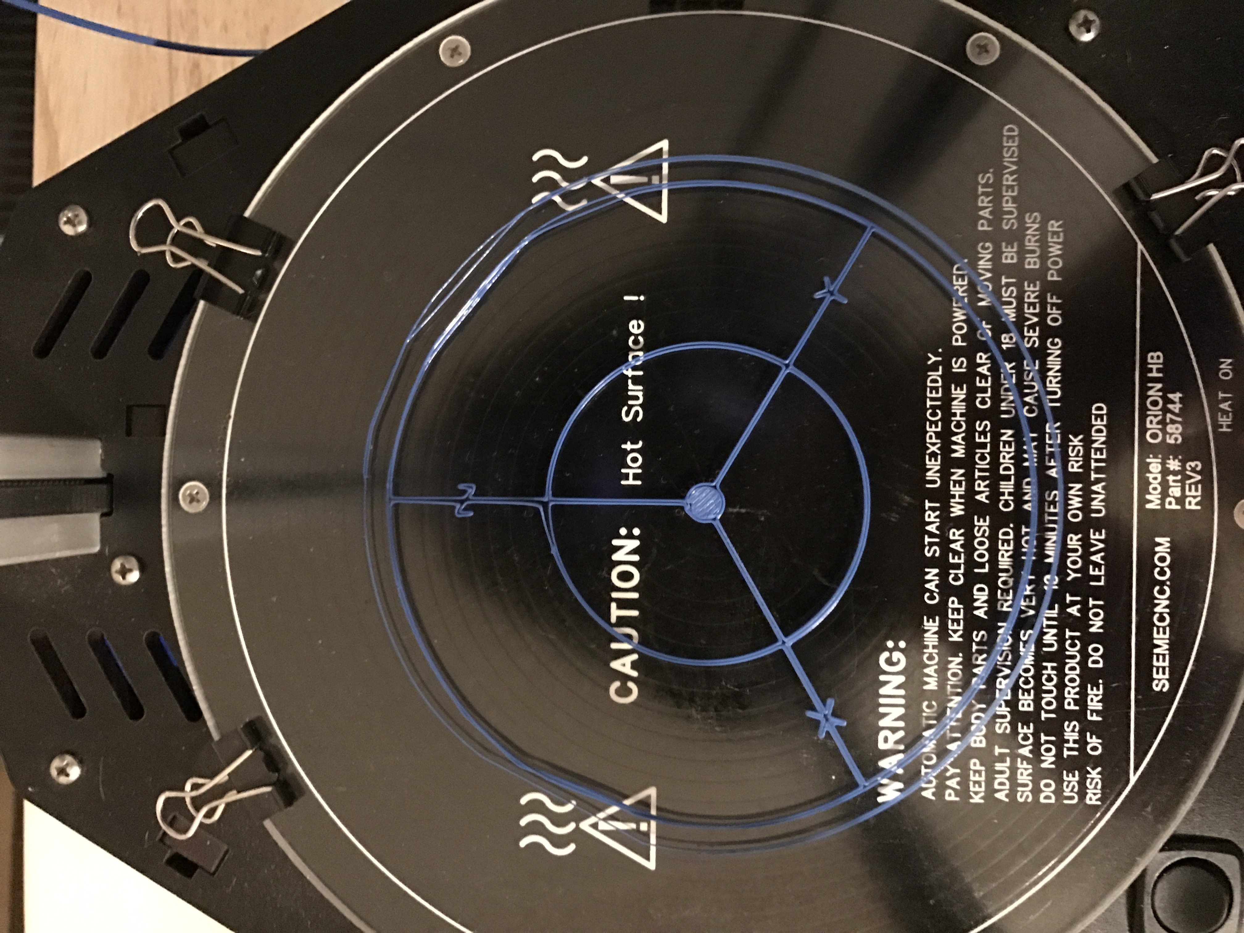

I ran the calibration from LCD menu, it ran fine without any overly aggressive acceleration issues.
The round bed leveling file printed and stuck well near the front (lcd) but the back towers the filament did not stick well to the bed. Since it is using the calibration and leveling itself I'm not sure how to fix it.
- Overhead Shot
- Angled Shot
What should I do to get this fixed and have a good first layer on the Orion?

That said. I tried the suggested fixed and it made things 100x worse! Now it crashes into the back then rises slightly towards the left like it's on a tilted bed. Whatever the fix was it seems like it somehow multiplied it.

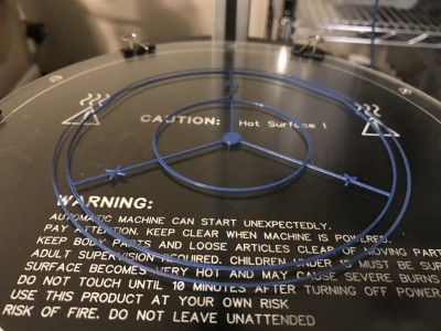

After running the wizard and LCD Calibration I got a good print on the bare glass (no hairspray) there was still a bit of loose filament around the back but with no extra help it seemed acceptable.

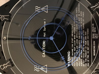

I hit the bare glass with some hairspray and did another print, this time it was as close to perfect as I could expect. And it is certainly the best print I have ever been able to get on this machine to date.
