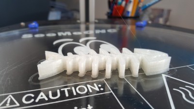

Hi All, been a long time fan of delta printers and after my hacky cheapo prusa i3 finally was finally laid to rest, I saved up and bought myself a Rostock Max v3 kit. So far I'm extremely happy with the sturdiness of the machine, the engineering that went into it, and the prints themselves are pretty solid.
But only as solid as an uncalibrated printer can be! Right now I'm facing two major problems. First off, the plate is inarguably getting pulled down on the sides so the first layer drifts from about the right high to ghostly clear:
[img]http://i.imgur.com/luOs3ZN.jpg[/img]
I saw the phrase "overconstrained" thrown around and I have some ideas where to start, as the seating never felt quite right on those. More on that later.
Second issue is a bit of pasta coming out of the nozzle:
[img]http://i.imgur.com/4IGN2E2.jpg[/img]
This is the problem I look to tackle first, as I can ignore a crappy first layer, but I definitely can't ignore my prints needing a sand down and the office needing a vacuum after each print. I thought I'd chronicle my calibration progress here as I'm using a stock rostock v3, so maybe these changes could be shared with whomever comes after me.

I managed to fix the clog by extensive cleaning of both the middle of the hotend apparatus and the nozzle itself. With that cleaned, and cranked heat, I get smooth, ~100mm per ~100mm of extrusion, so I'm happy with the extrusion calibration overall. Also, I had my nozzle set to 0.4mm, but I believe the Rostock Max V3 ships with a 0.5mm nozzle- so I updated that in the firmware.
Quick shoutout to http://platformio.org/, as an infra guy I couldn't help myself but set up a headless way to upload updated firmware. The setup is straightforward- go through the steps of setting up a platformio project on your raspberry pi, link or move your header files (like Configuration.h) into the src folder provided by platform io projects, and then when the printer isn't actively connected to octoprint you can just run `platformio run -t upload` to push firmware. I should really write a blog post about that, it was such an improvement over opening up the Arduino IDE and stringing USB cables everywhere (and now bringing my laptop to the basement, yikes), that I would definitely set it again if I had to start from scratch.
So with the updates of a better calibrated extruder, nozzle set to 0.5mm, I was still getting strings. I thought it might be the PLA I was using so I swapped it out for some nice yellow stuff I've had for a while. now I'm getting these amazingly thin angel hair strings- but lots, lots lots of them:
[img]http://i.imgur.com/XiCVF2f.jpg[/img]
The filament has been desiccated but is somewhat old, so I expect less that perfect prints from the stuff, but even the face quality of these prints aren't ideal:
[img]http://i.imgur.com/8k3QA1R.jpg[/img]
I'm slicking my prints with Cura, and I'm not sure how to set retraction settings (aside from a course enable/disable).
If anyone has any next steps I should try I'd be happy to put some filament to the test. I can file off these hairs but when it comes off the build plate I swear it looks like a spiderweb :D

I finally had time to install the new nozzle. Pulling the ancient PLA I was using to test the rostock I found this:
[img]https://i.imgur.com/EyIgH88.jpg[/img]
Looks like I was at least half right when I questioned the seating and the nozzle. I cleaned out the heating area as much as I could, and replaced the nozzle and the filament with some new ABS I got from seemecnc straight. I didn't realize that you're not supposed to cool at all with ABS, as cooling mid-print will cause curling, so I ended up with quite a few "heater decoupled" errors that made me scratch my head.
Eventually I realized that the cooling was destroying the bed- it couldn't keep up with the fans and maintain 80 degrees. The bed temp kept dropping, 79, 78, 78.5, 77, and so on- eventually causing a DEC error. So, at first I started lowering the bed temperature manually during the print, and around 1/5 of the way through I realized there was a button on octoprint to just turn the damn fans off. The result? A pretty damn good benchy!
[img]https://i.imgur.com/kl2OhnZ.jpg[/img]
The minor stringing is still a concern, but still better than my previous prints by a mile. This has something ridiculous like 3mm of retraction as well, so maybe I can cool that down a bit? Word to the wise: if you have an 80 degree C bed, the rostock max v3's fans will obliterate its ability to hold temp and cause DEC errors. Don't forget to turn off cooling on ABS!
Anyway, this is more than good enough for general prints, and my next step is to build an enclosure for ABS prints. Any other advice would be welcome- but I think I've got to churn out more test prints to figure out what exactly is going wrong aside from the spiderwebs I get on the benchy.

I was getting really bad stringing and oozing issues, but then I found this post:
https://www.matterhackers.com/articles/ ... -to-oozing
Usually I think "but this won't apply for my printer, but it turns out Matterhackers sell the Rostock Max, and if you look at the pictures of the test prints, the build plate is... round? You can almost make out the logo....
Well, point being I did this and my strings went way, way way down. I used their "this seems to work in our case" settings at the end of the guide and got a great improvement, but I also found the model they used on Thingiverse (their link is old and broken or something):
https://www.thingiverse.com/thing:2240682
Any new filament I use I'm going to go through this process to dial in my slicer settings.
