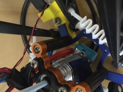

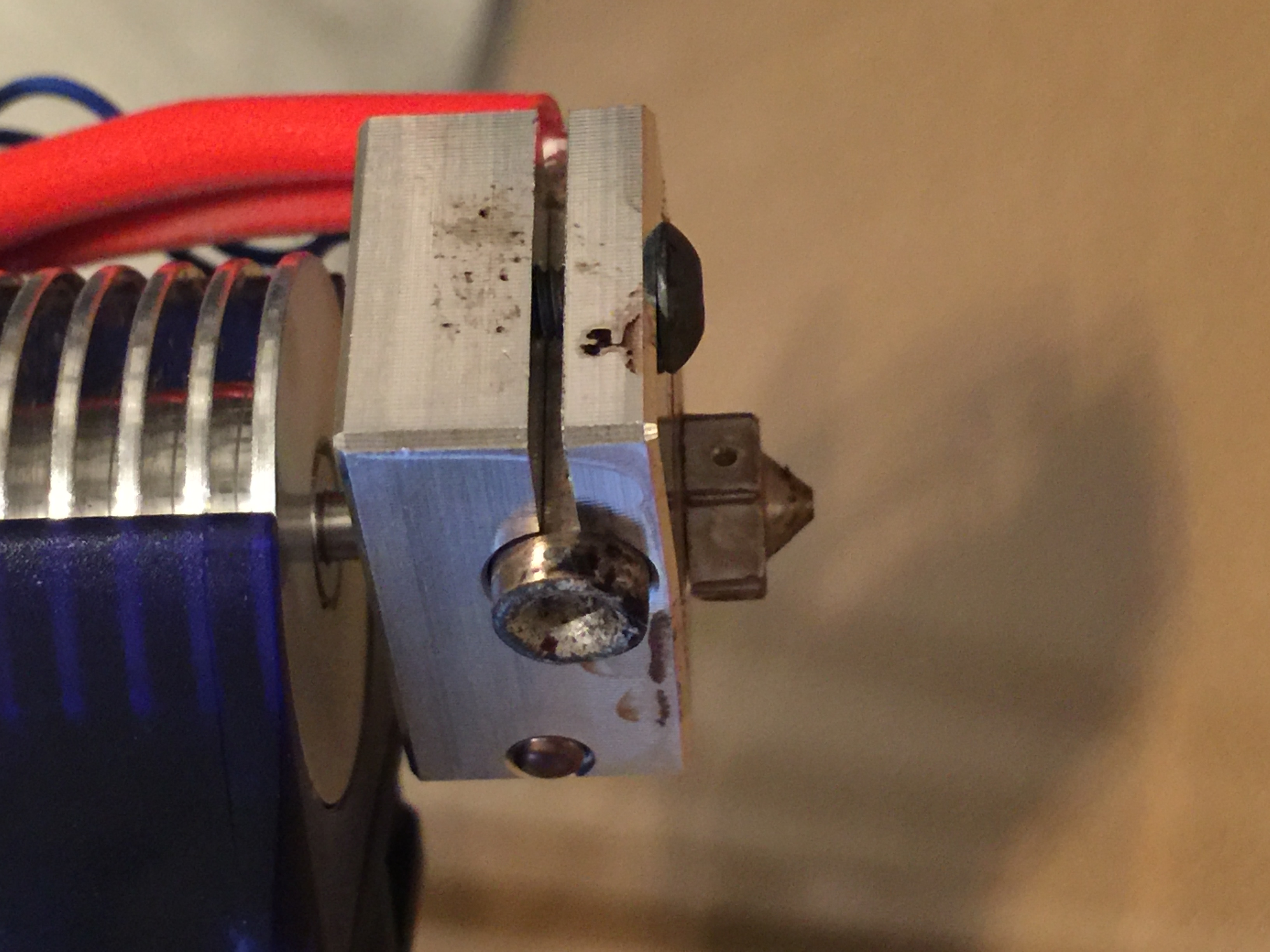

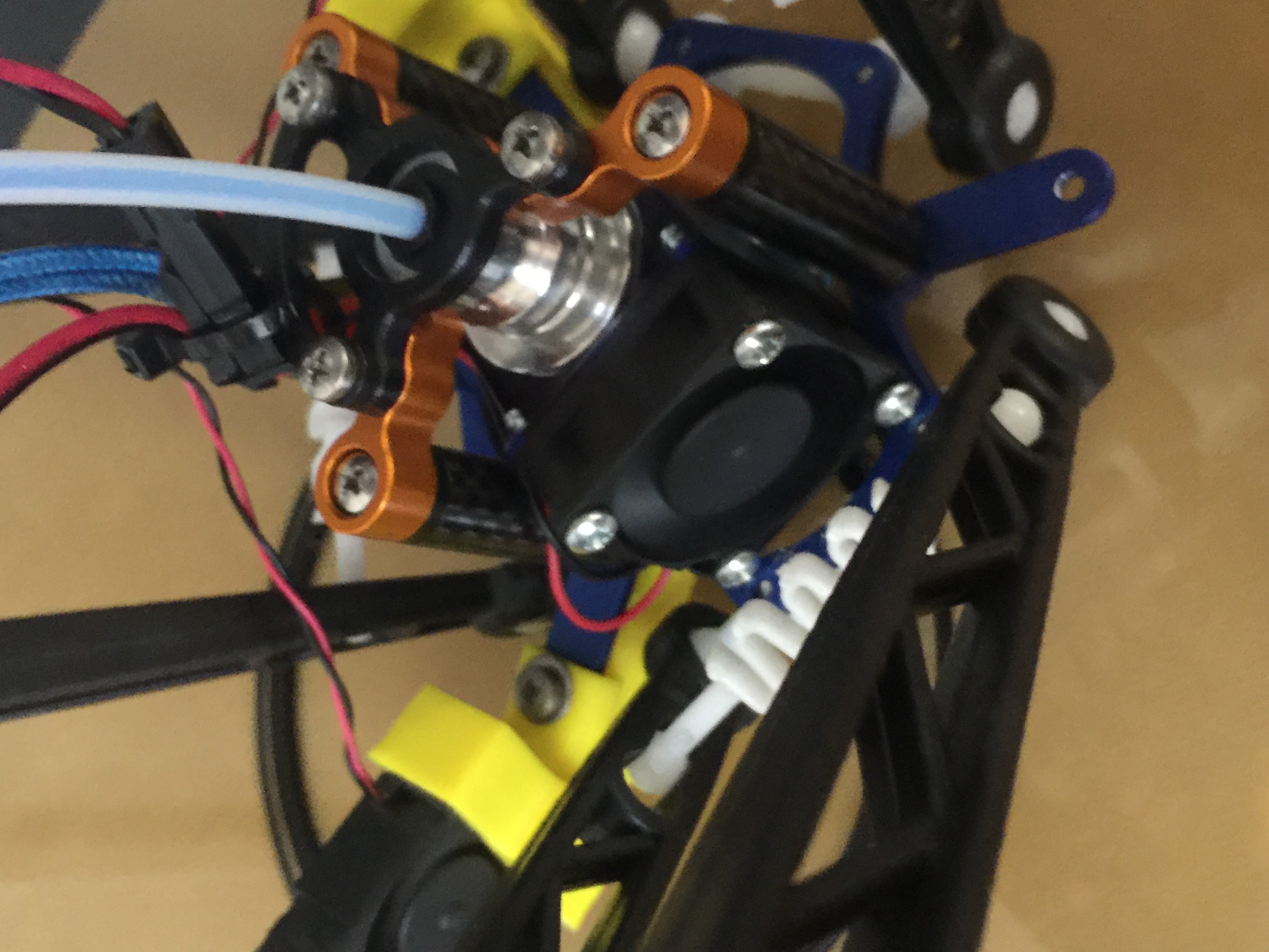

Re: E3D V6 jamming
I don't think you have problems with filament being old or fat. You are experiencing something systemic that is not right. IR thermometers are not helpful and usually just make things worse since they are so inaccurate in this application. I think you can trust your thermistor and heater given that you've swapped both and still have this problem.
"Just in case" can you take a few photos of your hot end - complete side view showing heater and het exchanger - and as much detail as you can for the extruder please. Sometimes something obvious to use might pop up.
Meanwhile, have you cleaned the plastic out of the extruder drive gear? Is the gear firmly fastened and aligned properly?
Lastly, what state are you in? Maybe some local help is available.
I'm sure we'll get this sorted out. Usually when a problem moves into this "perplexing mode" it almost always turns out to be something incredibly simple.

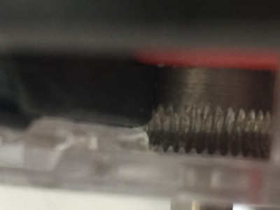

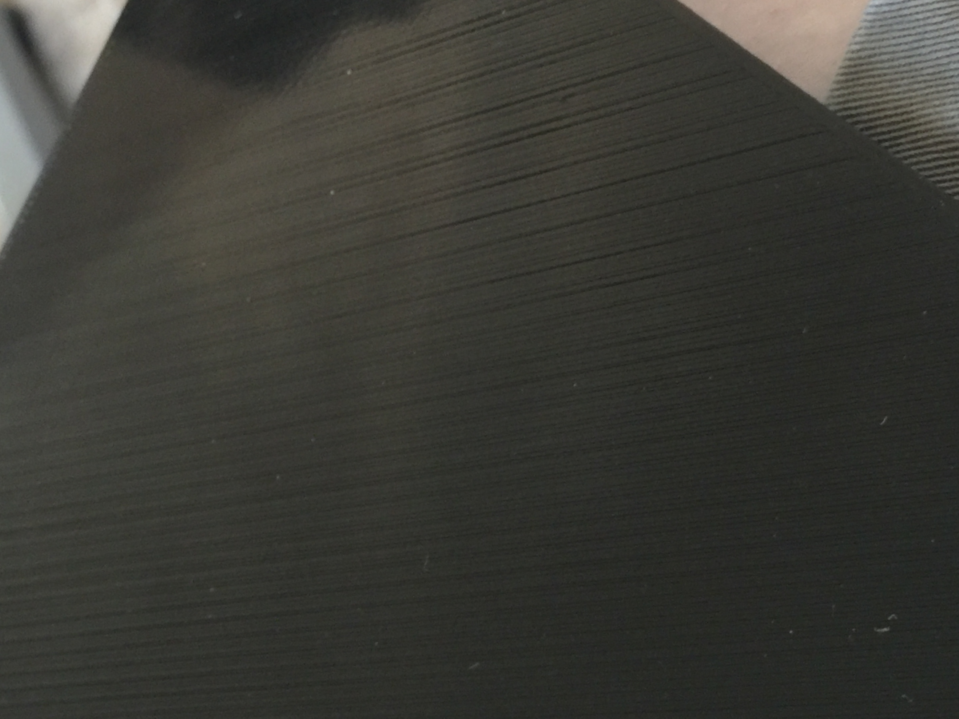

This is a print that did not jam completely, pics of the printer parts coming soon...
Re: E3D V6 jamming
This shows serious under extrusion so it was a jam waiting to happen.

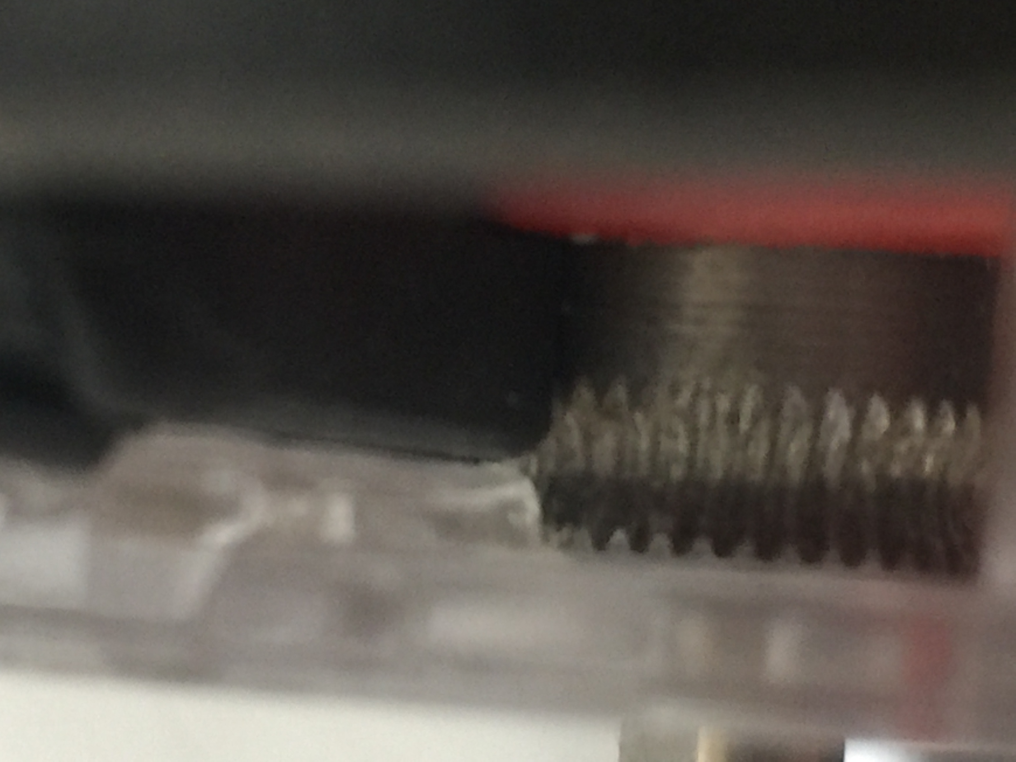

Re: E3D V6 jamming
I did a close watch on an aggressive print (lost of short back and forth movement)
The temp was stable, the cooling fan stayed on the entire time. I moved the wiring around to see if I could cause a problem but nothing changed.
Here are some pictures:
I think my extruder is aligned properly
Hot end
Just for the record this is what the black PLA looks like:
Not perfect, but it doesn't jam
Hot end
Re: E3D V6 jamming
Yeah but those regular bands in the first layer are an early indication of the pain to come! Something is not right.
Can you take a side view photo of your hot end so I can see the complete outline of the heater block and nozzle.

Re: E3D V6 jamming
Well there's your problem. See the dark bands in this picture, that are fat on the spoke, and thin on the rim?
[img]http://forum.seemecnc.com/download/file ... =14874&t=1[/img]
This normally means that you have a cyclical problem with your extruder gear. Looking at this picture:
I'd have a good hard look at your extruder gear, while you manually command a 20mm extrusion (no filament loaded). See if the gear is wobbling as the shaft spins. Also, the filament should be seated right in the middle of the extruder gear teeth, not riding right up on the lip of the teeth.
It seems as if the extruder gear isn't square on the shaft, or the shaft itself is bent. Note how the dark discolouration on the drive gear is close to the edge on one side, and pushed away on the other side?
Re: E3D V6 jamming
I checked the rotation of the extruder gear / shaft, no wobble. I think the dark area in the picture is just a shadow, when I shine a light on it there is no obvious mark. I did a small adjustment anyway, moving the gear out a bit. Ultimately no change.

Back to the filament that clogs so well, high temp PLA.
Initially it seems to extrude ok, then gets thin until it finally clogs. I measure the filament width that I extrude and it measures an average of .3mm. This is out of a .4 nozzle. Verified its a .4 nozzle (3 dots)
After a full clog I can not pull the filament out of the heat sink by hand. I can use the extruder to work it in and out to free it.
There is no blob of filament at the end of the Bowden when I pull it from the heat sink. I usually get a half inch of filament or so out the end of the Bowden indicating it is in the heat break.
The behavior is pretty consistent. After a clog, I can manually extrude and seemingly clear it. During the next print I get some extrusion for a while then it clogs.
It almost seems line I am getting a legitimate nozzle clog but all the time. Like my filament is covered in dirt. I don't think it is BTW, I keep it in a desiccant box. And this does not happen on my other printer. (direct feed Cartesian)
