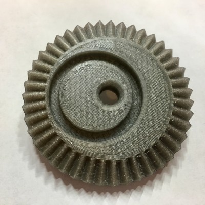

Off topic a bit for direct drive extruders. Since a picture is worth a 1000 words here are 4000 words:
This gear is extremely difficult to print without a LOT of stringing between the gear teeth. There are 1000s of short segments followed by short hops. A challenging part to print cleanly. This photo shows a very good part printed on my Rostock MAX V3 with a 1.8mm ID Bowden and Bondtech QR extruder with a E3D V6 hot end. But as good as it is, you can see the little wisps of filament strings between some the teeth (click the photo for high res view). This part was printed on the same printer but with the Titan Aero direct drive. Same g-code and same spool of filament. In other words, a very good 1-1 comparison test. Not a hair on its Chiny-chin-chin (or is it toothy-tooth-tooth?)

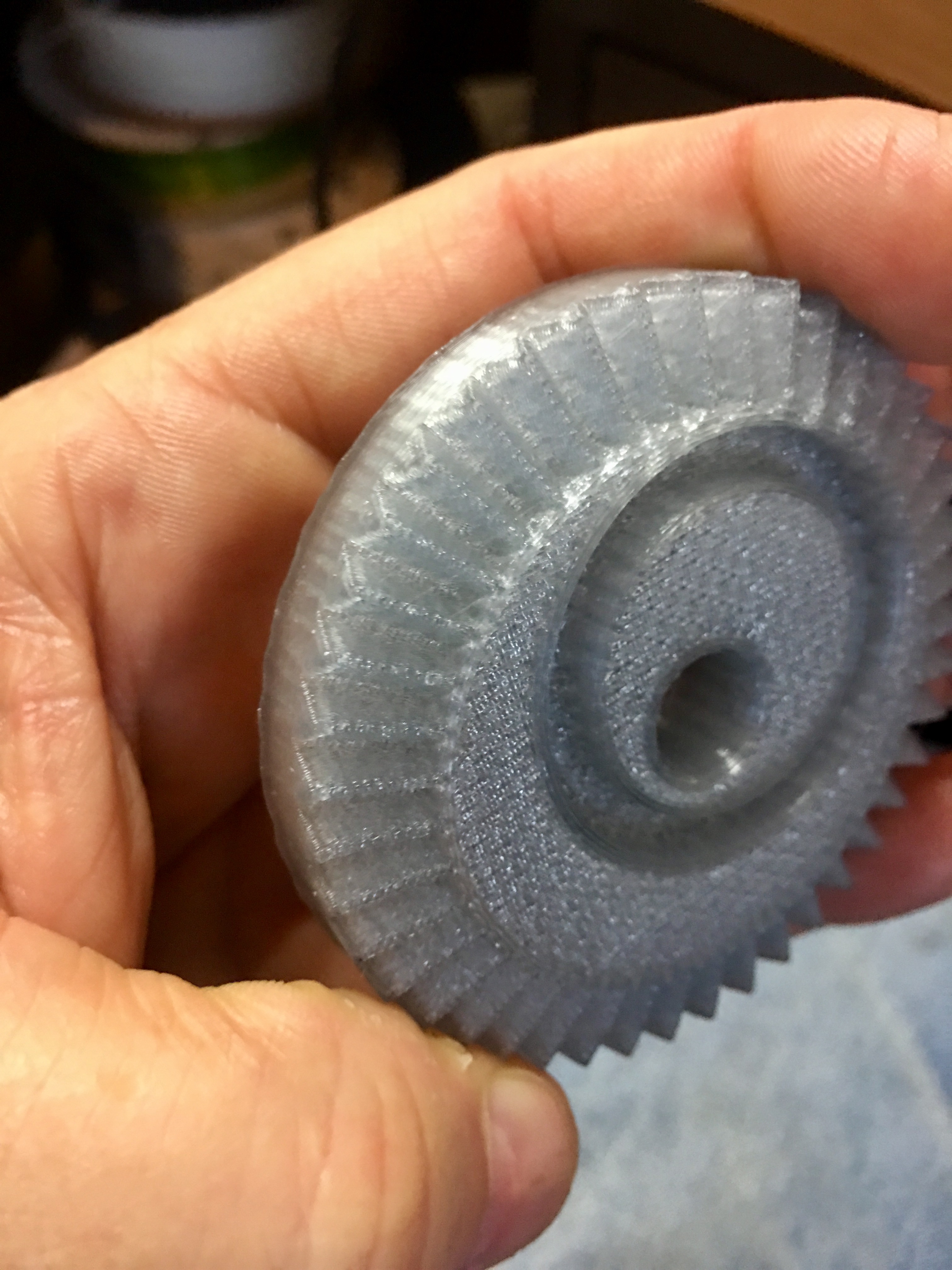

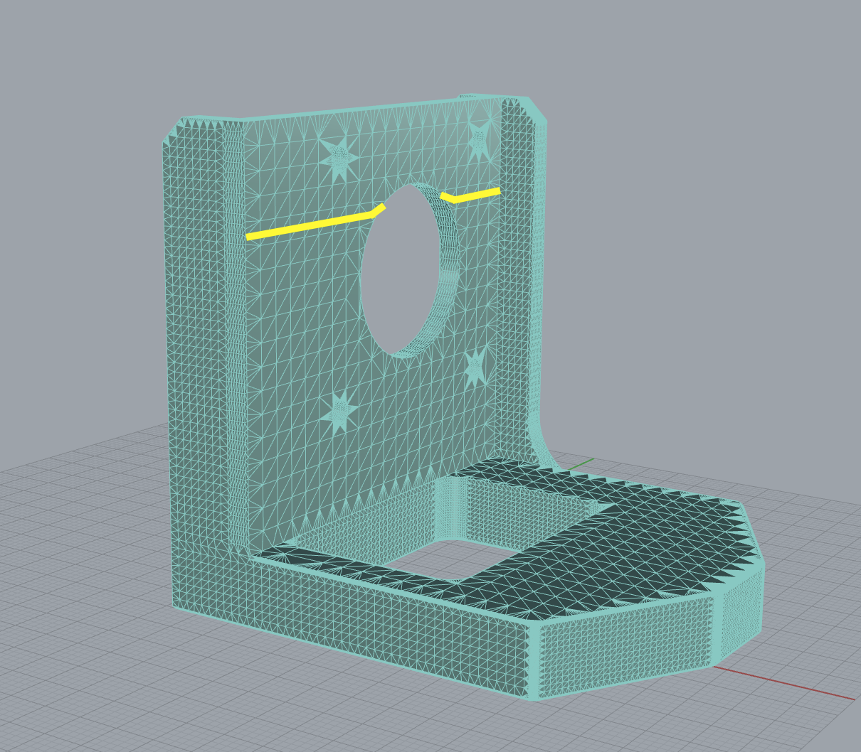

Here's an example of the type of geometry that can be problematic for mag ball arms printed in PLA:
This problem typically arises when there is not a continuous bridging action across a highly overhung geometry - like the layer highlighted in yellow. We can argue about this not being an ideal geometry (as it is presented) for FFM printing and I will not refute - it isn't. But there are many bad geometries on the sharing sites that are problematic in this way. In my example, I simply design-in a "T" support for the top arch and solve the problem - "think through the print."
To mitigate, improve cooling significantly, use .1mm layers, slow down significantly, add support to the hole/opening, etc. It can be printed with mag ball arms but if you are not experienced and don't "think through the print" it will likely fail with popped off arms. Even the small 3mm through holes can cause problems.This problem typically arises when there is not a continuous bridging action across a highly overhung geometry - like the layer highlighted in yellow. We can argue about this not being an ideal geometry (as it is presented) for FFM printing and I will not refute - it isn't. But there are many bad geometries on the sharing sites that are problematic in this way. In my example, I simply design-in a "T" support for the top arch and solve the problem - "think through the print."

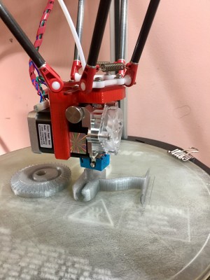

I did notice that on your delta you're running the Trick Laser arms, but where did you get the metal effector? It looks almost like the stock Seemecnc effector. Also what "cheapskates" do you use on your machines? I am definitely not in love with the original cheapskates (version before injected molded)
Again thanks for the input and I may actually look into the direct drive as well, that print is beautiful.
- Posts: 1561
Re: Cheapskate and arms options
That's a 713 Maker Ball joint effector. They are quite lovely, and leave a lot of space open in the middle (I am proud to say I have one of the first to be sold, and have never had an issue with it)Herrminator117 wrote:Thank you for the insight and I definitely agree. The magnetic arms have provided me 1,200 hrs of my total ~1,680 hrs of printing on my Rostock and have done so very well! Biggest issue is that I personally made them and they don't have nearly the precision a set of well made arms would have. Theres slop and in combination with a large amount of issues I just need to cut my losses and also have piece of mind!mhackney wrote:See Delta Arm Joint Musings
