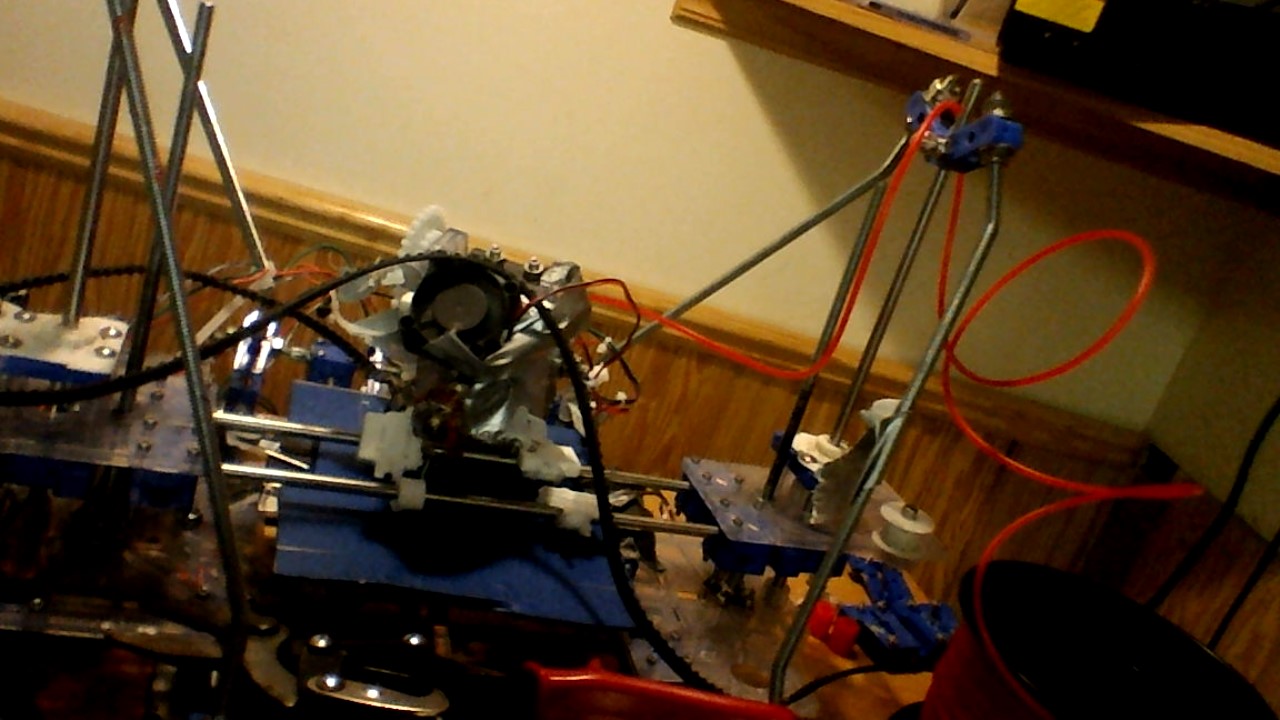

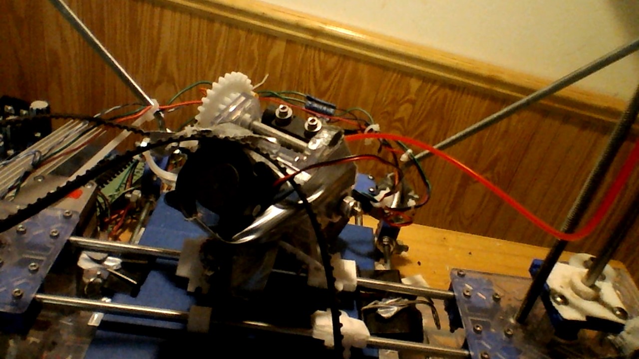

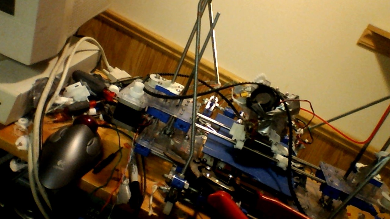

My x-carrage is no longer, my computer froze on the lowering of the z- axis to start a new print and kept going while I was away for 5min. I had my own diy version of linear bearings which worked great until it broke. It either saved my base from warping or screwed me . Really pissed now, Need to rewire the hotend resistors, need to find a way to get my linear axis back. Will hotglue stick well to the injection molded ABS? If I can scrounge up one linear bearing then I may be in good shape if the hotglue sticks, I already have 2 back up bearings and one made it through. If not then I do not know what to do . Can't go back to seemecnc's version because I was cheap and didn't get the metal bearings. This sucks really can't believe it happened.

Thanks John I appreciate it, Luckily the hotglue stuck and I am printing now
First thing I did was print out extra parts in case it happens again. I have a very simple linear x-carriage now that works pretty good. Also Jake, They are great guys I have sent them a bunch of emails when I was building mine and they helped A lot.
