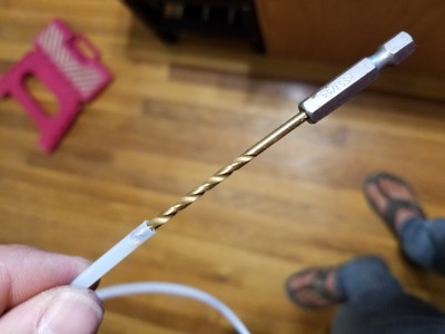

The image of the drill bit was my way of performing the chambered edge on the bowden. I can make the wall thinner longer into the pfte tube, as well I can still make the 45 degree cambered easier than with a utility knife. I used several bits of larger diameter as I stepped the wall thickness down .

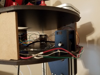

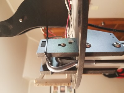

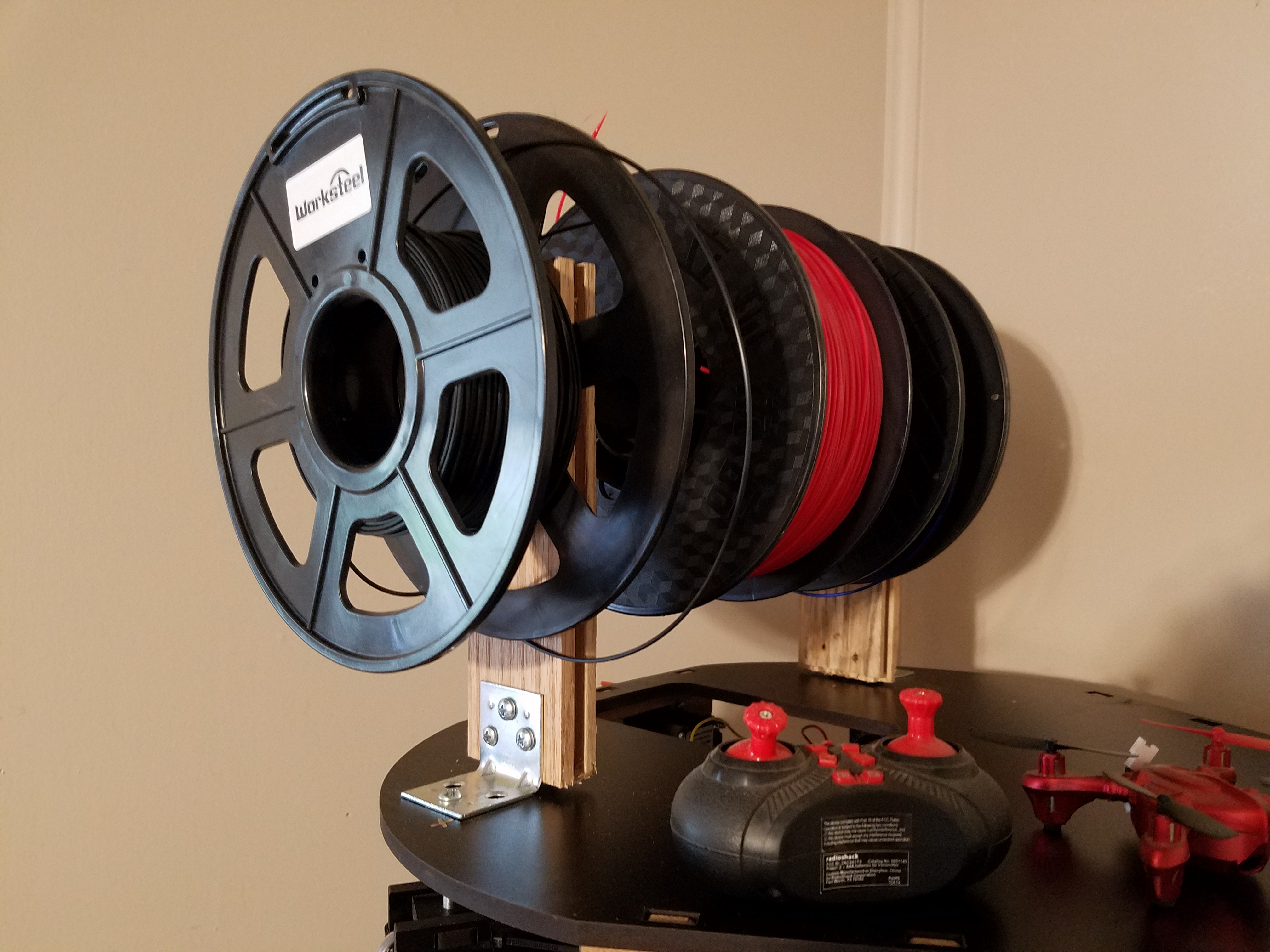

All the hardware is installed, I re-made the upper tower side boards to fit the second ez-struder on the top, and added a dual filament rack that allows easy feeding to the struders. I have the HE280 hooked up and powered up (but I do have some errors - more on that later.)
Images of build:

1. I needed to make new top side panels for the NEMA motors to fit in since the V2 vs V3 with dual extruders has shorter panels - in the V3 this wouldn't be necessary as the mount for the ezstruder is already on the side - and all electronics are moved upstairs. I used 1/4" MDF board and cut the proper slices out and installed - you can see them in the previous post. If I were doing over again I think someone has a motor mount on here for the V2 - but I didn't notice this until it was too late. I'll probably go back and re-do. If I find them or someone else does please link.

The chamfer should be on the outside diameter, not the inside. The inside is the filament path, which you want to be continuously seated at its interface with the hot end to prevent a thick spot in the filament path. Chamfering the outside edge helps ensure that imperfections on the outside edge don't hold the inside edge off of the interface. Chamfering the inside guarantees a thick spot in the filament path.elliot m wrote:The image of the drill bit was my way of performing the chambered edge on the bowden. I can make the wall thinner longer into the pfte tube, as well I can still make the 45 degree cambered easier than with a utility knife. I used several bits of larger diameter as I stepped the wall thickness down .
Re: What I have learned about dual extrusion
Hmmm - I'll have to take a look at that from the image on the instructions page, it looked like the chamfer was on the inside and it states that it goes into the single end of the Y adapter.
I made the assumption this was to help guide the filaments as they would be changed often - and possibly need a little persuasion if they were trying to run down the side of the tube. If this is correct, wouldn't all edges of the pfte tubing be rounded?! I've not see the push connect fittings need this in the past. I can see your point if the edge was not 90 degrees or someone used a pair of side cutters. Thanks!
- Posts: 616
Forgot to follow up with this, sorry.elliot m wrote:Hmmm - I'll have to take a look at that from the image on the instructions page, it looked like the chamfer was on the inside and it states that it goes into the single end of the Y adapter.
I can't say I've done anything with the Y adapter. My experience with critical PTFE/hot-end interfaces is predominantly with the E3D v6. The fundamental difference with the interface at the hot end is that you are more likely to be dealing with potentially-soft/molten filament. The thing you're trying to keep from happening is having a soft section of filament retracted into that interface and then squeezing it out into a thick spot at an imperfect interface that can then cool and soften just a little and cause a jam.
