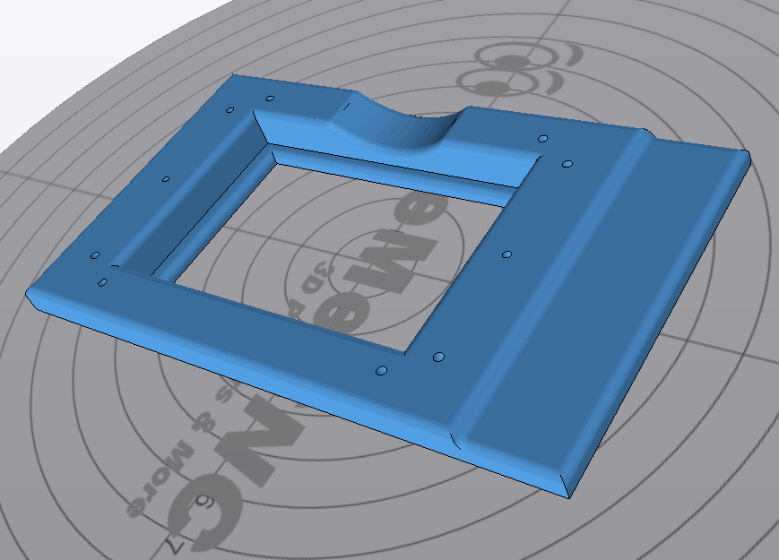

2. So I installed all the seemecnc printer profiles and the filament settings. This part was easy. I did have an issue with the wipe tower and placement - I didn't realize it was off the print area for a long time and why I was getting PrimeTower X and PrimeTower Y position errors, but changing the location from 140mm to 120mm solved this. I was wondering if we can put in an argument in this window: ie: 280-(PrimeTowerXDim) - then it would always be off to the side and never overboard.

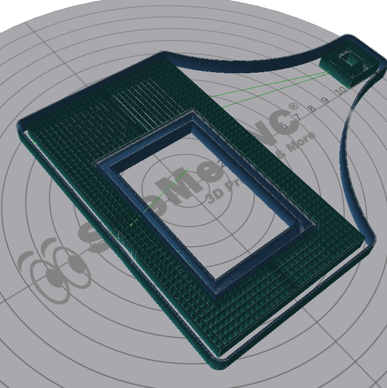

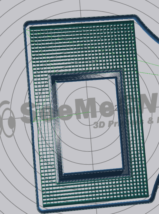

3b. Import to MC? But I seem to be getting a weird slice image -
Imported directly to MC it looks like this:
I wasn't sure if the open grid is just the artifact of how I have it programmed for the internal infill - but I thought
it would be covered on both sides and appear solid.
