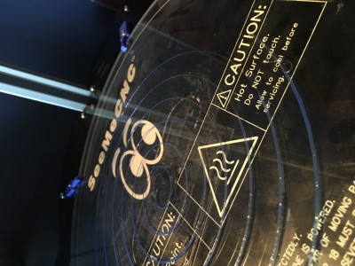

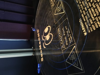

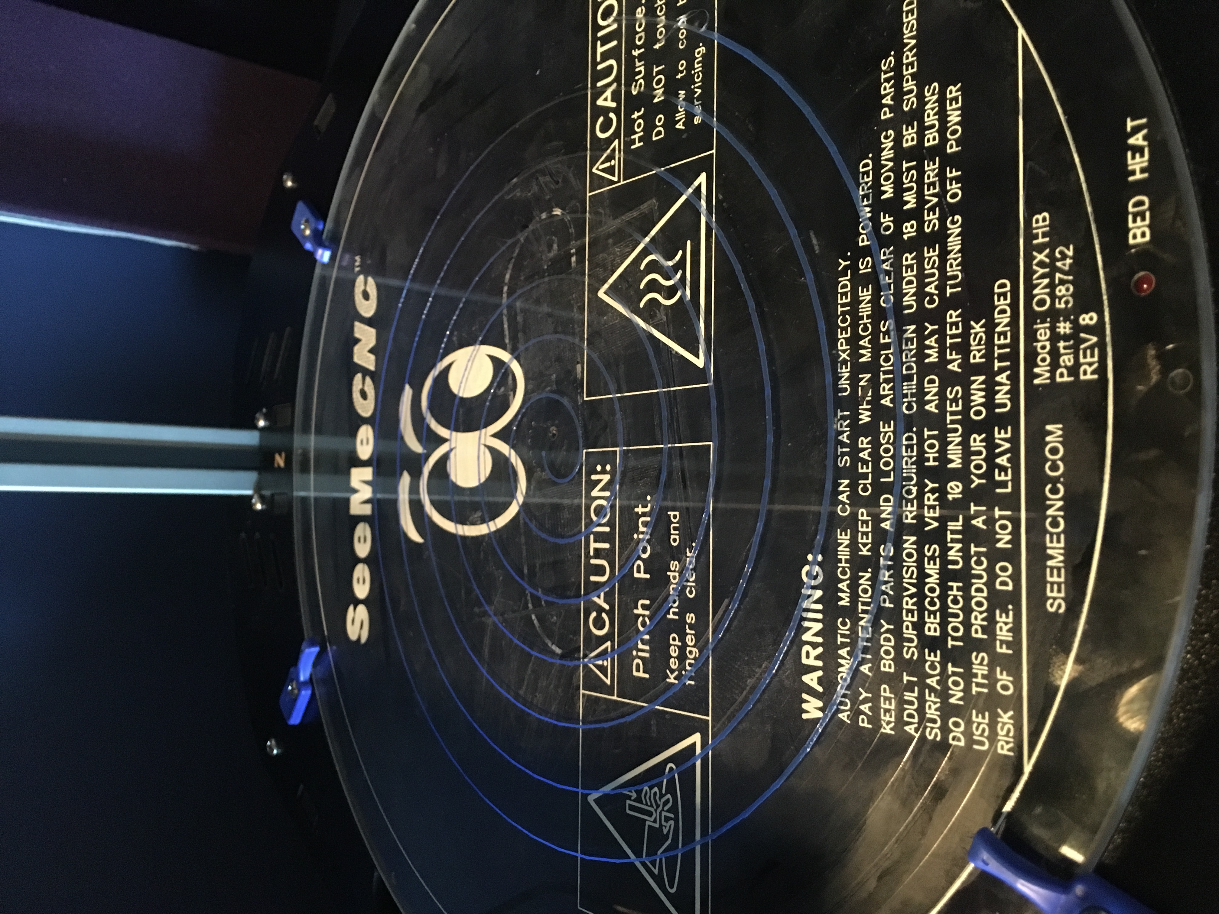

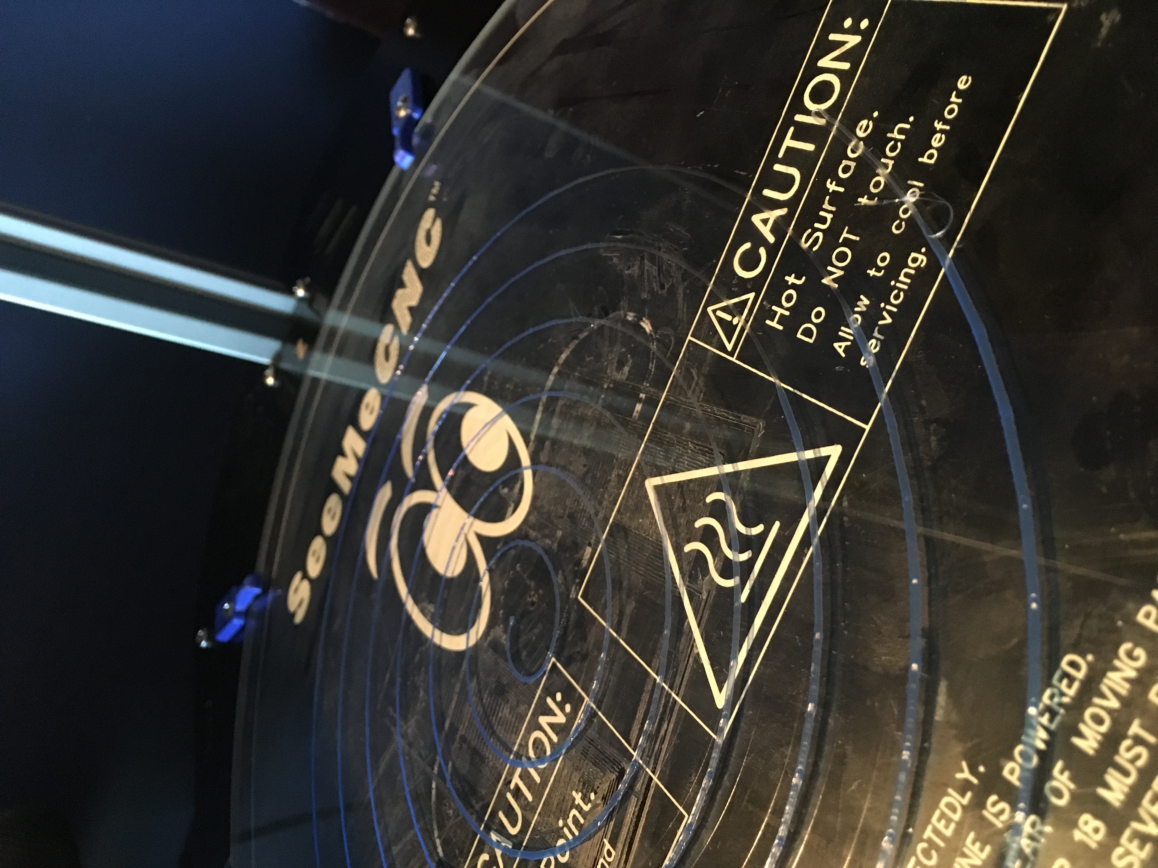

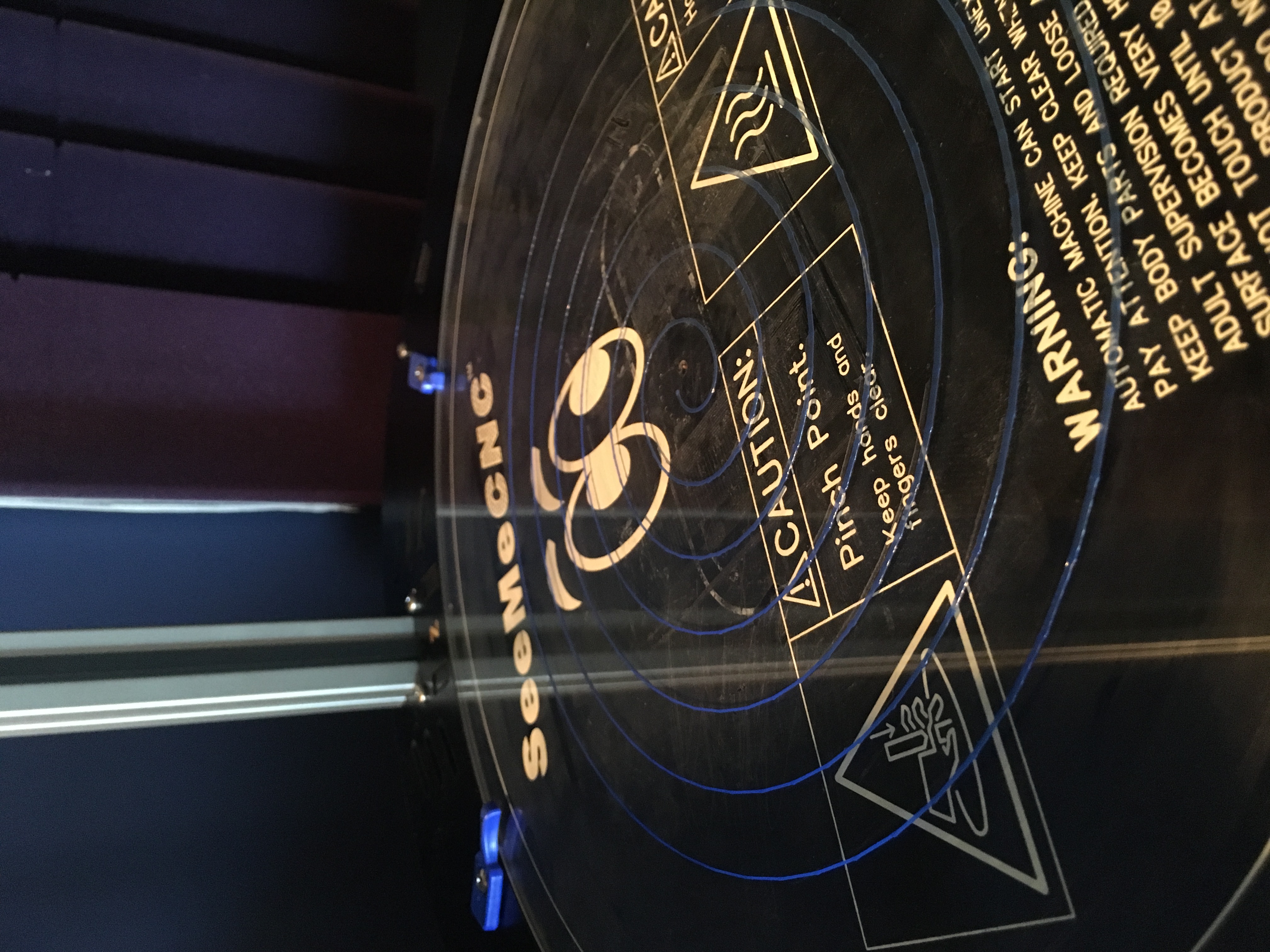

I've been trying to fix this issue for weeks now to no avail. When I'm printing something fairly large, the nozzle is hitting the bed between the y and z towers, stopping extrusion. I've calibrated my machine with the delta wizard at least 20 times and it still happens every time. CAN ANYONE HELP ME?!?!

Something else I just thought of, in your pictures, the glass bed seems to sit too high. I believe the blocks that hold the bed up should be short side down.

I tried both ways and the same thing is happening... Do you think the warped insulator bed would really affect the glass too?Gdot wrote:Something else I just thought of, in your pictures, the glass bed seems to sit too high. I believe the blocks that hold the bed up should be short side down.
