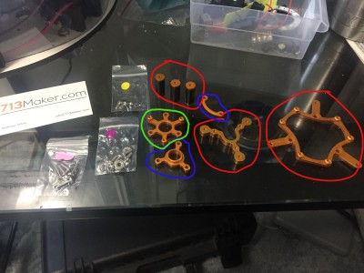

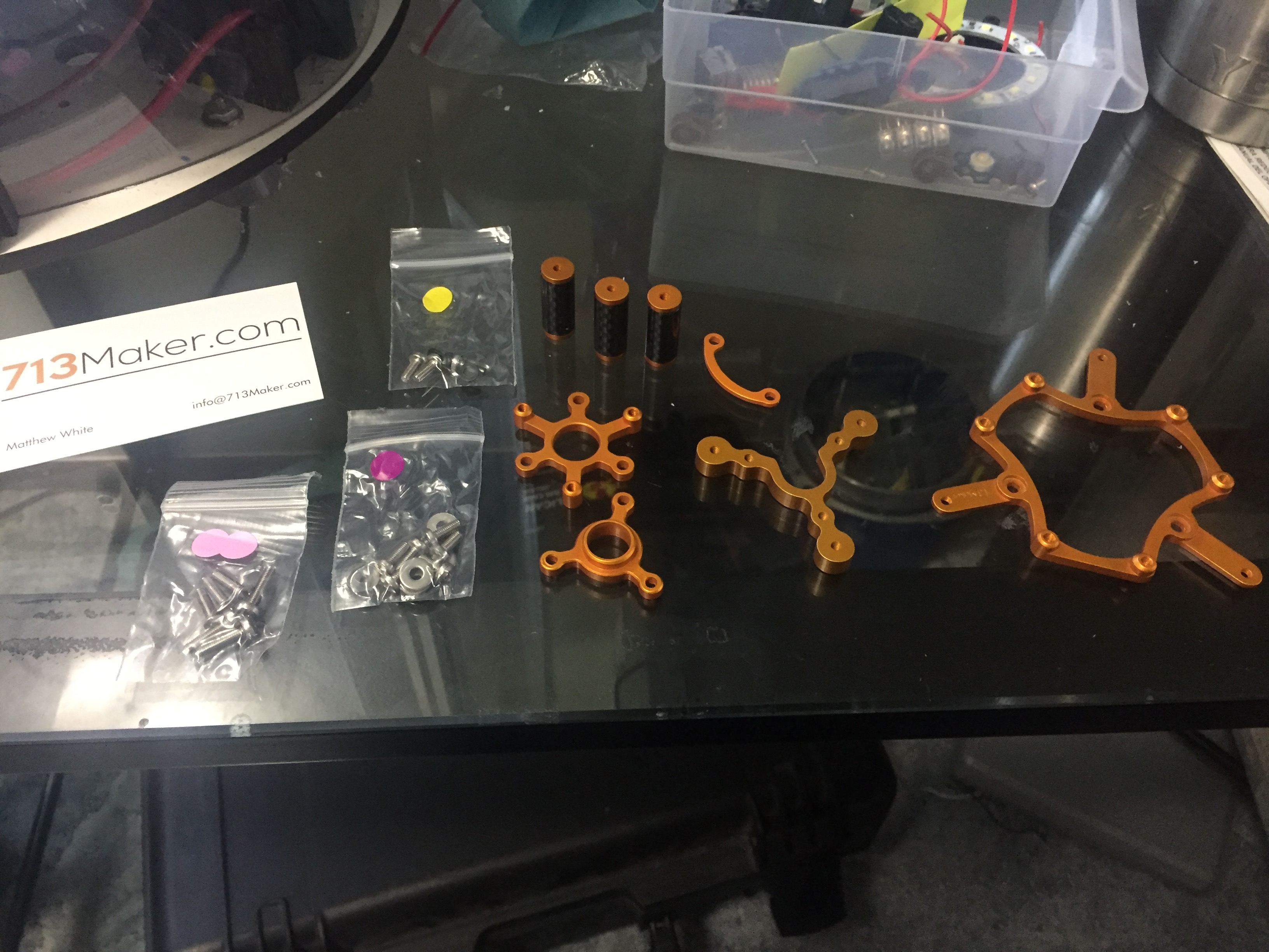

so has anyone purchased the effector and under mount kit for their he280? I got my parts this week from 713 super fast and everything looks nice. issue is I purchased what I thought I would need but am not sure if it is correct or will even work with a rebuild of the he280. Tips, pics, or any info would be great. I have sent numerous emails to 713 but they must be pretty busy.
my kit

That looks right. Usually there is a diagram to illustrate how to assemble. Let me try and get some photos for you.
-edit- Actually I think you have extra parts.
It looks like you bought a basic kit requesting SeeMeCNC locking ring. Red and Blue
Then additionally you bought the Accelerometer Board locking ring. Green
You do not need the parts in blue. At least, my kit did not include them because I selected "Accelerometer Probe" under locking ring choice.
At least that was only a $5 extra part you added.
I will attach photos of my installation.

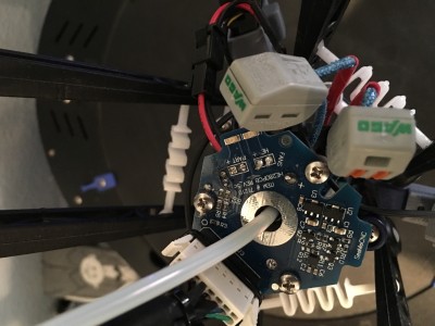

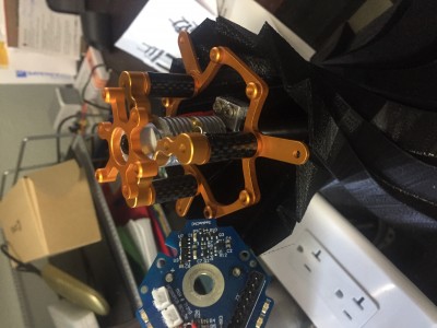

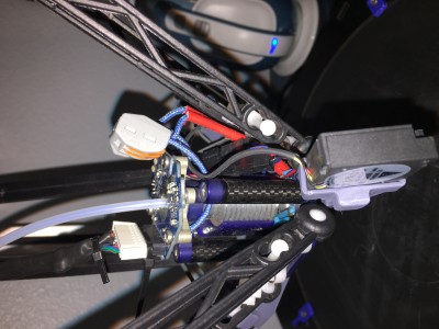

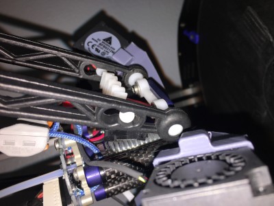

I just don't see how this acp board is going to work? the lock ring seems like if anything I will need some spacers ?
XpresoAdct
Posts: 36
Joined: Thu Apr 17, 2014 5:41 pm
Location: Irvine, CA
Re: 713 maker effector and hot end mount
Post by XpresoAdct »
In your yellow bag there should be four spacers.
One goes on the top of each of those accelerometer mount, then the accelerometer, then 1 more spacer on the top of the mount hole with a pos and neg attachment.

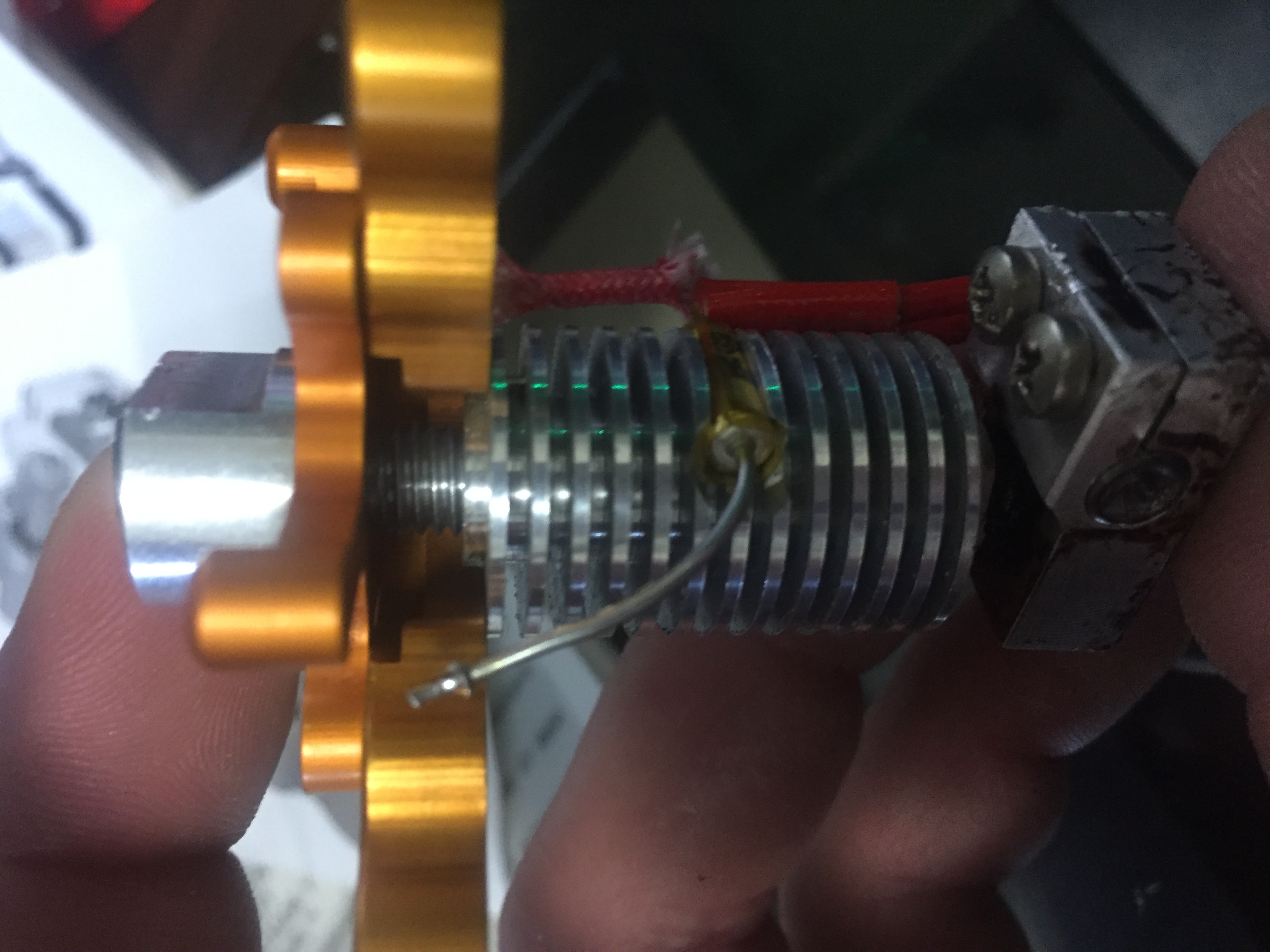

am I even supposed to be using the old hot end?
XpresoAdct
Posts: 36
Doh! Yup, that is an issue!
These mounts are for the E3D v6 hot end!

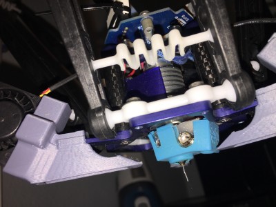

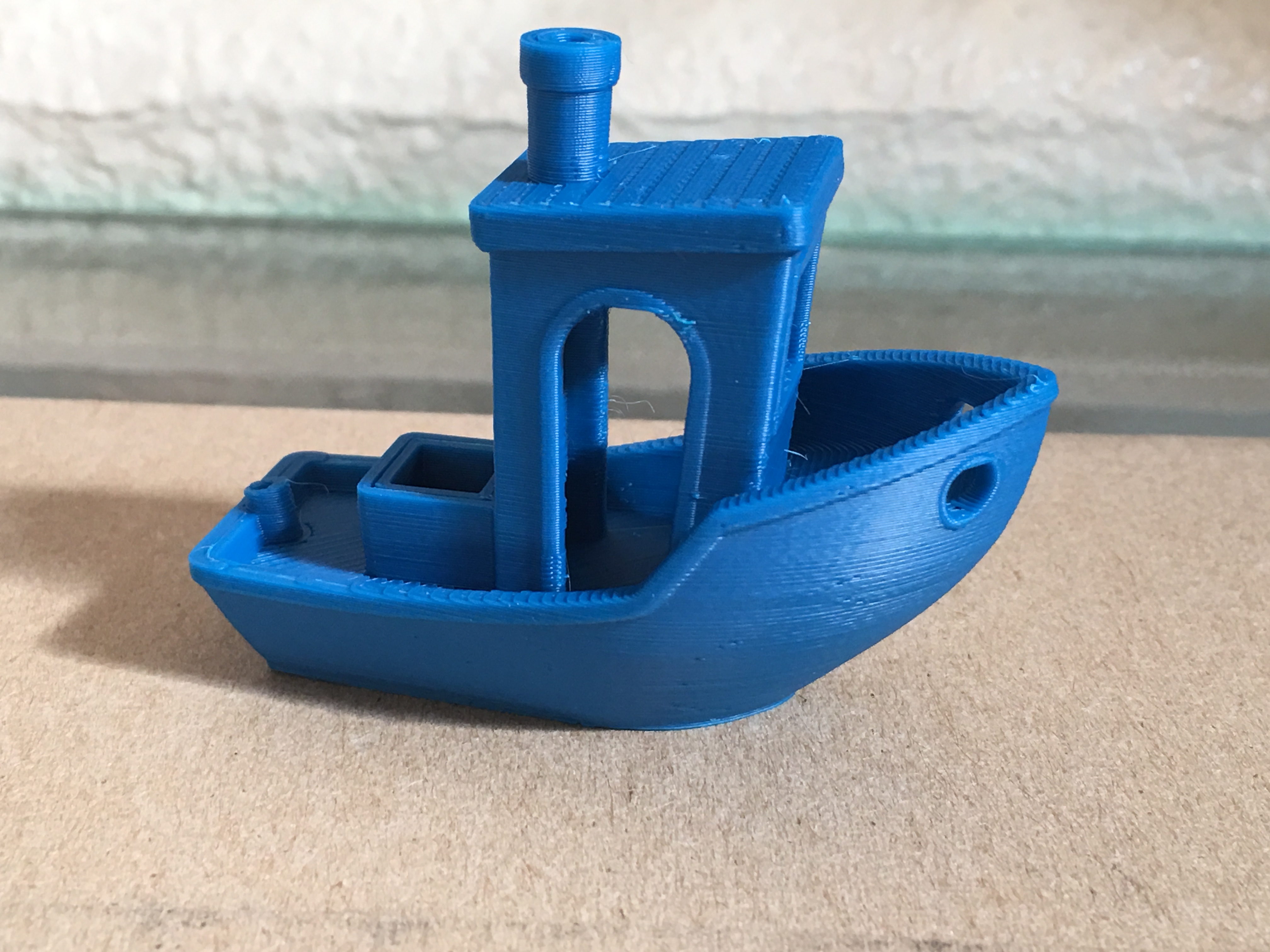

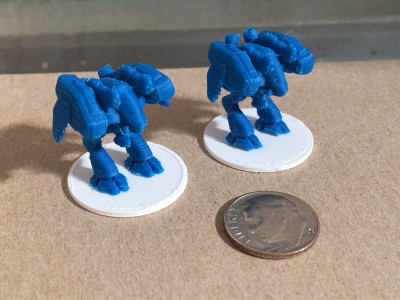

Some of my E3d prints
