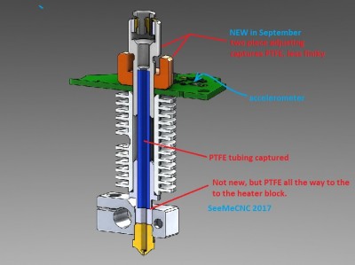

The hotend is now largely E3D compatible, and is as all-metal as the E3D, although it has some issues with the bowden not setting well. But the extruder is not complex, and while the hotend is somewhat complex, it is relatively easy to unplug and work on outside the machine (Or swap a spare in). The resistors are also gone. The Bowden tube never really needed to be unscrewed to change filaments. You may have had the ring on the old PTC fitting come off, or an intern who didn't push very much.

The HE280 is an excellent hot end. Seat the PTFE. If (for some reason) you feel a need to take the PTFE bowden tube in and out, trim an 1/8" off the end, keep the cut square. The reason to cut the end fresh is to give the Push-To-Connect fitting a new place the "bite" on tubing. If you don't cut the end, the PTC fitting wears out the place where it "bites" the tube, and the PTFE bowden tube slips up. This causes a gap down at the heat break, and a usually jam follows. It pretty rare to have our hot end jam if you seat the PTFE bowden tube and use the locking clip on the PTC fitting. A September release will help make the PTFE seating be less finiky.

The HE280 is designed to continually operate at 280C if you need it to. Fail testing at 320C, the thermistor fails and I could not get it to catch fire.
