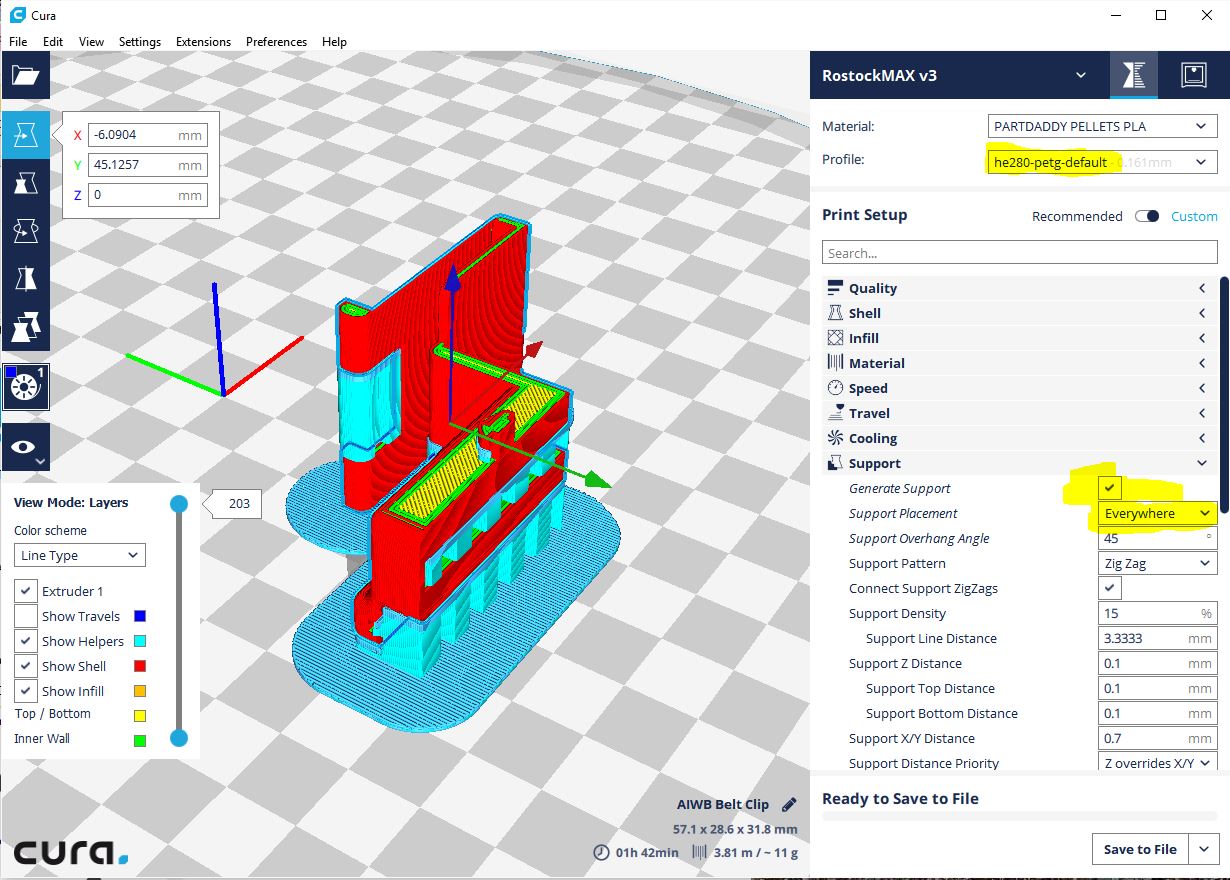

I'll print one today out of Carbon Fiber PETG while I'm working on our new printer stuff. Using the stock RostockMAX V3 on my desk, Cura slicing software, HE280 with 0.5 nozzle, carbon fiber PETG, and our Cura slicing profile for PETG. See links below. I'd normally opt for a smaller nozzle for a small part like this. You'll find that the 3D printed side wall finish and strength through the part are achieved by using the Carbon Fiber PETG. It's simply impressive filament for looks and strength.
I am modifying the PETG profile by changing support to 'everywhere', HE280 temp to 250C, hairspray on 60C glass, and a raft. All other values in the profile are untouched. Of course, if you've modded your machine, your results will not be the same and will require different settings.

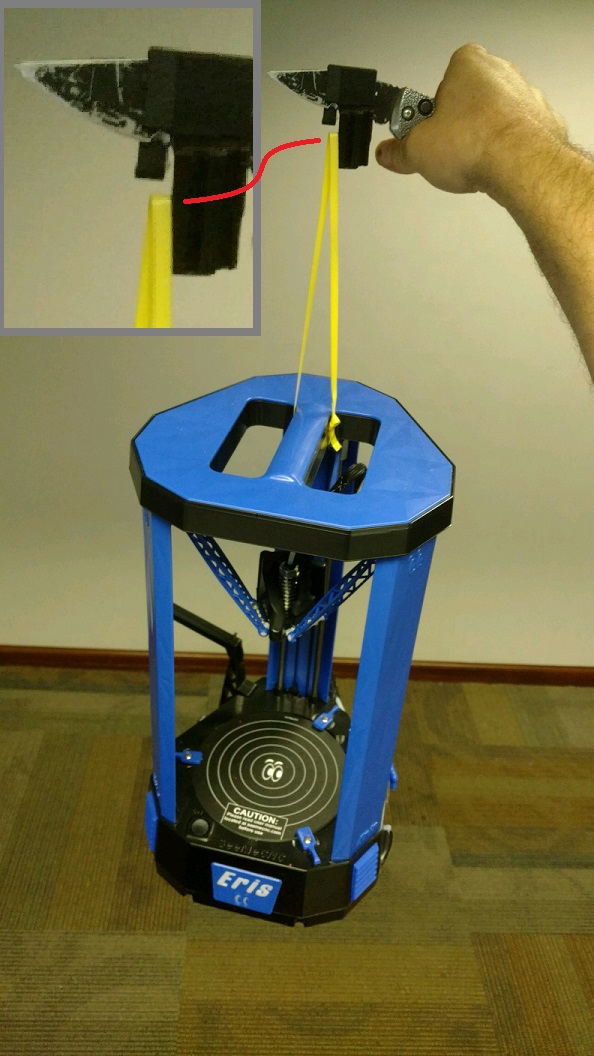

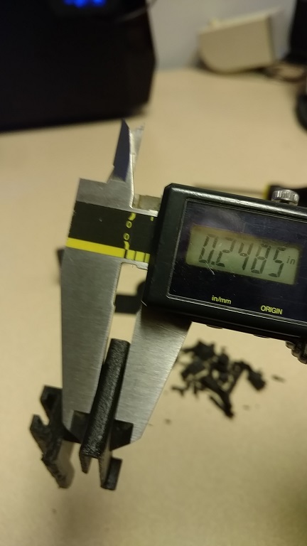

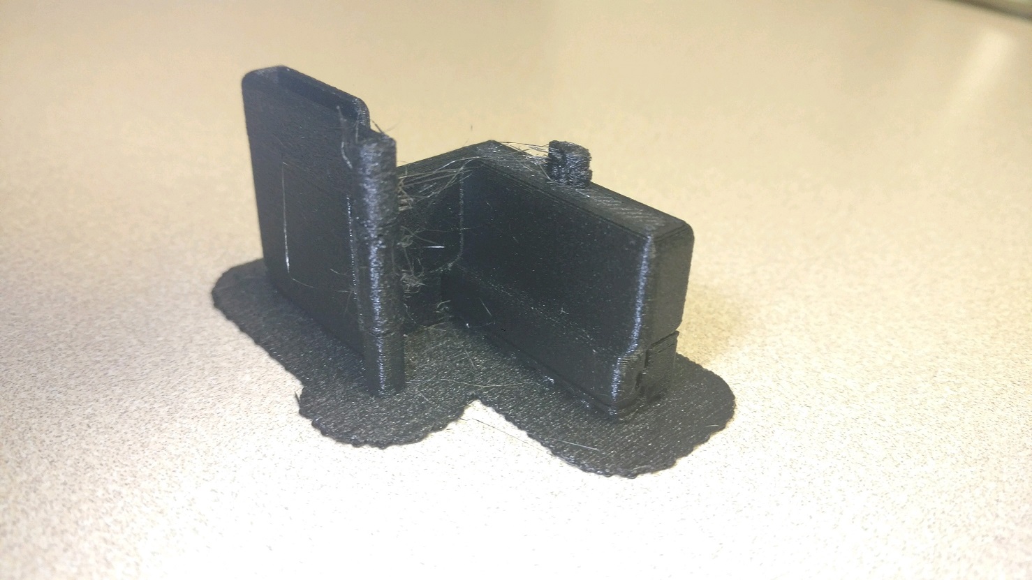

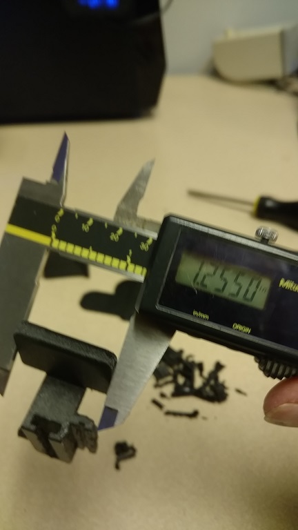

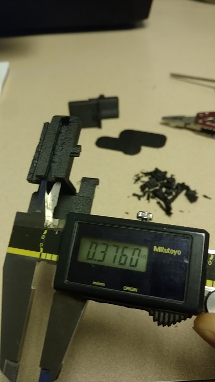

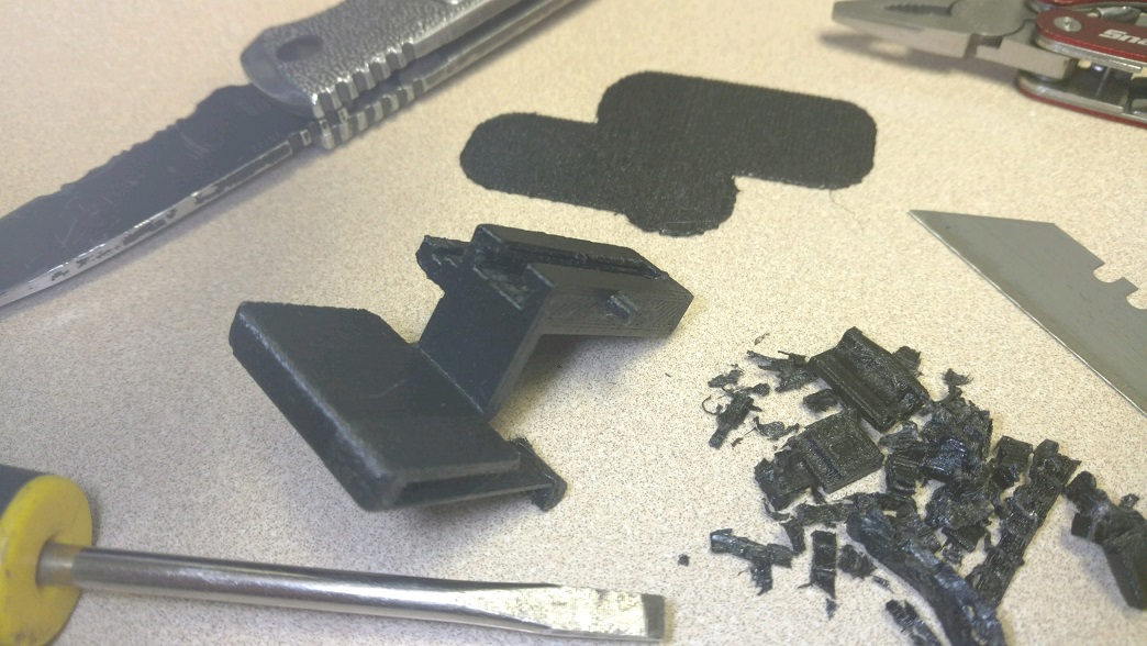

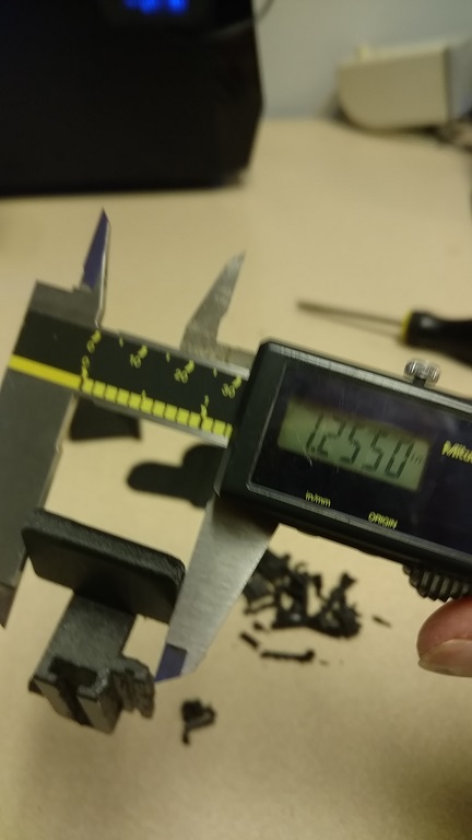

Ok, don't criticize me too much on part clean up, I was rushed some. I'd skip "roof" setting under support in Cura for PETG, this part. It works really good on PLA parts. Atomic Filament.

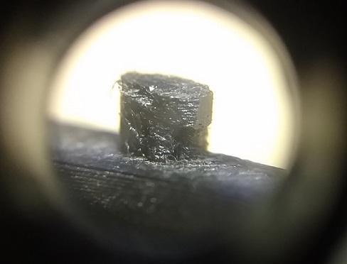

Here's an 8 pound (4kg) Eris hanging off the small nub feature of the AIWB part. Atomic carbon fiber black PETG. I think this is fairly impressive. The small nub feature close up. All the weight is hanging on this feature. Could be much better with smaller nozzle.
Cura screen shot The printed part on raft: Cleanup and a few dimensions:

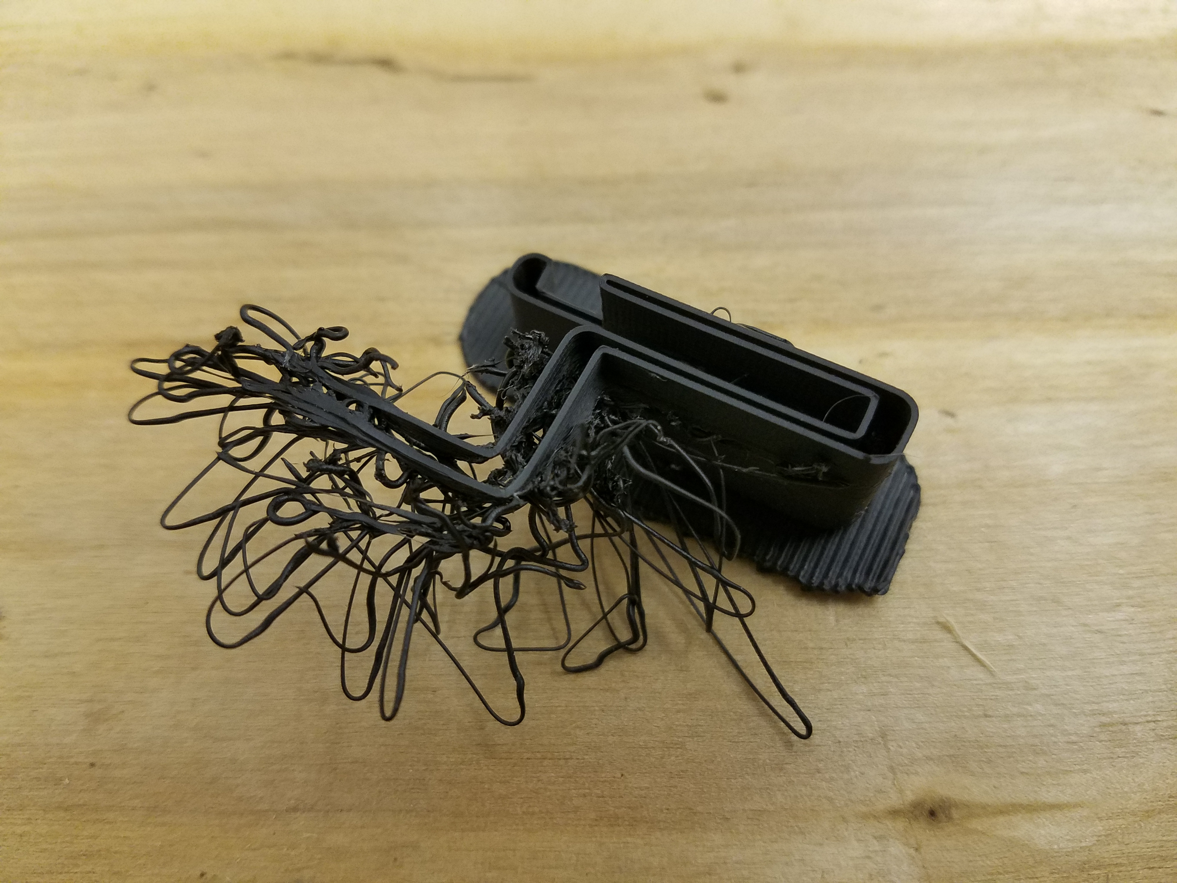

Hello PartDaddy - Sorry for the long delay. OBE (overcome by events) here last couple of weeks. I'm sure you know how it goes.
I finally got around to attempting a print of the part we've been discussing. I included a photo of the print I stopped midstream when I realized it wasn't going to pan out. Also included the .ini settings file for the print. Not only did it fail to print the support structure, but it also failed to make the print solid, although both we specified I thought.
Thanks for any insights and corrections.
John
John

I used straight up "SeeMeCNC" Cura profiles downloaded form our github.com/seemecnc for HE280. My guys perfected, with the exception of checking raft and support everywhere. See the Cura photo above, I highlighted these changes. Then your screen slice should look like mine.
Of course, different hotends, etc., will have different results. I'm just printing with our stock machine! No mods needed to hit the dimensions and quality your looking for (with the exception of our ball joint arms and molded cheapskates for a v2).
