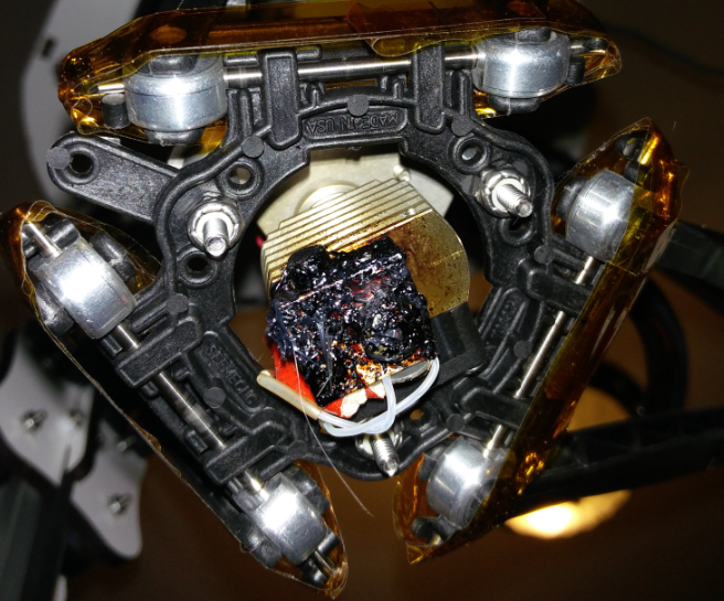

If the clips are installed properly, there's no way those pins can move. Could you post a pic of the clip installation?
tnx!
tnx!
Re: Rostock V2 Thermistor Negative Tempuratures
Here's a shot from the bottom up. I really don't want to take the Tape off for a better shot since it's working fine as is.
The clips snap in around the rod, so I can't see any other way they would go in...
For some reason it didn't load the picture. Let's try it again...
It looks like they're installed ok - but it's really hard to tell.
If they're sliding out of the u-joints, there may be some galling going on with the metal u-joint. I would /highly/ recommend you upgrade to the ball & socket arms and the injection molded carriages. It will greatly improve the performance of the machine over the original metal u-joint design.
