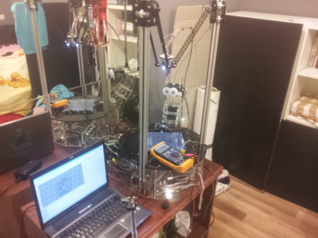

I have already assembled my machine, but I think it will be always work in progress.
Thanks to Geneb manual and videos on YT and all you guys here it was fairly simply task for me although it is my first 3d printer.
Here is my machine I will name it stage 1:

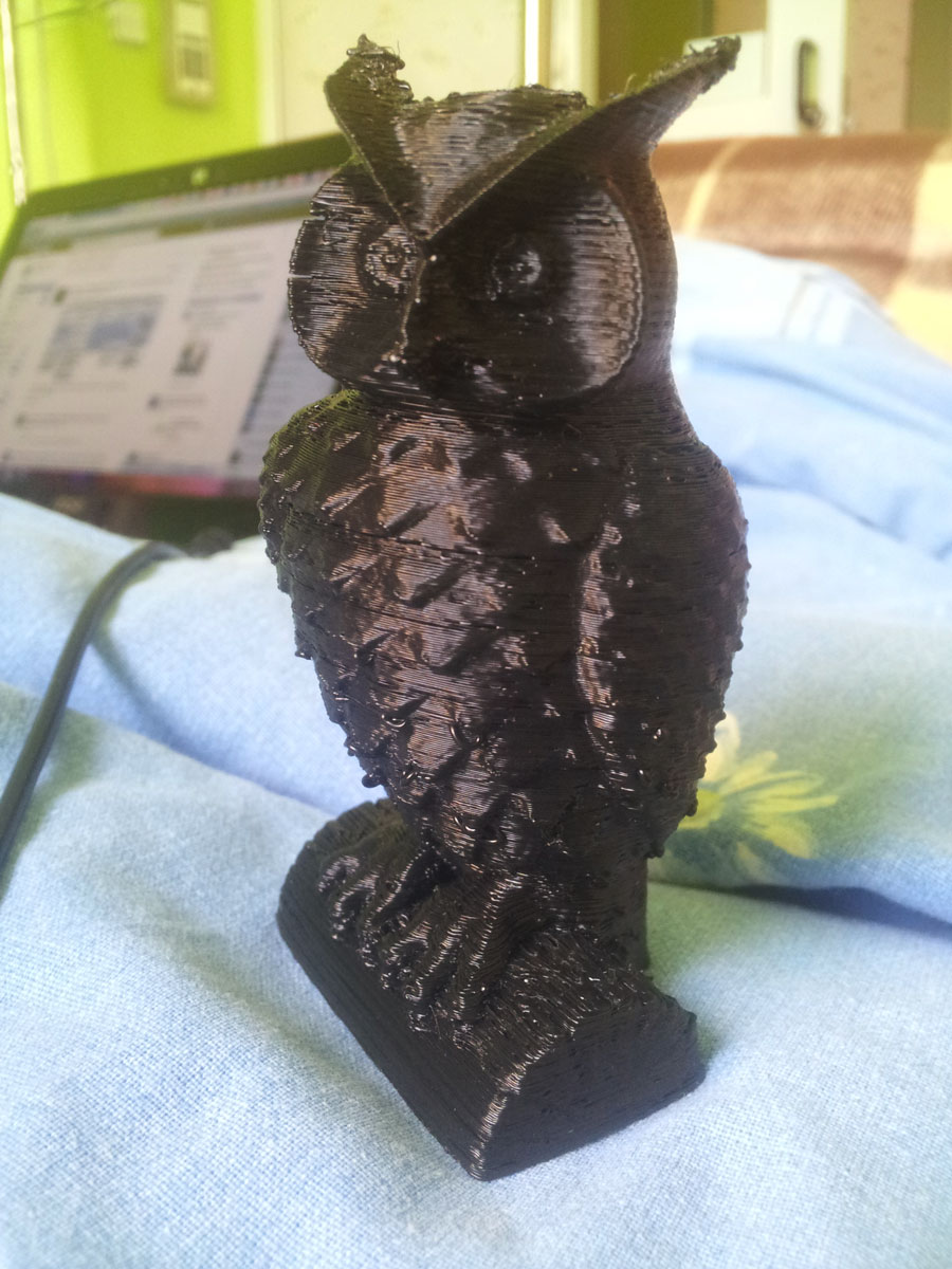

after printing a lot of calibration cubes and stuff i want to do something else, owl an bear. ( not calibrated extruder at all)
when I was bored of black color I changed filament to green, and all things goes a lot smoother (big difference i nozzle temp between them too I think at the same time i changed firmware to repetier):

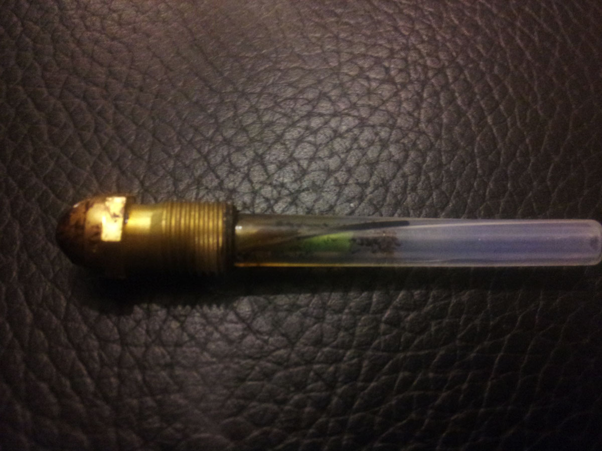

Lately i have some problems with nozzle so i dismantled it (I didn't check it since first assembly) and i find out something like this:
Tight now i have next to me 1m of 2x4 ptfe tubing and 1m of 4x6 ptfe tubing so I will replace them.
and now questions:
1. Is that normal that wider tube is cutted alk the way?
2.I have old nozzle, so what dimensions should have both tubes (length) and how shoul i cut them, maybe use pencil sharpener to make bevel on the end for better fit?
Please help, and sorry for my english ;)

Yes, the outer tube is slit up the side so the smaller tube can slide in easier.
I don't know about the length since I do not have the earlier nozzle. Hopefully someone else will chime in.
How hot are you printing? You might be going to high to get burning like that on the teflon tube.

There is no burnings, that is burned filament i assume, i think i don't have good seal between nozzle and bigger tube. From the bear print you can see separated layers, this means I'm printing to low? Is that correct?
I remember that when i started machine for first time and i started heating nozzle about 130C I saw a smoke coming out from the nozzle area, and it smoking like that for I don't know 15 minutes. Is that normal?
Since I dismantled nozzle I'm doing something like this right now. Post effects later. ;)

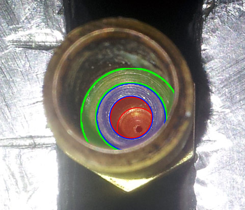

As I write earlier I have to dismantle the nozzle. And NOW I understand how it works. :D
I coloured photo for better explanation, Please correct me if I'm wrong
1. Green zone - here sits wider tube
2. Blue zone - here sits thinner tube.
3. Red zone - that is melting zone, is that correct? thinner tube is to wide to go there, is that right?
Now other end
Second thing I spotted. I assume it's VERY IMPORTANT how much you screw in your bowden tube M5 adapter, since thinner tube liner sits on it (like in the picture below), So if adapter is not screwed in properly the thinner tube can go up and down for example when you have a lot of retracts. This can unseal the linner on the bottom.
Now I can cut some tubing, In orginal delivered to me the inside tube was about 1mm longer ( for better seal I assume because nozzle is a cone inside).
What do you think about beveling inside tube for better seal for example with pencil sharpener? Good idea?
