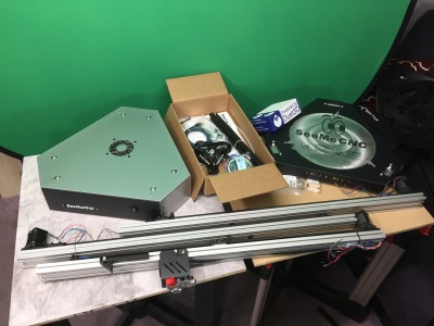

This is quite the beast of a box.
They should consider better sealing of the box... the tape, as you can see, gave way. So some packing bands around the box would help secure the contents and also give something to grab.
I will assemble tonight and post photos of the assembly ASAP.

It appears that all the parts arrived safe and sound.

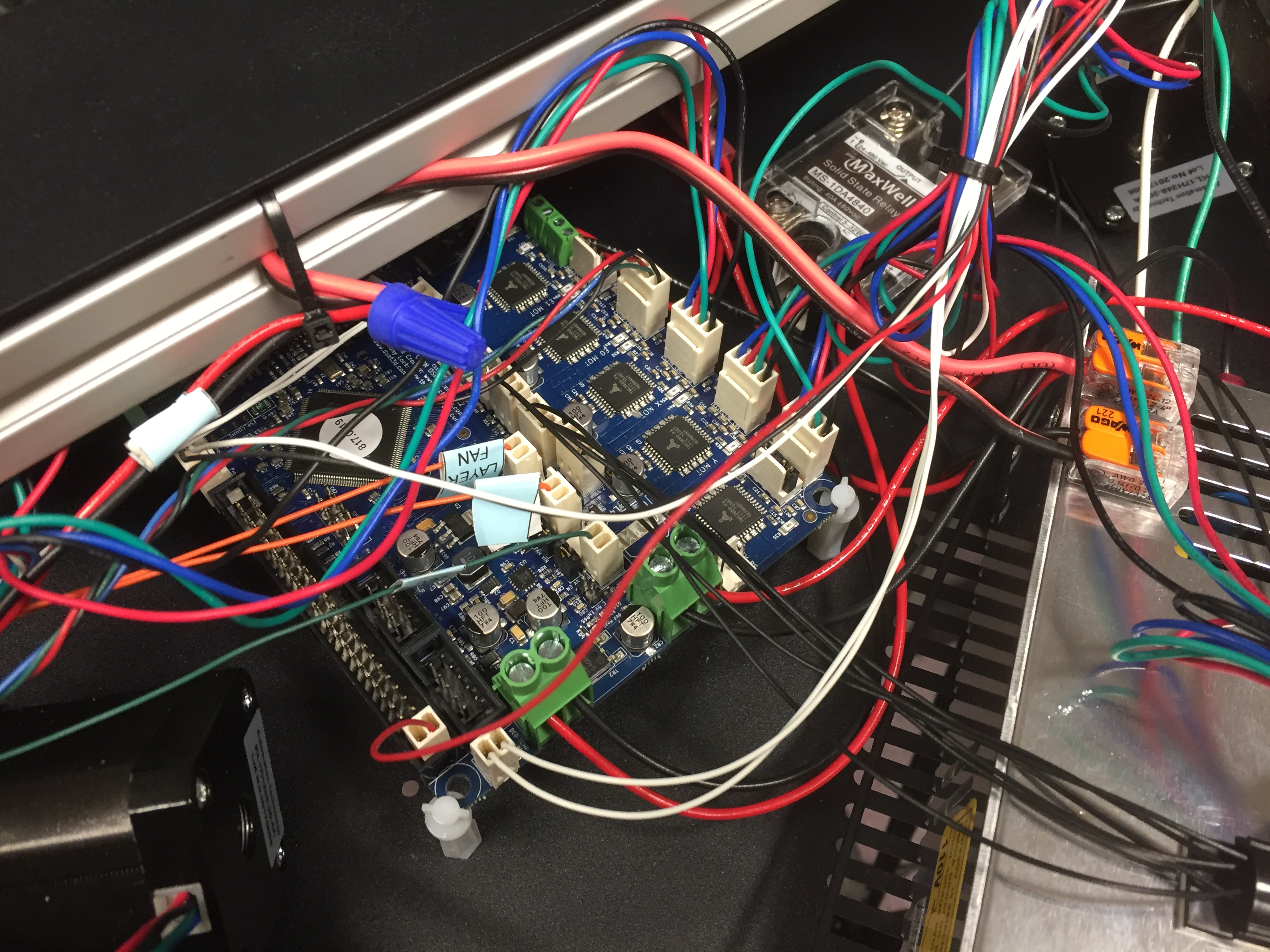

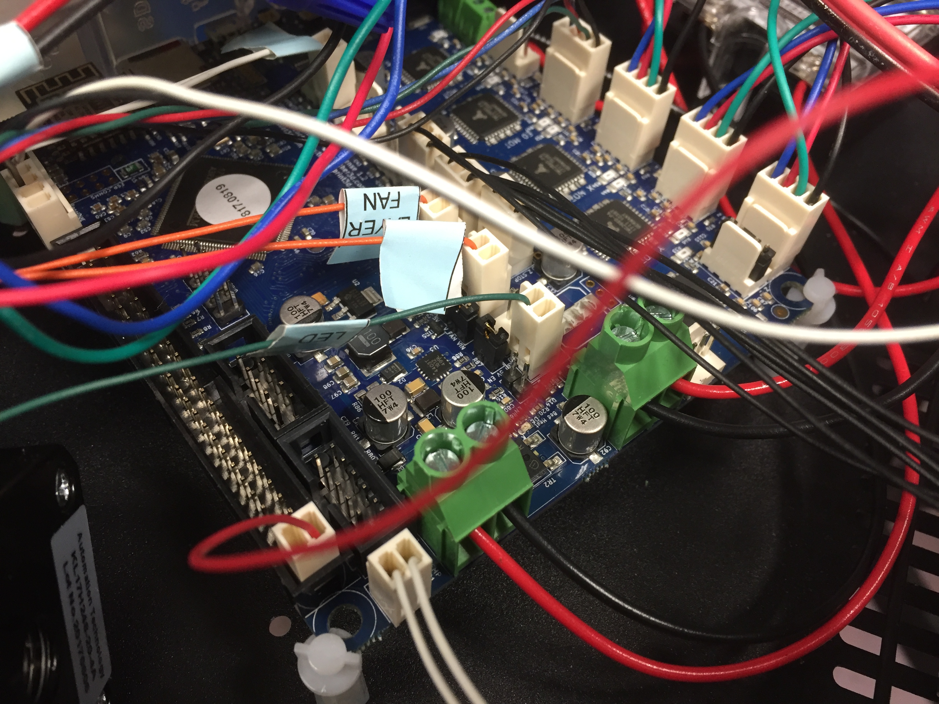

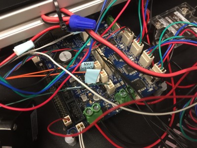

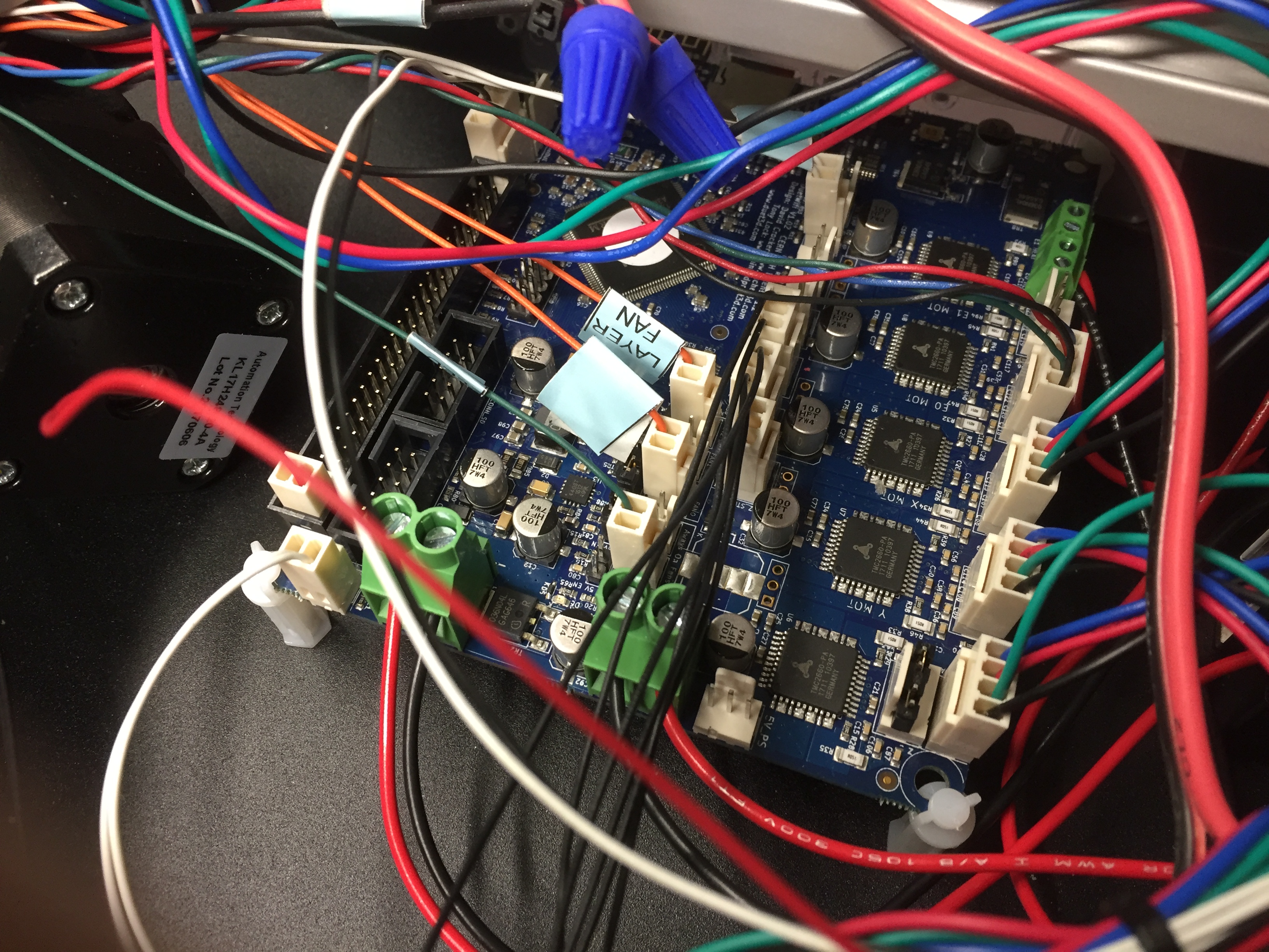

A few shots of my board, perhaps someone can spot a problem with the wiring and suggest a fix or something to try.

Blocked hot end perhaps? Or incorrect temperature calibration, so that the hot end is not as hot as you think it is?
Does the Artemis use a Bowden tube; if so, can you remove it and check that you can drive filament through the extruder drive by itself?

From what you are saying, the X motor works when plugged into the extruder connector, but the extruder motor still doesn't work when plugged into the X motor connector. That points to a problem with the extruder motor, or its wiring, or its mechanical connection with the rest of the extruder.
Re: The Artemis arrives in NJ
Well, it looks like it is a bad stepper motor. Let's see if a replacement fixes the issue.

IT’S ALIVE! ... and printing it’s first Benchy...
... but not without some fussing. Permit me to continue the story of the fluttering extruder...
Due to some testing, the team at SeeMeCNC decided that the extruder stepper was bad... a first! Because of the holiday weekend, last night I opted to order a stepper from Amazon, for next day delivery. It was delivered to my home at 9 am. Sweet...
So before taking my existing stepper/EZRStruder apart, I put a plug onto the end of the new stepper’s wires, connected it to the Duet, brought up the hot end temp, and low and behold, the motor turned as expected... no fluttering...
I then cut the wires from the original stepper, and soldered the new stepper wires onto the 4 wires in the tower... neat installation, I even color coded the heat shrink tubing. (I had lots of wire and supplies left over from converting my Rostock Max v2 to dual the extrusion earlier this year)...
Then it was time to test the new stepper again before dismantling the original stepper....
And, and, and... it fluttered!
So the issue was clearly the wiring that ran through the X tower extending the stepper wires. So I went into my wire stash, got out some colored 18g solid wire, and replaced the original wire extensions with my own. Reattached any of the whip connectors that pulled off of the board, and Viola!
As I type this, the Artemis is happily printing its first 3D Benchy test print. It’s a PLEASURE to watch this machine in action... so smooth and quiet.
One thing we noticed yesterday was the extruder extension wires are a thinner gauge than all of the other extruder wires...I wonder if this caused the issue, and if everyone else has thin wires going into the KK connector at E0.

Wow. Off the top of my head I can't imagine what in the wiring would make it run fine at high speed but screw up at low speed. Bad solder joint with a higher than normal resistance? Either way, I'm glad you're up and running! Sorry that you had a rocky road to get there. We'll be in touch when we're back in the office.
